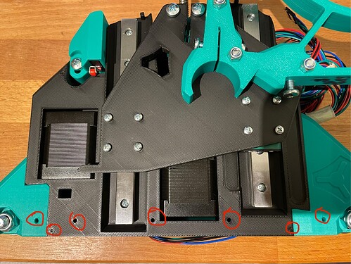

What purpose do the indents an holes have on the inside of the YZ Plates?
You could add a dust skirt or other fancy stuff. It‘s just there for potential future upgrades. :slight_smile:
Vaguely recall some of the indents are there for measuring and helping verify the prints are good. Just skimmed through YZ docs at LowRider CNC V4 - V1 Engineering Documentation but I couldn’t see any reference to these :man_shrugging: Guessing images with expected distances/dimensions will turn up at some point.
No, those markings are at the top of the side plates. :sweat_smile:
That’s what i thought they are for. Makes sense.

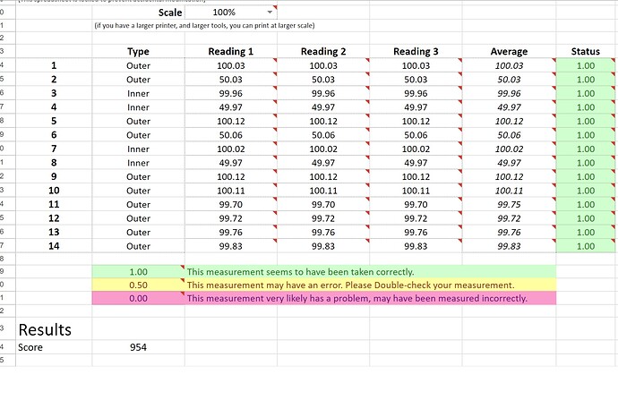

Hi everyone, I have a Ender V3 SE that i’m trying to get ready before printing the parts. Have printed several of these now and tweaked the printers firmware but not getting much past 950ish. Is this ok to print with?
When you need a new lowrider core in the next two hours.
(Actual time is 8 hours.)

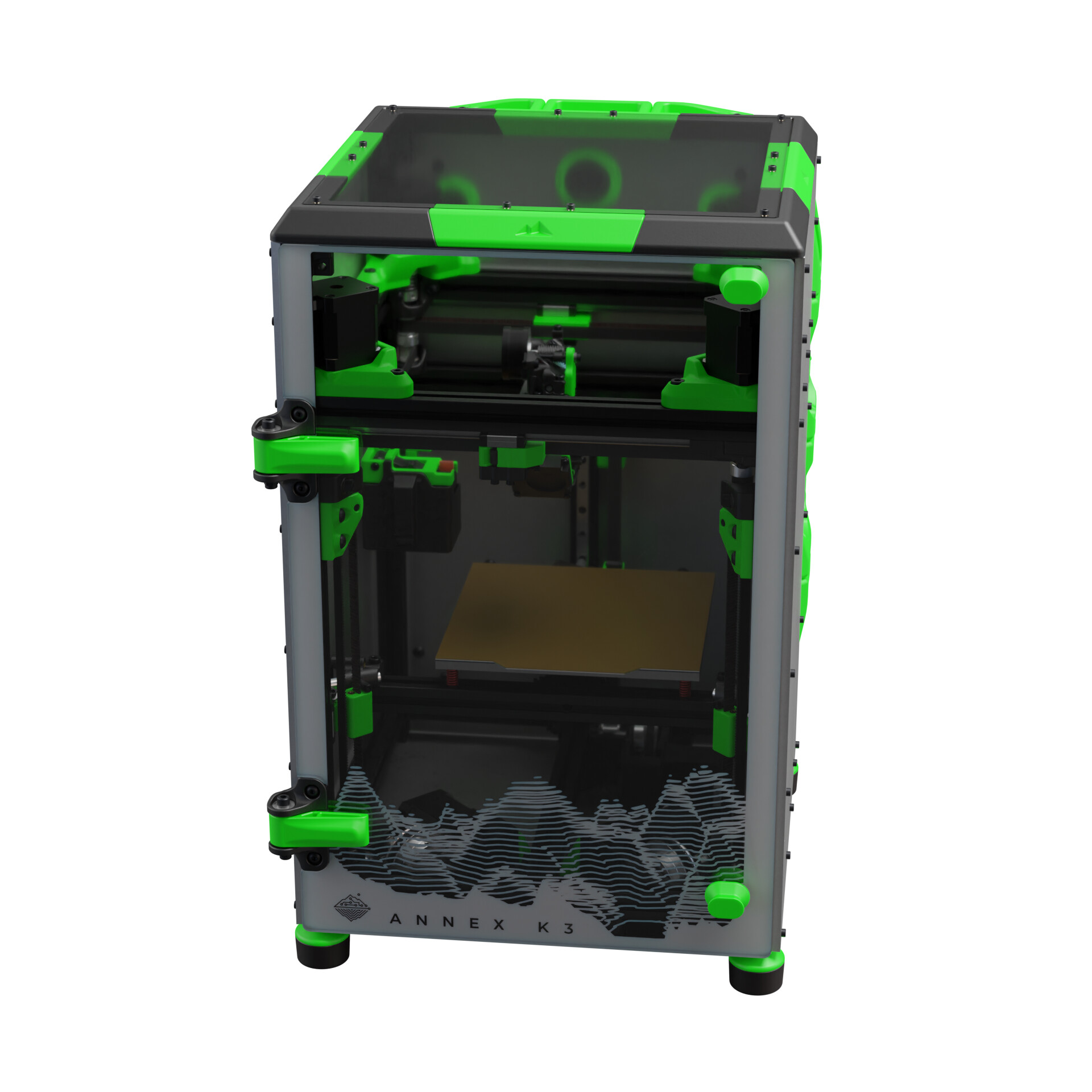

Your printer setup is configured like the mpcnc.
Yep its a crossed gantry printer. Annex engineering k3.
Its a little hard to go fast with pla because its harder to cool it quick enough due to the enclosed and insulated/heated chamber.
Those are for emergency situations. I can use them to quickly QC my printers, and if someone has a router with a 10 degree tilt we can invoke the hidden test points. They are not as accurate as a actual test print but they will work in a pinch.

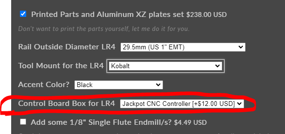

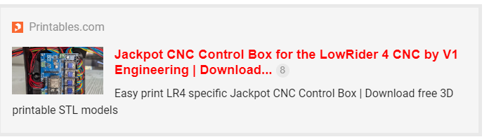

is this the same Jackpot Control Box offered as an option on the purchase page?
It is just the 3d printed case. The Jackpot board is sold seperatly
Understand. when I elected to get the board, the box was an option, just wanted to know if it was the same box. thanks
