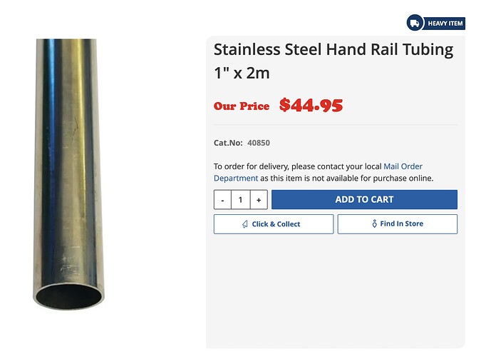

From a quick internet search 1" OD is by far the most consistent size to source across a broad range of retailers. The three images above are from major national chains.
A marine shop SS tube @ $22.00 per metre (2m lengths)
Our only “Lowes” style big box hardware store(Bunnings) Gal Tube @ $7.50 per metre but in 3m lengths
Primed steel pipe @ $10.00 per metre.
Note I bought my polished SS tube from a balustrade supplier for close to the cost of the primed pipe, cut to size so no waste, only paying for what I needed. They also ship nationally.
