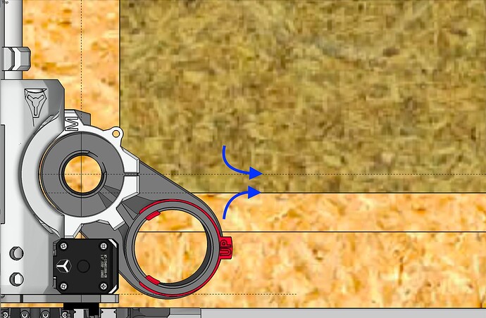

Well, I don’t exactly remember making a post like that, but remembering is tricky. I can say that, because the LR4 is a bit more compact and better (more efficient on protecting cuttable area) for my full-size LR3 that’s being upgraded to LR4 even as we speak, my current working plan is to get the non-rail side’s YZ plate to ride “centered” dead over the metal strut on that side, which represents moving it from where it used to ride on the very edge, nearly off the strut, and based on my calculations, it means I can maintain the same cuttable area, while cutting my new steel tubes at 1398.06mm (55.04").
For comparison regarding the above, my LR3 steel tubes were cut at 1,435mm. Again, new ones are being cut at 1398mm.
This is based on me constructing a virtual model of the LR4 based on my existing table’s width and layout, and using the STLs to populate the model.
PS: the plan involves some printed “table extenders” that will need to be tested, which will insert into the ends of the metal struts.
Note: the plan I referred to above, actually loses a bit of cut area on the X-min side, but gains some on the X-max side, and I would need to move my spoil board toward the X-max side by about 14.3 mm to keep as much cuttable area as I have now, accessible in the new.
Trying to keep the non-rail side’s YZ plate riding on the edge like now, would technically be doable, and would mean I gain new usable area, but it would also extend the printed “table extenders” on that side, and the further they stick out, the more risk there is of issues of flex and creep.
For the new LR4 calculator, I’m targeting cuttable area of 1231.9 mm (48.5") and it says the strut for that should be 1398 mm, which seems to correspond fairly well to the 1398.06mm I indicated above.
If the cuttable area is calculating from a “point” at the center of the bit, then you get to add the tool diameter on, half of that (radius) on the X-min side and half at the X-max side. If I am using a 1/4" bit, I could cut 48.75". For surfacing a spoil board, if using a .75" bit, I could cover 49.25" – which, if centered correctly, is more than enough for a 49" sheet of MDF.

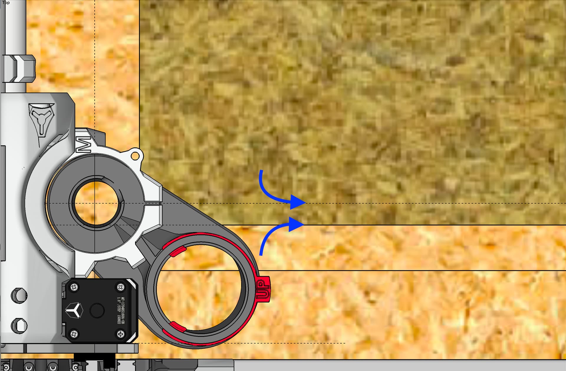

Care to post a screenshot?

In this screen shot, some aspects of the working model are not yet realistic, and don’t need to be since I know what’s up. For instance, the old table is shown, which was made before the torsion box. It does show the metal struts, and the width of the old table matches the width of the new. The old table had metal struts attached at the same width apart as on the new torsion box table.
This is showing the non rail side. If my model is not too far off, the blue arrows indicate the current edge of my spoil board, as well as a guideline about 14.3 mm away from it, which is where I’d need to move the edge of the spoil board to, to maintain and center my cuttable area.

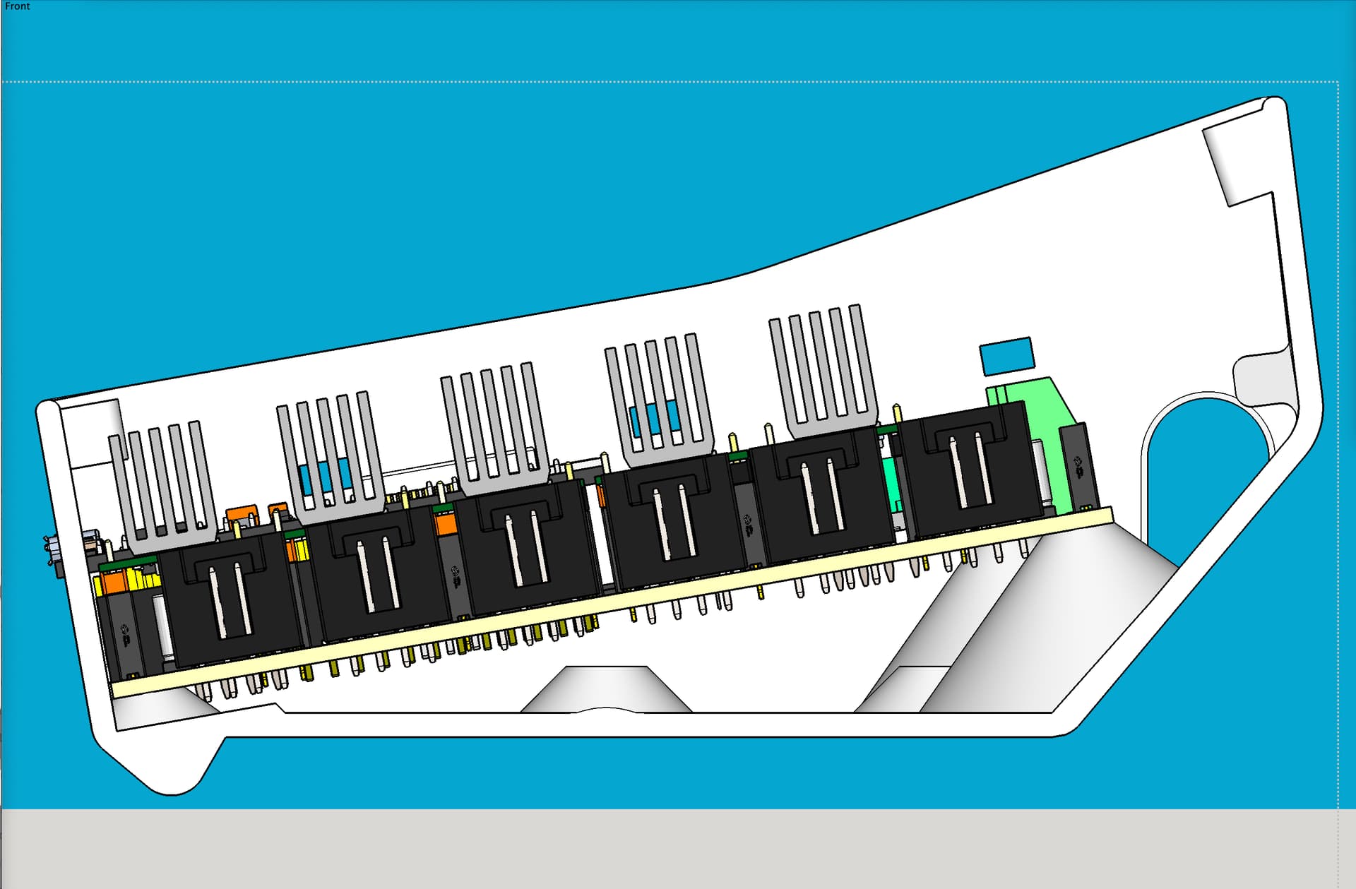

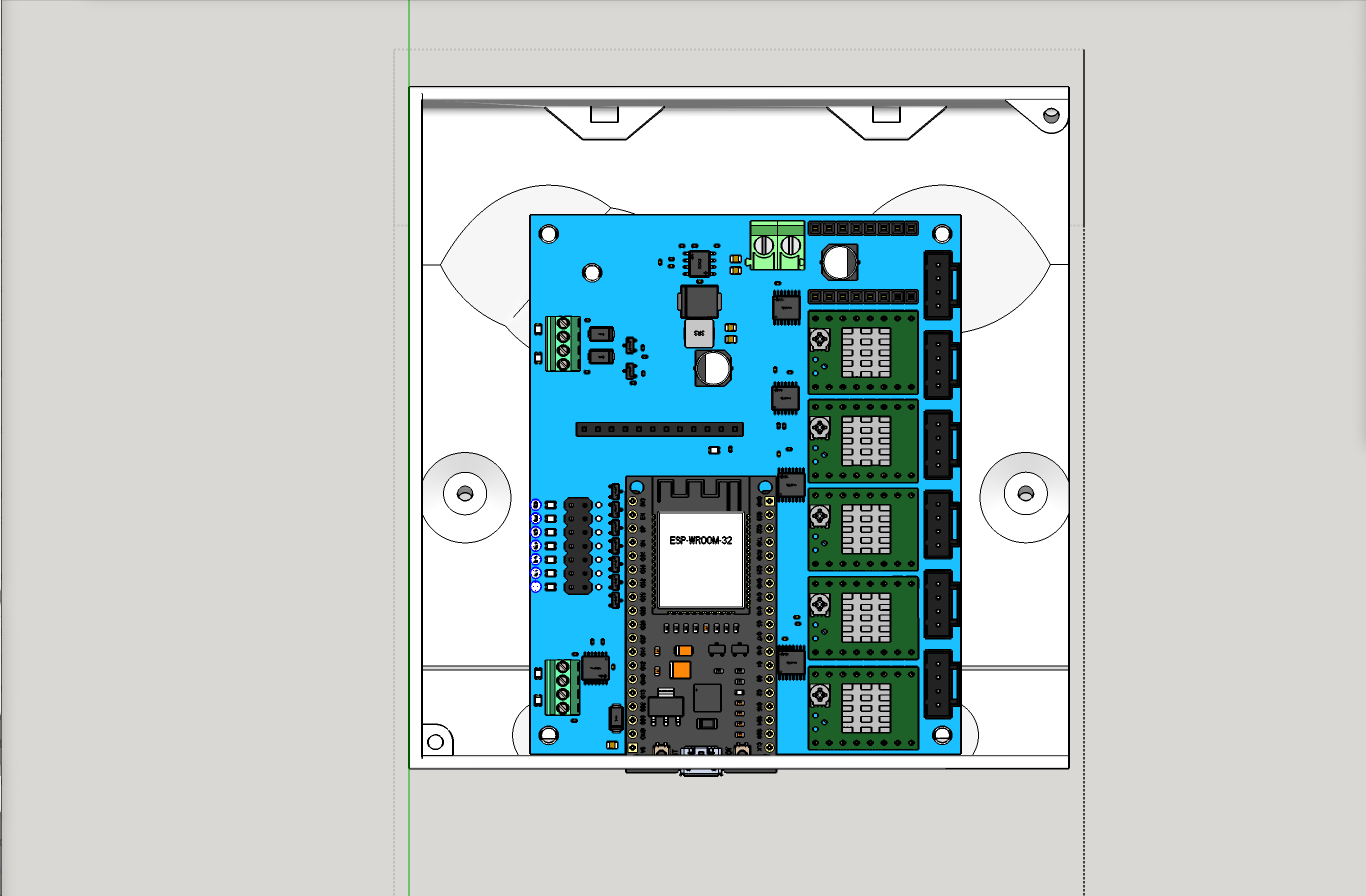

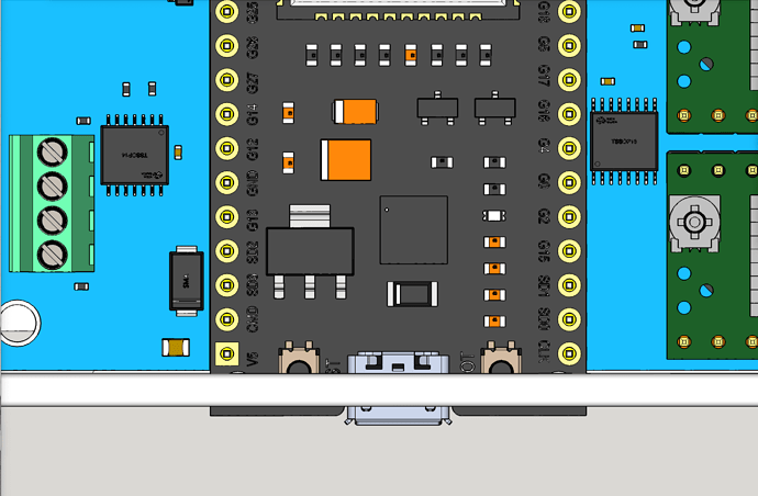

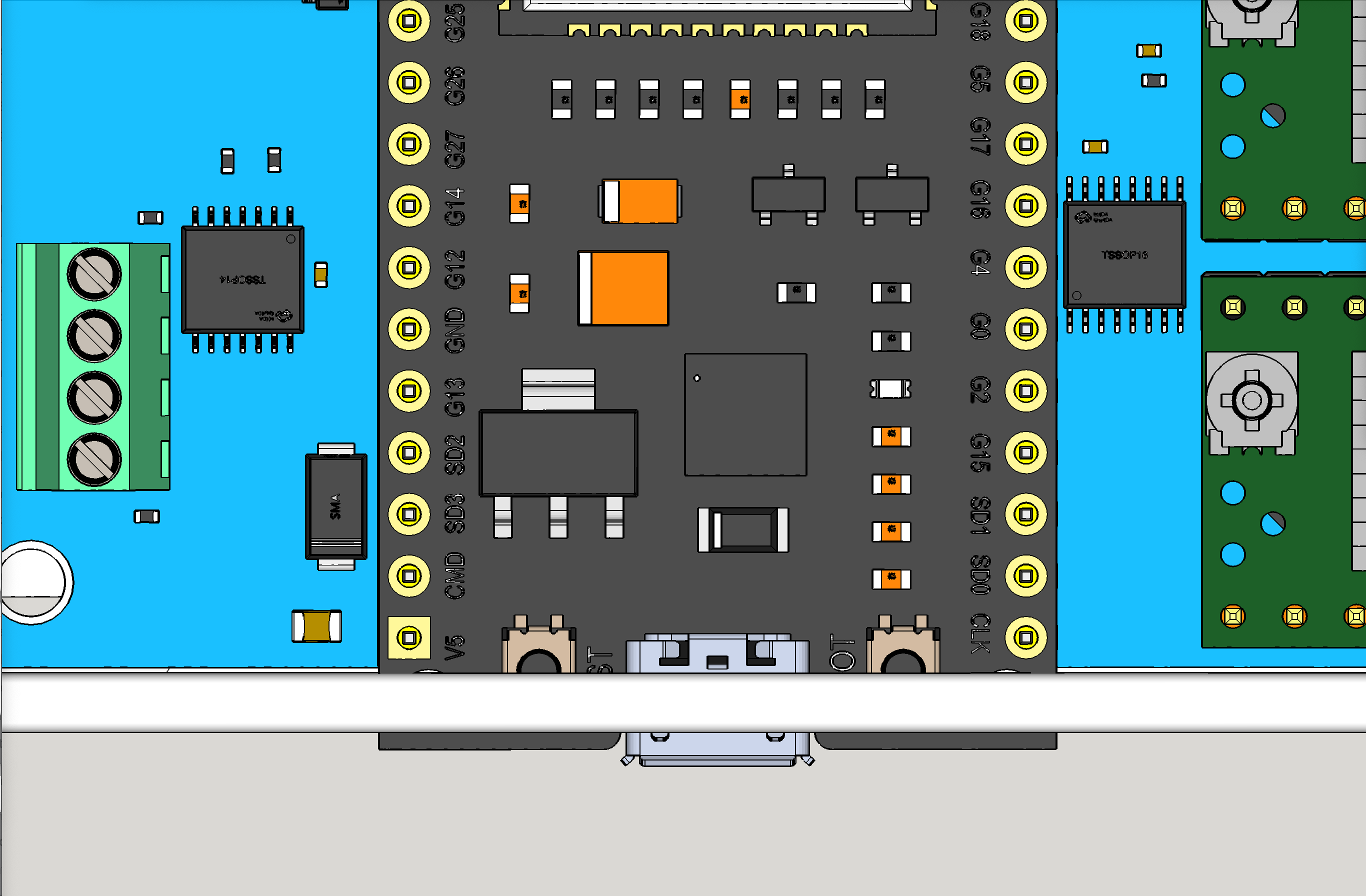

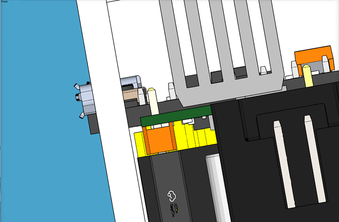

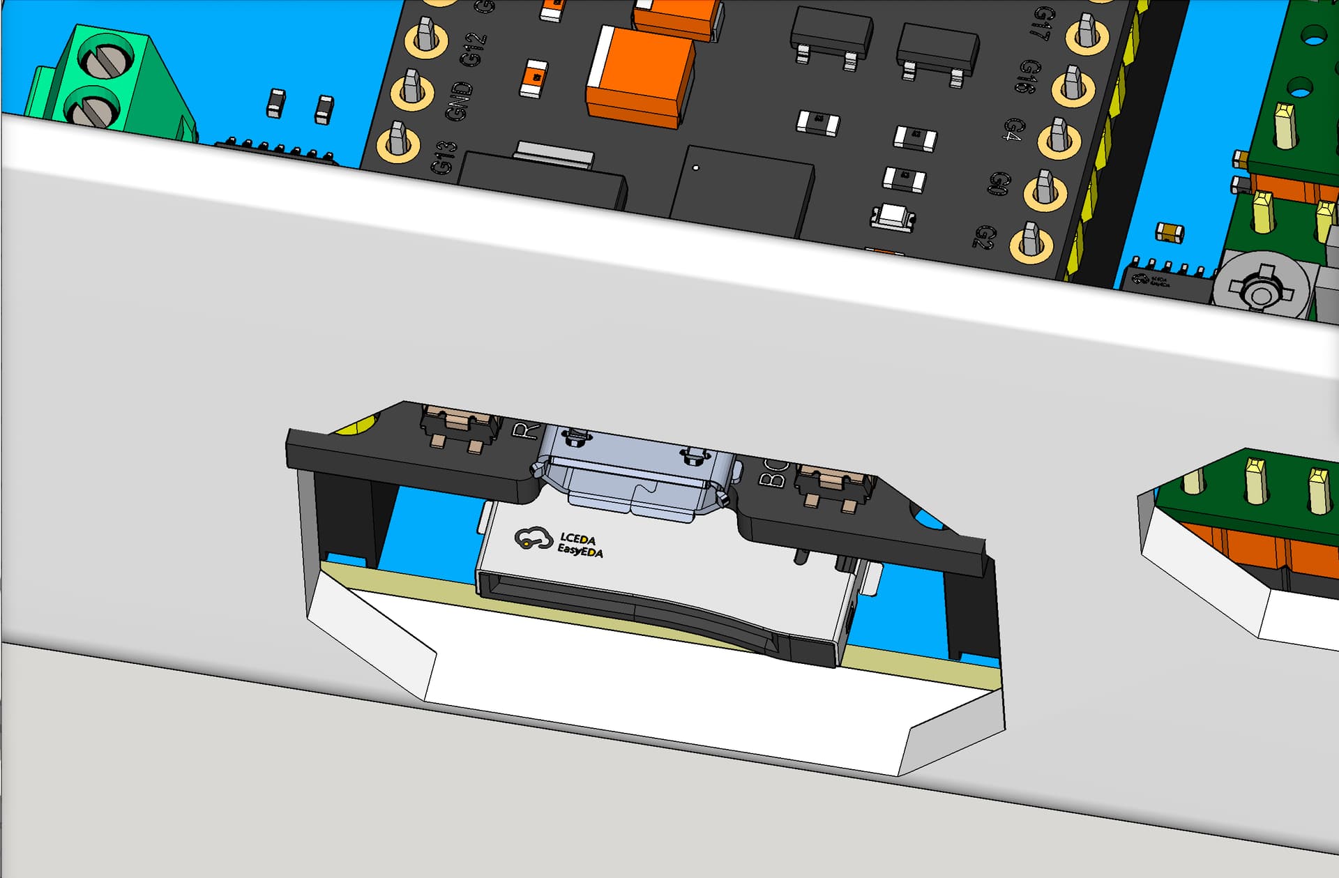

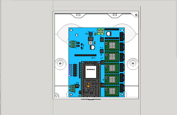

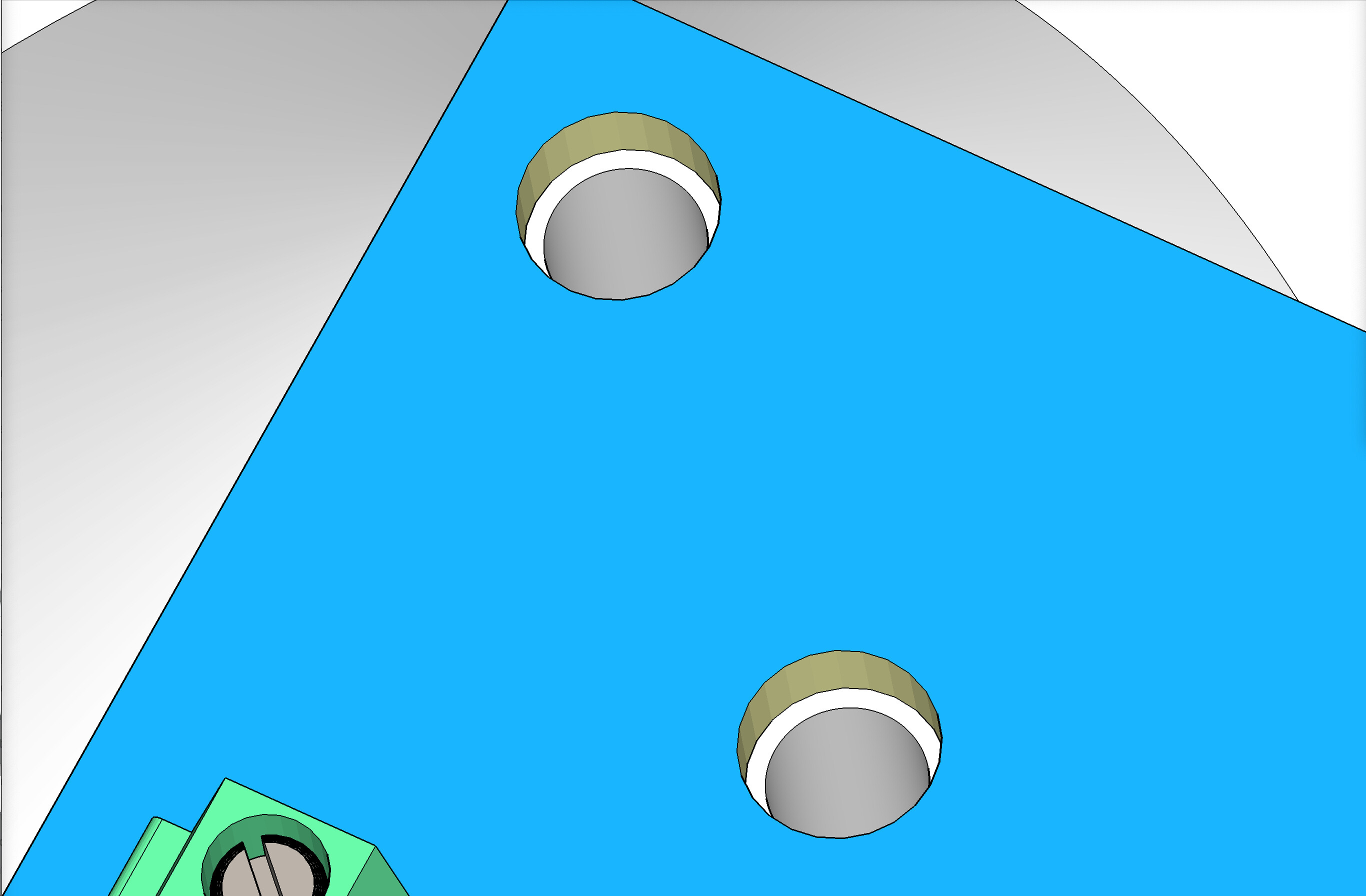

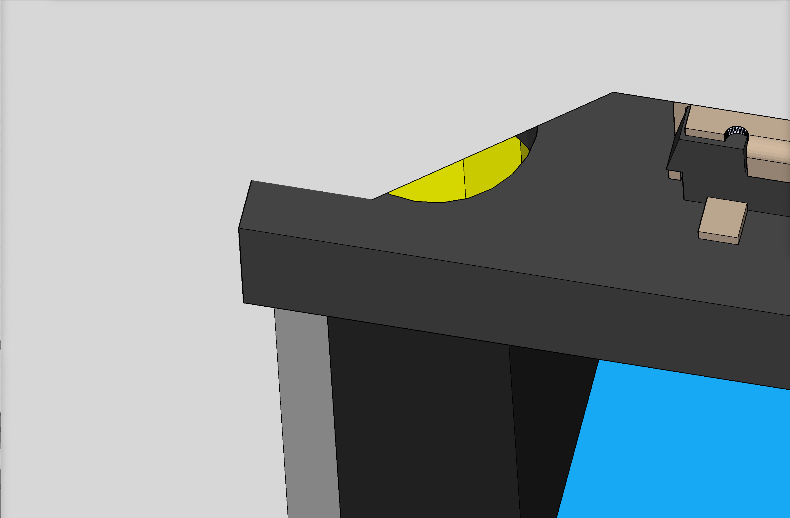

@vicious1 Quick question on Jackpot case (V2). I imported the mesh to have for possible tweaks, and I added your Jackpot board model. I lined it up, and it shows a bit of a collision where the USB port is. Is the model right?
I am using his box right now and I don’t have any collision with the esp32
OK wont worry then.
