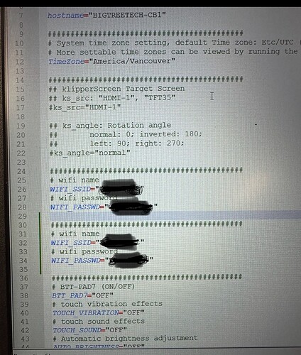

I also tried to add another ssid to the main config file via sd card into my laptop but it still wouldn’t connect at my work network.
I then tried to replace my home wifi in the file to have the work wifi passwords etc and the only thing I can see happening is my tft is just running though some wild startup sequence and it’s a continuous loop lol.
I might try and duplicate what I had working on a sd card and have one for work and one for home. That seems clumsy tho

It’s just odd to me like when I initially set this up I enter that country code and password and ssid.
Bit that was when I was setting it up as in notepad++ and I entered it into the system.cfg.
And it was able to connect.
So now I need to go in with putty and go in via ssh and sudo edit it in the putty command prombt Linex ?
I am assuming when I initially set it up it wrote something that now I will need to alter and sudo edit so it kind of edits that original file ?
As in why my changing of the system.cfg via sd card changes did not write ?

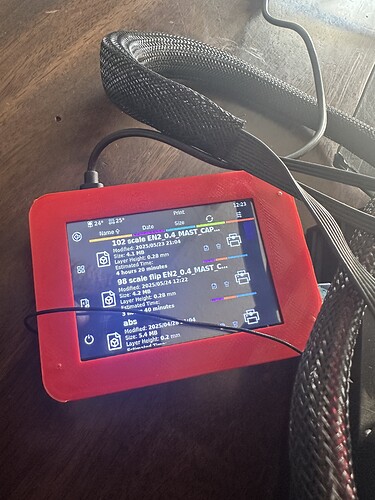

Well I finally figured out the screen.
First things I noticed are.
Raspberry pi small board computer is totally different that a BIQU BTT pi.
The file structure and names are different.
So if you have someone your referencing you have to have the same board.
For example ex
The armbianEnv.txt is for the BTT pi
And there is a couple more differences.
Also specific to the wifi setup it different than a raspberry pi.
I had to do the similar thing you would have to on either but it was in a different file.
Also after installing klipper and updating don’t trust that it’s actually updated.
Go in and out a couple times and well for me I saw that some needed further updating.
After I updated them the screen now works and I can use it again not on wifi.
Although now I have to figure out how to put files onto the BTT pi with out wifi.
I tried dumping gcode files into the gcode folder in the BTT pi but it didn’t work.
