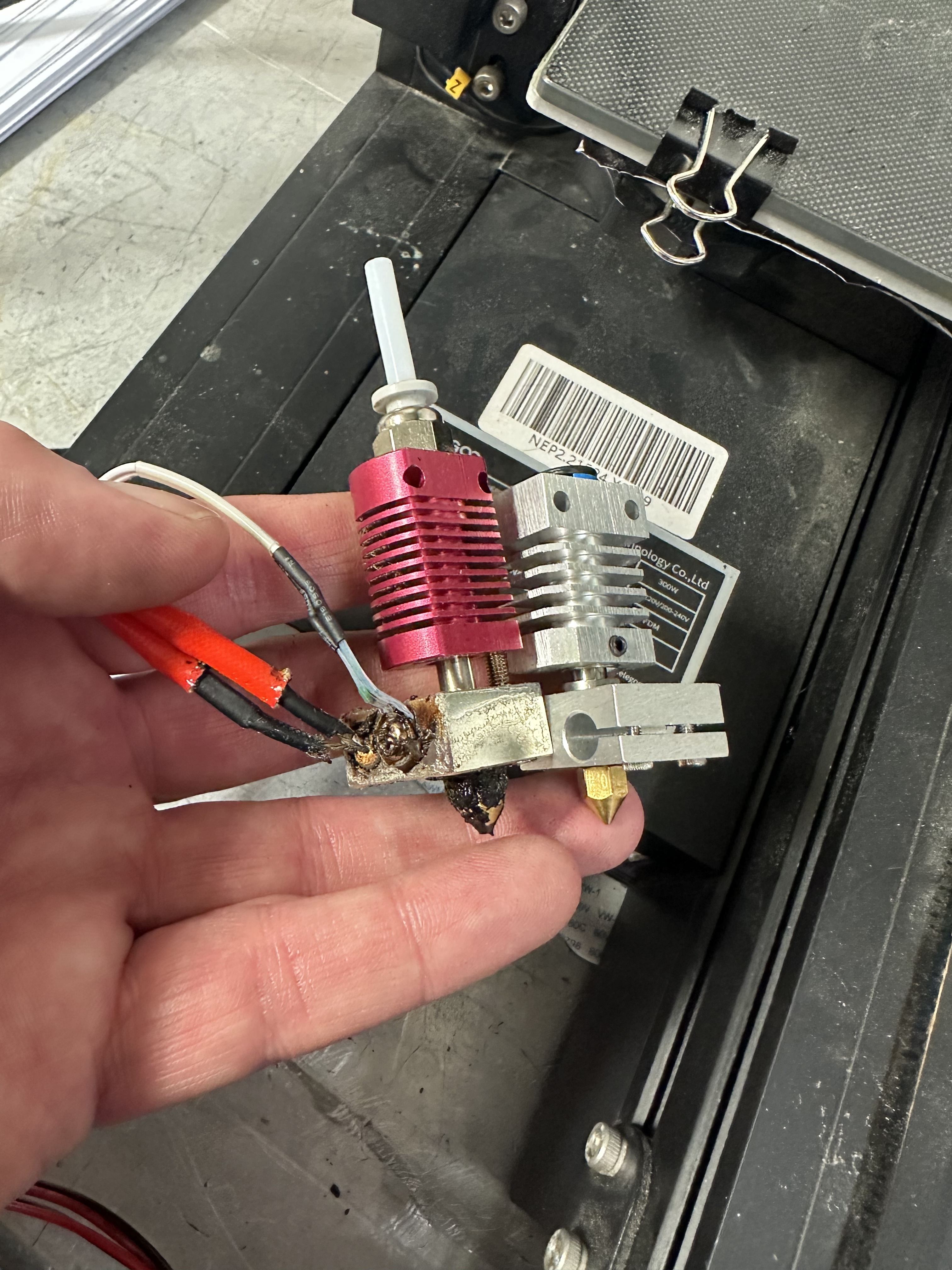

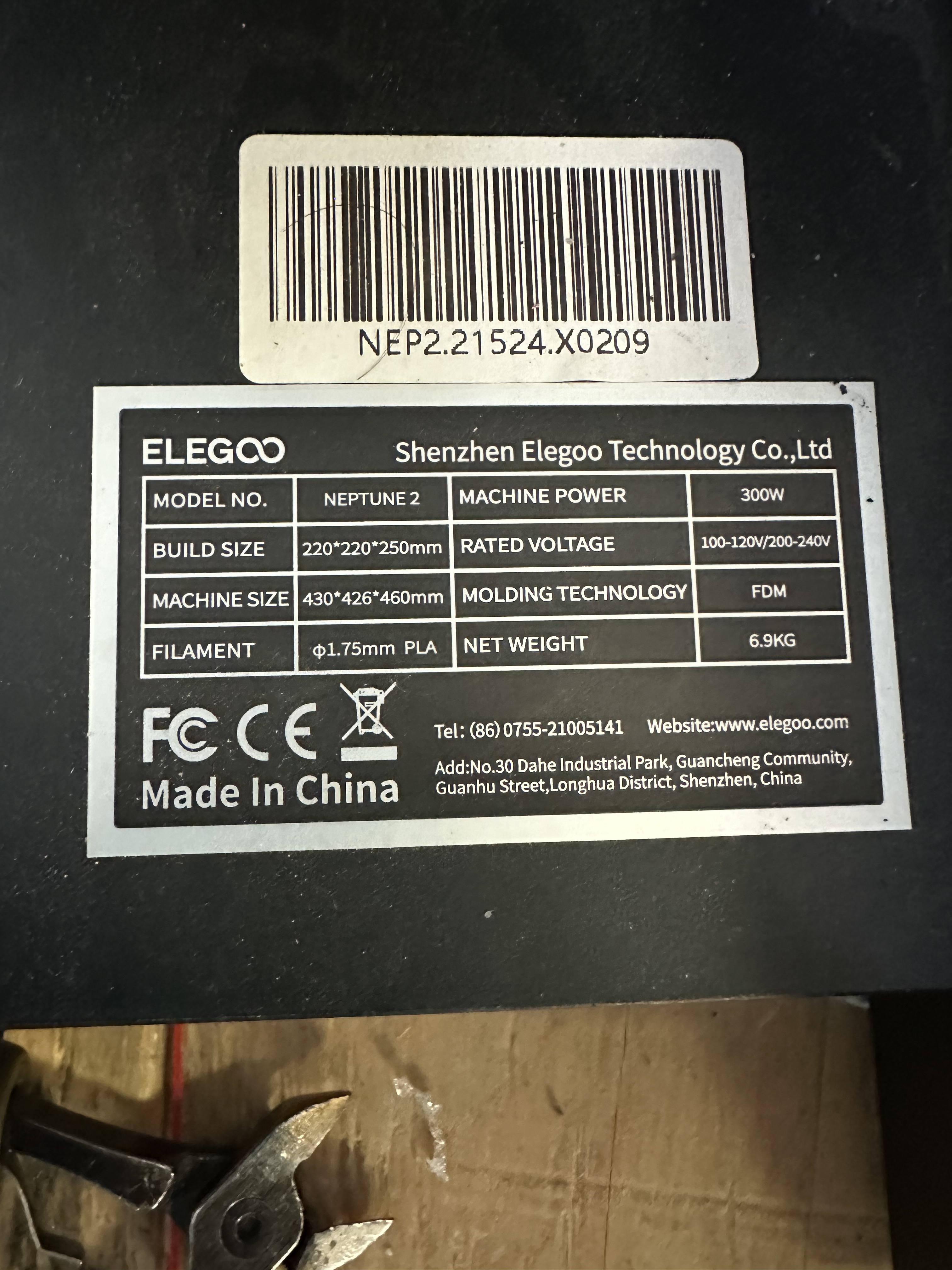

Well my old elegoo Neptune 2 gave me a err5 code.
The hot ended needed some love and I thought why not give the whole printer a little refresh.
The goal is to install klipper, I have very little experience with such things but thankfully there is some great ppl online that share their efforts.
The Neptune 2 is similar to a ender 2 iirc they are almost like a clone.
One difference I have seen is mine uses a touch screen the other uses a knob.

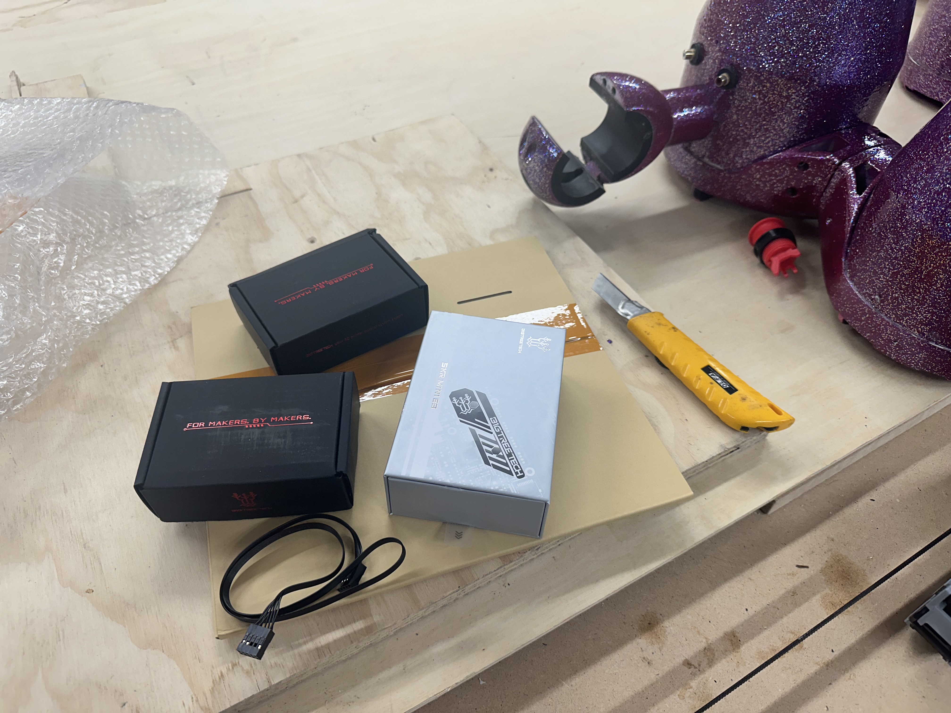

Parts I have purchased are as follows
BIGTREETECH skr mini e3 v3.0
BIGTREETECH btt pi v1.2.1
Ender 3 lcd 12864
Mk8 all metal hot end.
I already had a direct drive extruder.
I really hope I can get this all figured out. I ordered the lcd screen in the hopes of there was a firmware that is already built for me to start with.

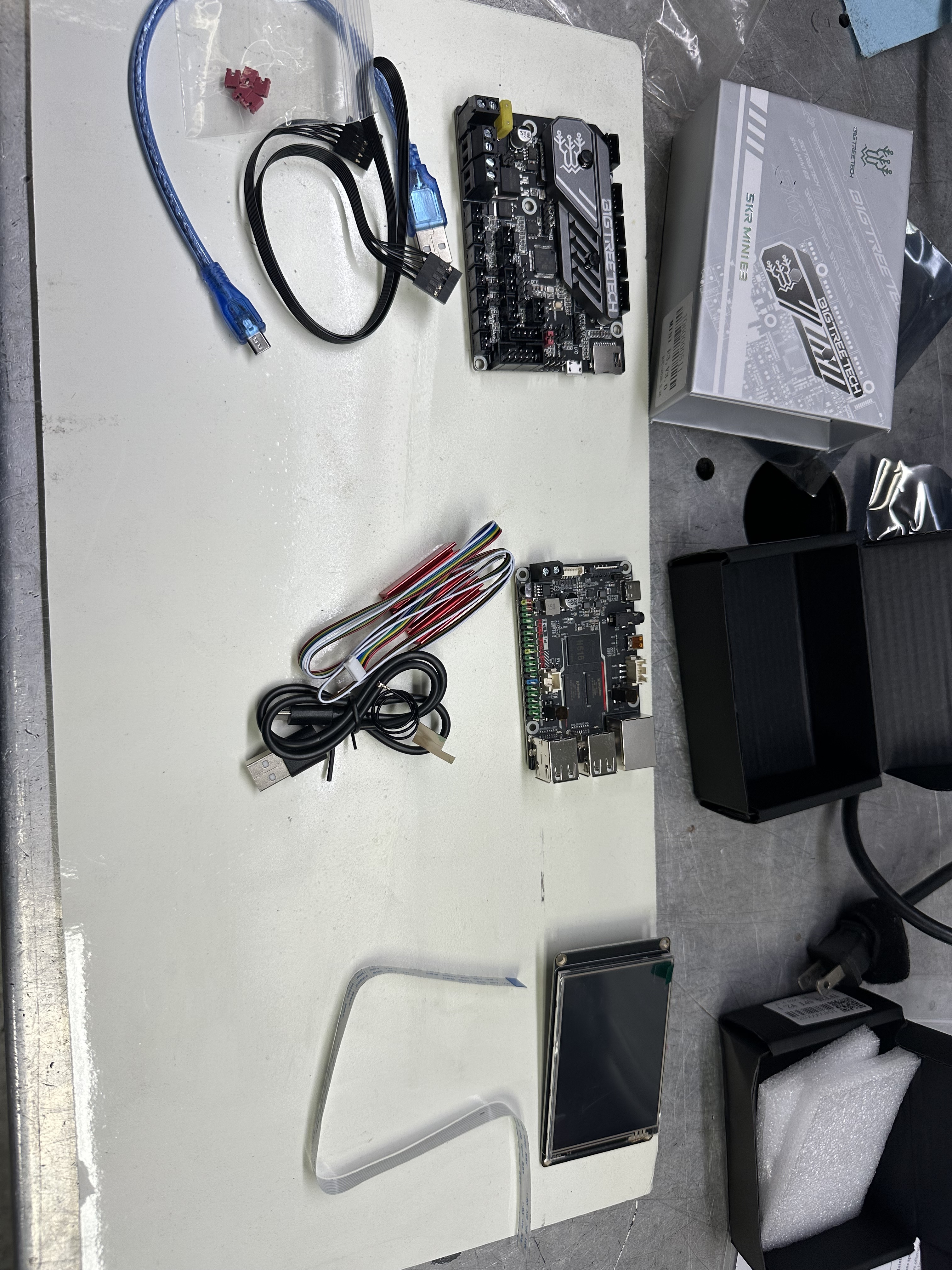

Well my parts have finally arrived hopefully by the end of the day I have some kind of movement.
I guess the skr came with a screen so that’s awesome even tho I bought the ender screen already I am sure I will use it on some other project.

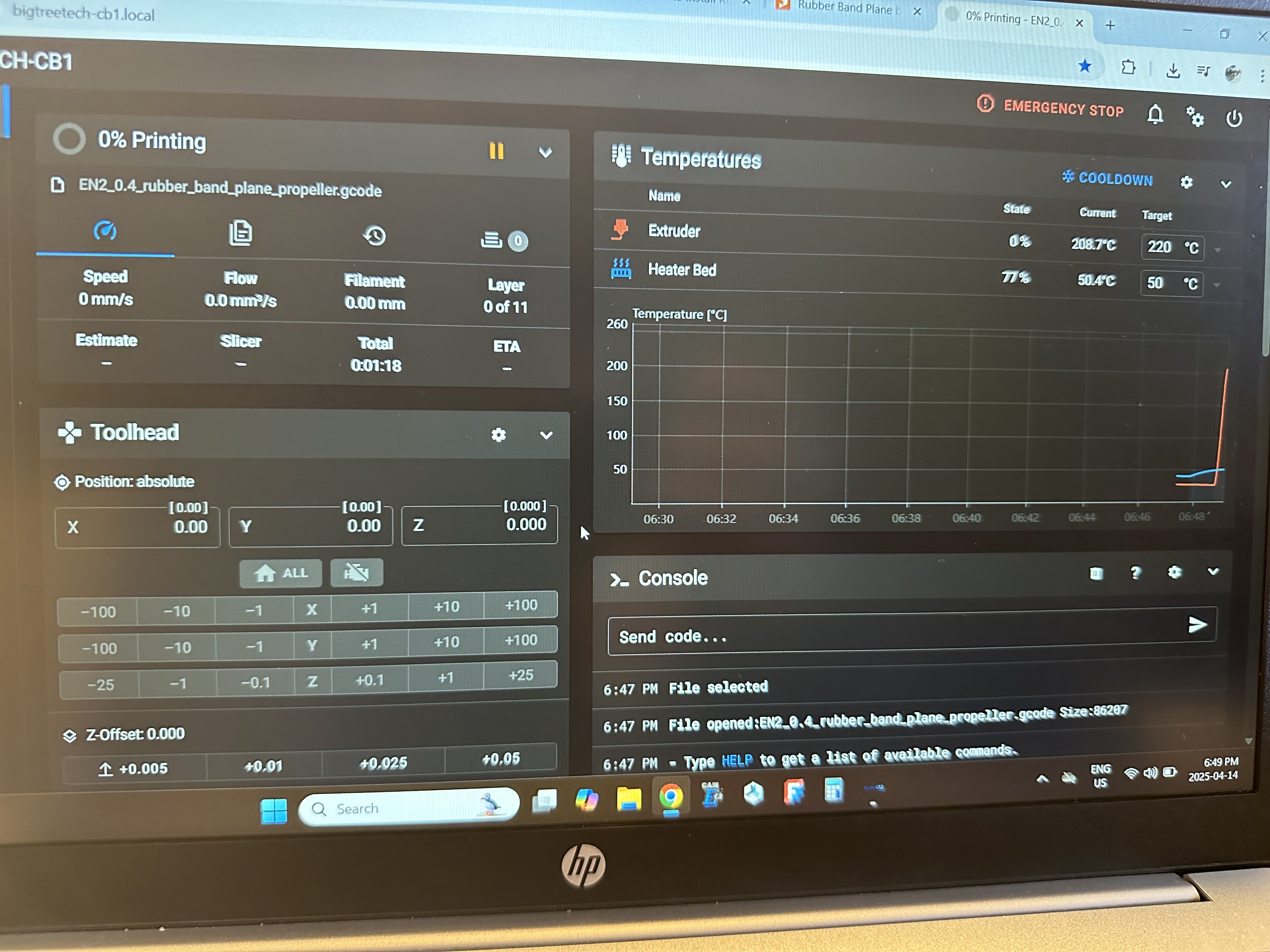

Well I have extruder heat and feedback and bed heat. Also movement, although my z is backwards but ran out of time messing with it.
Oh and I did manage to upload a file the video tutorial was so helpful.
Thats a simple as adding a ! to the beginning of the pin name for the direction pin for Z in your printer.cfg

Yes… regarding the firmware changes, all you need to do is change the printer.cfg in the machine menu. If you click the blue thing in the upper left of your screen, a menu on the left side should appear. once you get to that machine configuration screen there is a list of files and one of them is printer.cfg. click to open and edit. then save and restart from that web page when done. There are template files for bltouch functionality you can add to get that to work. I can share what I use if you like, but my bltouch acts like the z homing sensor and you may or may not want that depending on your system setup.
Thanks for the info
I was planning on just using the zendstop.
I did as you said and managed to get the z pin working and the touch stuff hashtagged out for now. Just testing a benchi now.

Yes it appears odd like to use the tft35spi I have to have the small ribbon cable and a large one.
I thought adding a screen would be easy lol
