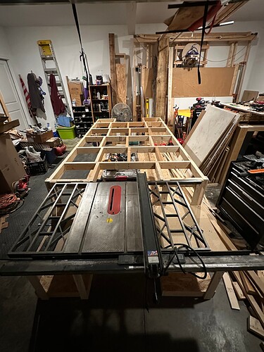

So while I am procrastinating on the Maslow, I decided to research new table saws. I currently have an old Craftsman 113 with the full cast iron top and cast iron wings. I paid $150 (USD) to get it and had to refinish the top due to sitting and having surface rust a few years ago, and I really like it. I was trying to see if there was another saw that I could just swap the top out on it, but in my research, I couldn’t find that answer, as well as was looking at $1200+ for the replacement in what I wanted in a saw. Yesterday, though, I had a weird epiphany to just google the 113 motor and BOOM!!! I found a few articles that described the issues I was having and the very easy, and a whole heck of a lot cheaper, answers: get a new motor and new pulleys. Holy cow…where’s my “easy button”? So today was researching the suitable replacement motor and pulleys. Motor cost $200 and the pulleys were $24 on the amazons. I also got one of those adjustable link belts ($32). So for 1/4 the price of a new saw, I “should” be able to upgrade my current saw and have it back up and running (probably better than it ever has). So I can get that table finally finished, and by then, I might have the M4 so I can set that up and cut the struts.

Still no progress on the R2-LR3. I got the new motor for my table saw yesterday, and the new steel pulleys and belt earlier in the week. Got all of that installed. I also received an A-Line It Basic Kit with Dial Indicator and found that my blade is .015 out of square with the miter slot (probably part of the problem as well). I have a PALS (Precision Alignment and Locking System) to help get that alignment in which will be arriving on Monday according to USPS tracking. In looking at the original owners manual, to fix that alignment, it says to loosen some bolts, then tap the trunnion with a block of wood and a hammer. I am not sure my hammer and block of wood are calibrated enough to just move it .015" into square.

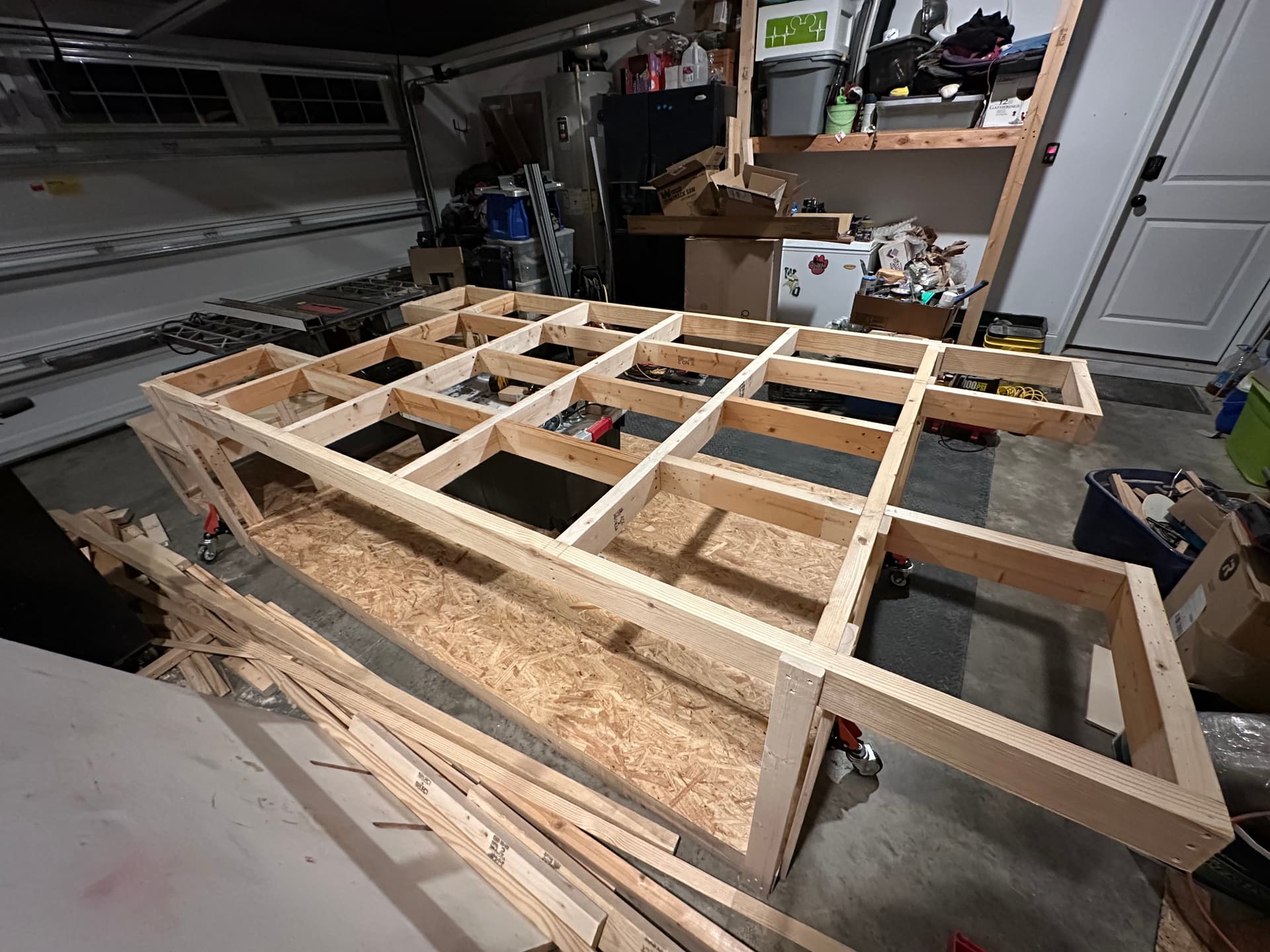

So…2 months and not a lot to say, though I have made quite a bit of progress on the table (FINALLY!!). I’ve been busy with life, and some other projects that have come up. but the table is pretty much done.
All that is left to do now is actually mount the table saw, skin the top, and start putting the LR3 together on it. I have a sheet of 3/4 MDF that will be centered, and then some 6inx10ft MDF strips to line the outsides for the rail and other Y-belt to ride. The over hangs on the one end is to make sure I can cut the full 4x8 sheet goods as needed. I also think I can use it to be able to do some vertical mounting/milling, as well as I am thinking of making an inset to mount the top part of a router table I have.
That still may take a bit, I just got a new 20-24W laser machine, and I need to get an enclosure built for that. Hopefully that won’t take too long, and I can get back to getting this spinning murder robot back on track.
