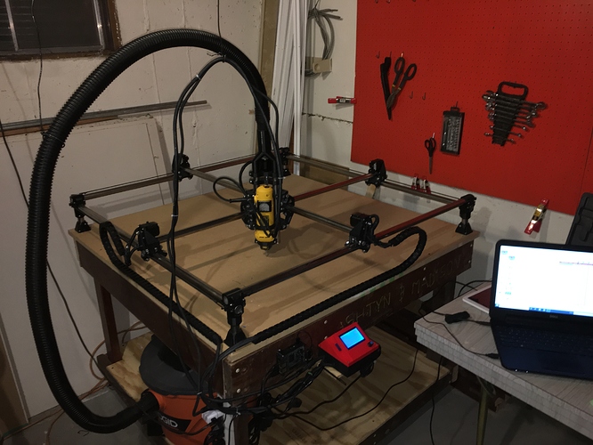

Last night I built the table from the kid’s old bunkbed I built years ago. I set up the DW660 with a 1/8" bit.
Today I made the first cut of something I’m using, my 36x36" wasteboard. Until my neighbor kicked the poor quality extension cord and stopped it 45 min in.
But it works! I did it. Now to learn what I can make!

well it cut exactly what it was told! but the bed is slightly off, higher in one corner by about 2mm. So my job tonight is to plane it. the 1" surfacing bit with 1/4" shank just arrived!
Add a thin spoil board on top just big enough to be able to plane/surface all of it. this way you do not end up with a flat depression in your surface. That way you can position things in more ways to cut them.
