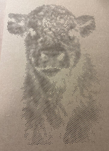

had a bit of fun on the lowrider today.
happy with the results for a test. next will be some black film face ply.
in honour of jeremy clarkson’s new calfs, i’ve decided to name him start game.

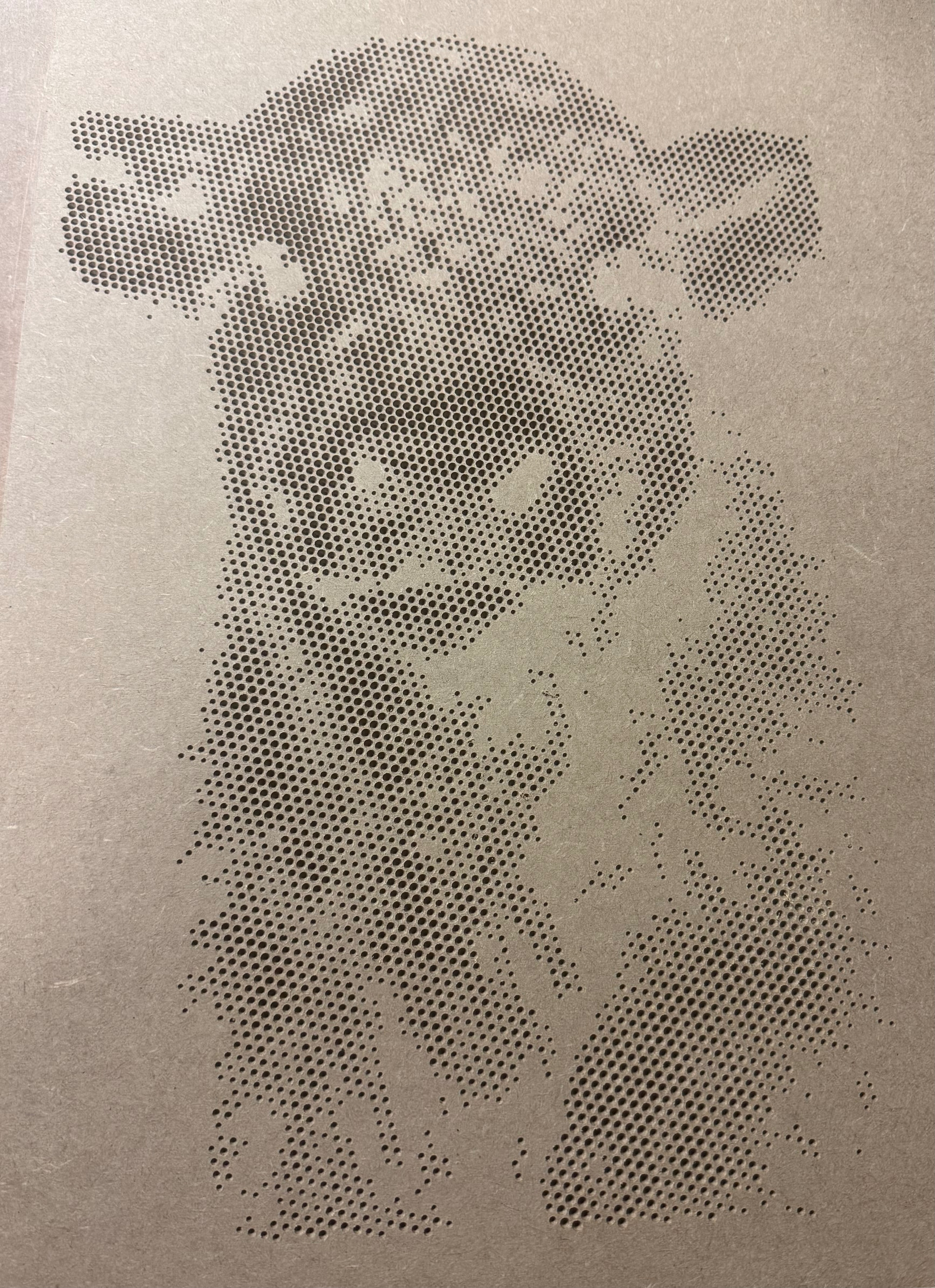

Seeing this I have an idea in mind with a background light. ![]()
That looks very cool. How did you do it? Did you use a small vbit?
I love it. How did you do it?
Can’t wait to see it with the black film face ply - some extra contrast will make it pop! Like the others - curious how you did it?

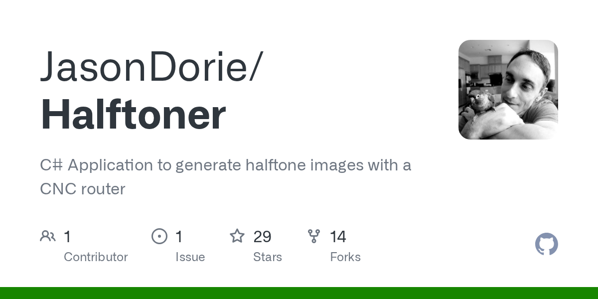

I used this halftone program by Jason Dorie to produce the tool path:
I then cut it with a .3 x 3.18 60° 2 Flute V bit.
Thanks for the share - I’m going to try it out sometime!

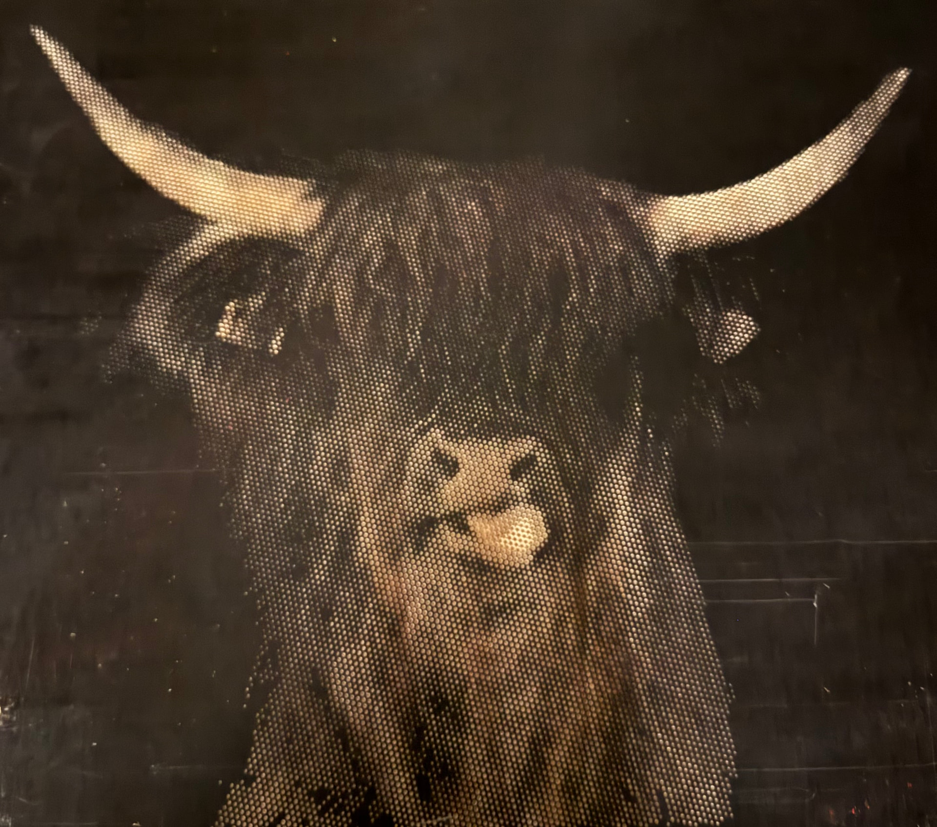

here’s tonight’s effort on an off cut of form ply i had lying around. it’s hard to photograph nicely because it’s shiny. hoping the higher end cab black i have will be better.
Looks amazing!
That is really nice, good subjects
