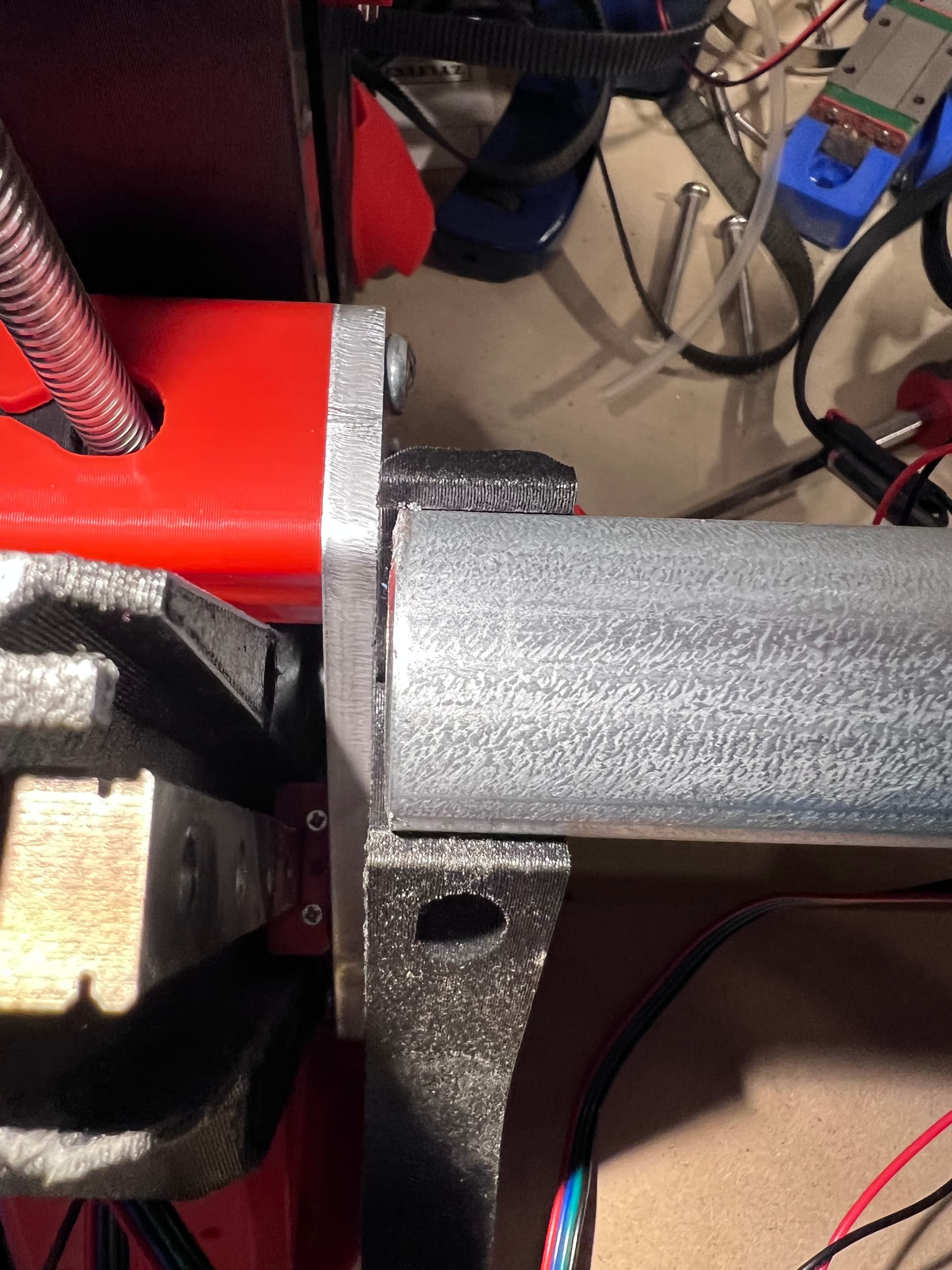

So cannot find 32mm stainless steel tube, best i can get is 31.8 mm, do you guys think this will work?

I am finding, for some reason that my non rail side is wobbling, leading to the plate sometimes not making connection with the end stop.

No, LR4 (and LR3 before it) uses only a singly Y rail to avoid being overconstrained.
A 2nd rail would make the design problem much worse for a DIY machine.
If your non-rail Y is wobbling, there’s something wrong.
Are you trying to move it manualy or are you seeing it wobble when the belts are hooked up and the motors are on?
Seeing it with the belts attached.

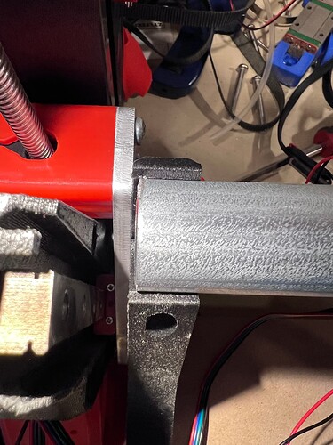

I wouldnt way its wobbeling, its like the bottom tilts away so the ZY plate is not 90 degrees.
This in turn causes the end of the plate to run into the Y belt holder
I know this is sacralige, but my XZ plate is currently 3d printed.
I wanted to use it as a stopgap until i could mill it in alumenium, but now i cant find plate anyware
are you X beam tubes too long? You want them about 2 mm shorter than your actual beam so they can be inset about 1mm on each end.
If they are a little long that will cause the bottom to push out like you are describing

Ask if they have a “drops” bin. Most machine shops do, as does Metal Supermarket. You can usually pick up a suitably sized leftover cut for $10 or less (cash in hand helps).

Although i have found a solution, buying a 150mm with 6mm thick aluminum flat bar :slight_smile:
