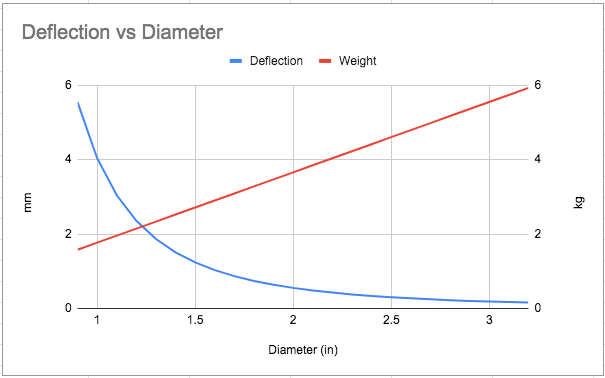

Darn, this thread got a lot of love just after I ran the numbers to decide what tubing to buy for my lowrider :wink: Too bad I didn’t post my calculations a few weeks back. Being a true believer in a scientific method, I wanted to run an experiment. I just got the test tubes yesterday …
So here we go, QD #3
Length: 72" - span ~71-71.5" : specimens were supported as close to the end as possible without slipping off the supports however exact contact points are hard to determine.
Specimens:
  • 3/4 EMT - 5.5mm
  • 1" 0.049" 304 stainless - 4.4mm
  • 1" 0.065" 304 stainless - 3.5mm
  • 1" 1/16" 1010 low carbon steel - 3.2mm
Load: 4635g or 10.2lbs

This lines up pretty well (within 10%) with the results I got from a google spreadsheet I created. Many calculators on the internet are using incorrect formulas. I guess they can put stuff on the internet that is not true …

To toot my own horn a bit, here are some graphs from that google spreadsheet
Feel free to copy ( File -> Make a Copy ) and play around with it to your heart’s content.
Base parameters are 72" long, 1" OD, 0.065" wall, 200 GPa modulus.
