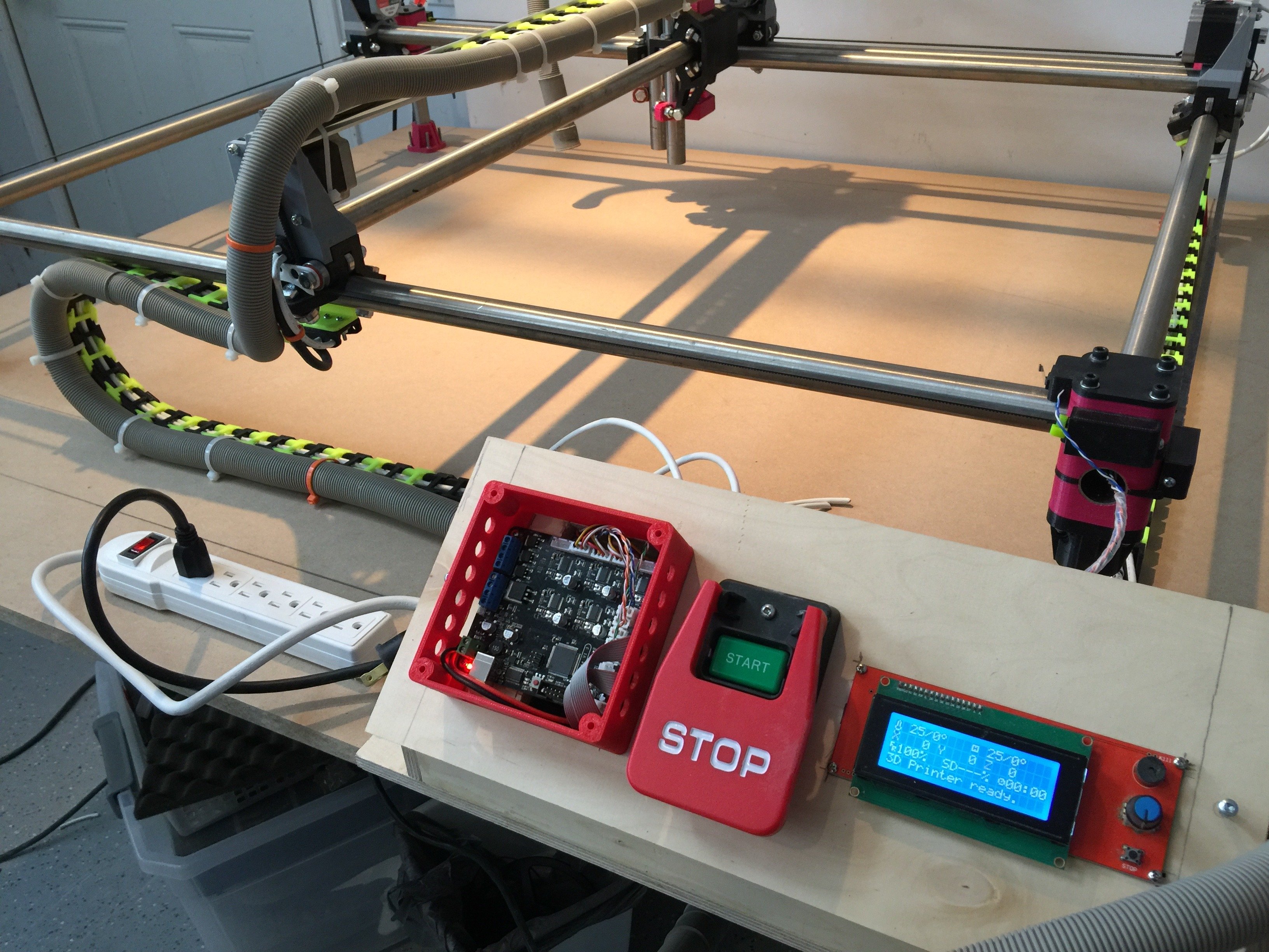

UPDATES:
Heres some pictures, almost ready to go! I’m working on an epic toolmount for the DWP611, with an integrated vacuum ring. I will print that last. Here are some of what is featured in the photos:
  1. Four endstops wired up, for when I attempt to get dual endstop levelling working.
  2. Plugs that organize the cables coming out of the tubes.
  3. Control panel with emergency stop and MKS Base fan case

Very clean build, congrat’s.
Ho does the totem corners hold up so far? Do they limit a bit the wobble of the structure?
That is something I’m currently thinking about changing on my machine, for the reason you mentionned (the amount of force you can use to tighten them is limited).
I planned to do my own design for these, but the totem ones look similar to what I had in mind.
Thanks! The totems in my opinion are a big improvement. because they are multilayered, solid, and there are no gaps or spaces, you can basically tighten to your hearts content. I have got the bolts CRANKED down, and because I am using washers, there is no surface damage or cracking occurring on the plastic. They hold the tubes very rigidly, I cannot bend them with my hands. Also, the built in endstop mounts are a big convenience, as well as the tensioners. The cons of the totem system is that they will require more than two rolls of filament to print the kit, and the 100mm m5 bolts can be hard to source. But if you can get around that, they are great.
