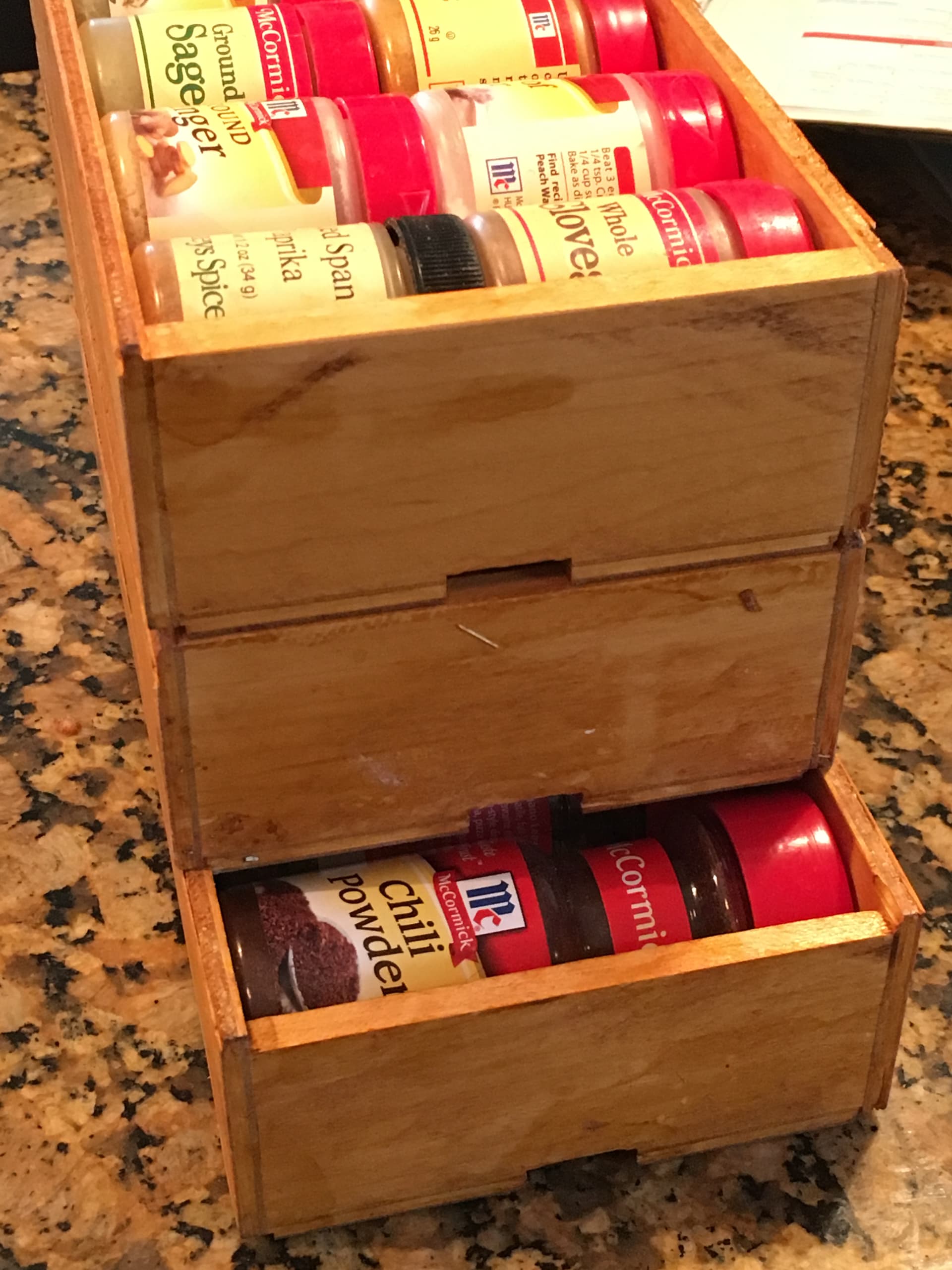

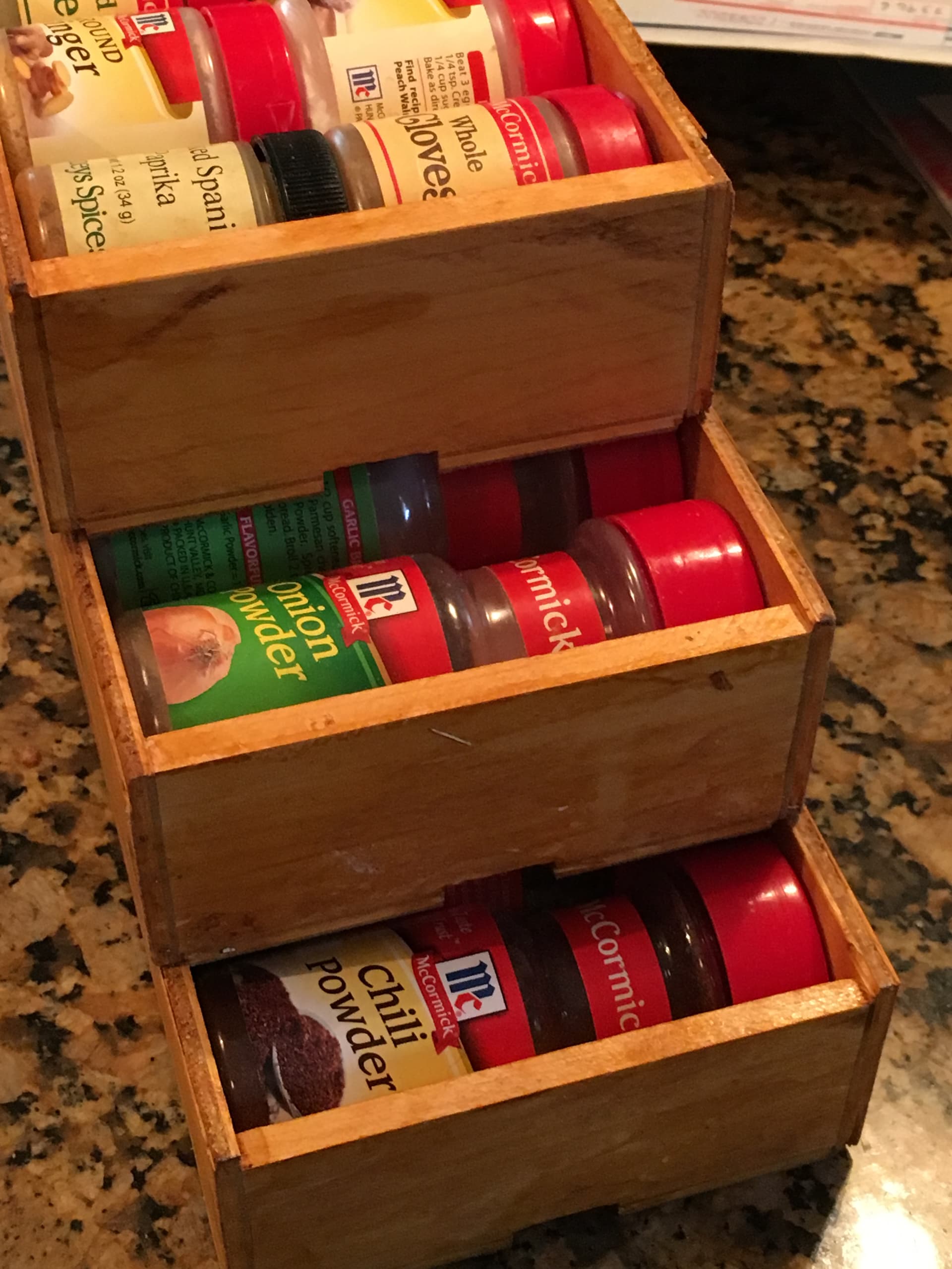

I made these few years ago as an attempt to maximize storage of spice bottles. Every solution I found commercially just does not maximize the storage volume while being easy to get to spices.

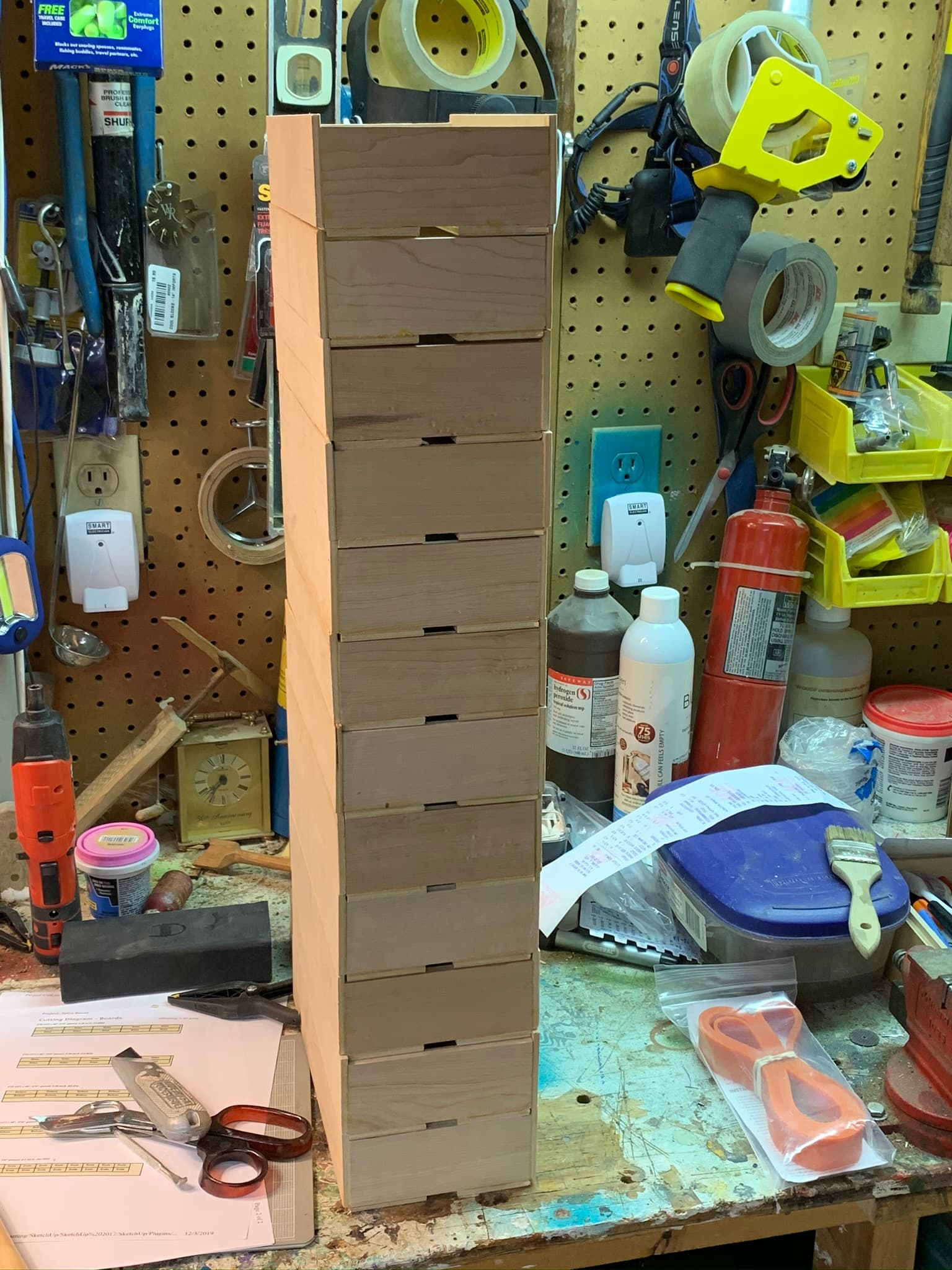

I made these for myself old shool way in my shop before I had a CNC, and then for my adult kids.
What’s nice is they nest and can stack vertically or on the side horizontally and easy slide out individually. Or carried to my grill.

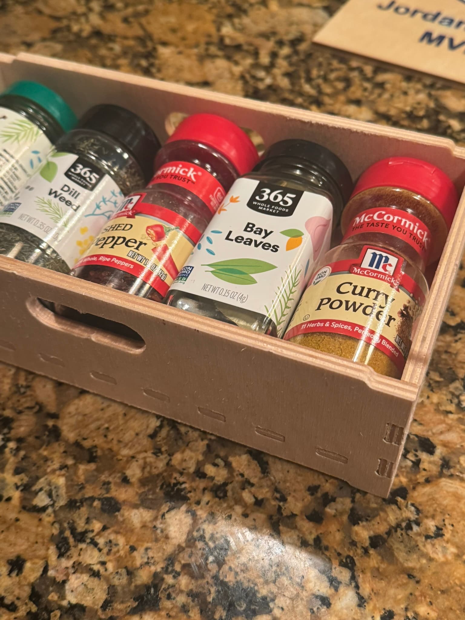

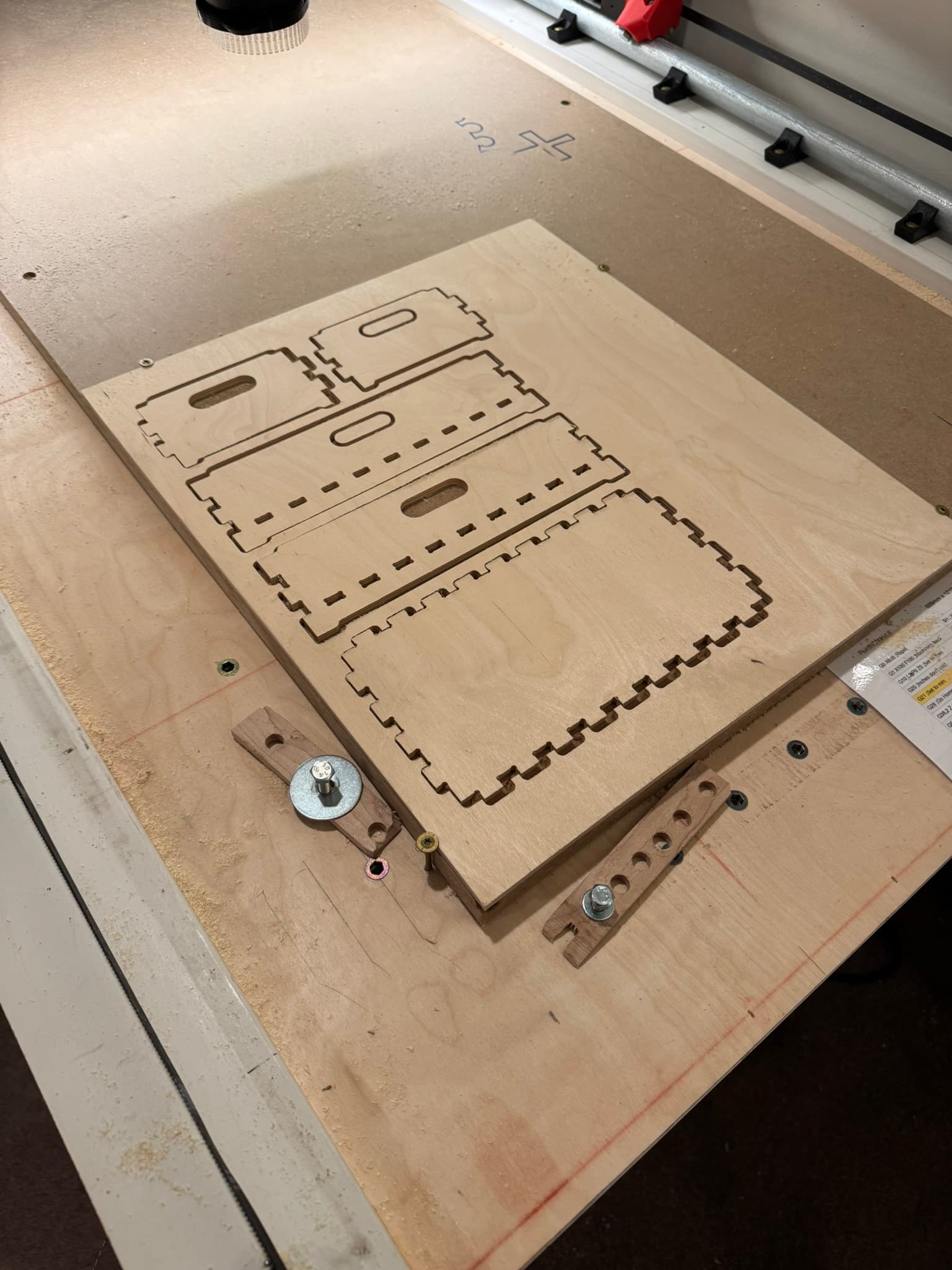

I tried with the Boxes.py for my LR4 and am modifying the model on Fusion so I can cut them.
It’s all 6mm for the CNC finger joint version.
I do need some advice from this group please:
I modeled at zero laser clearance and brought the DXF into Fusion.
I use Estlecam V12.
I also use Ryans 1/8" cutter.

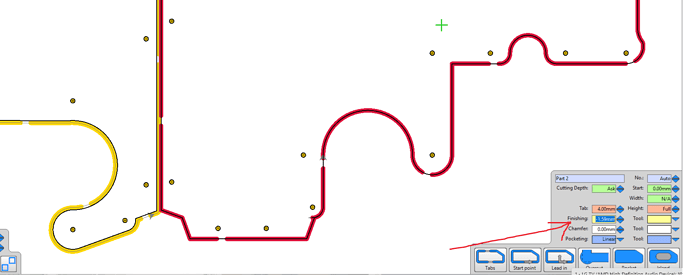

Not sure if read this right but it appears in estlecam if you put in a negative finishing value on the parting operation it will cut undersize. I’ll try tomorrow but he tool path is shown to overcut.

Neat, am able to set negative finishing values up to half the bit diameter to help shrink (or offset?) dimensions of the cut part…
well that is a cool trick!
You can do positive and negative to fine tune the fit as long as you don’t put in a different finishing tool that requires a tool change. I think the behavior does change a little if you put a different finishing tool in.
Yeah, that‘s the point: If you put a negative or positive value without a tool, it‘s not doing a finishing pass, it‘s just under- or oversizing the part! So you might be off again because you didn‘t have the finishing pass and deflection is not mitigated. Use with care. :slight_smile:
