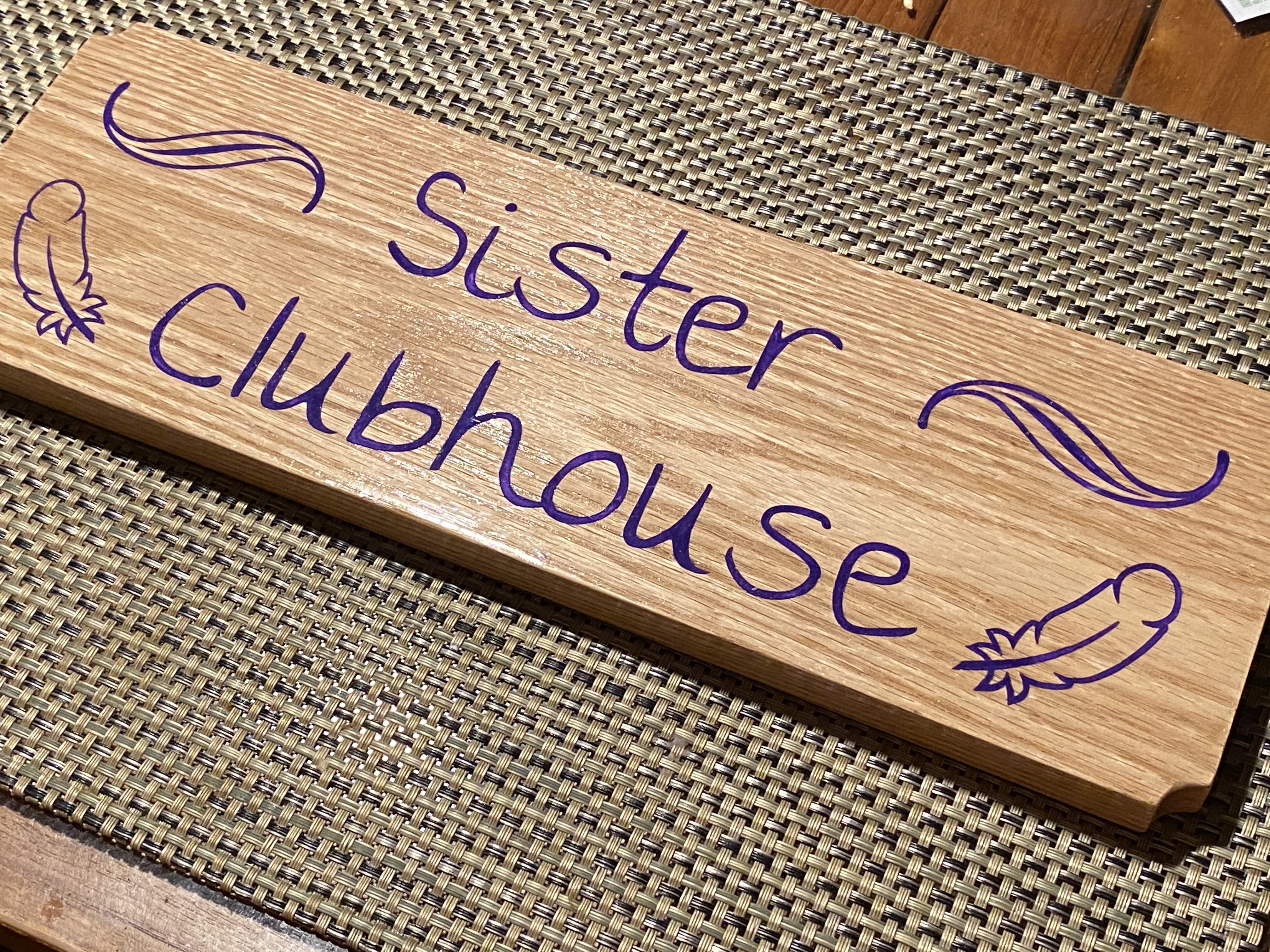

First fully completed project (after many failed attempts). Engraved with epoxy infill, and a clear coat poly.

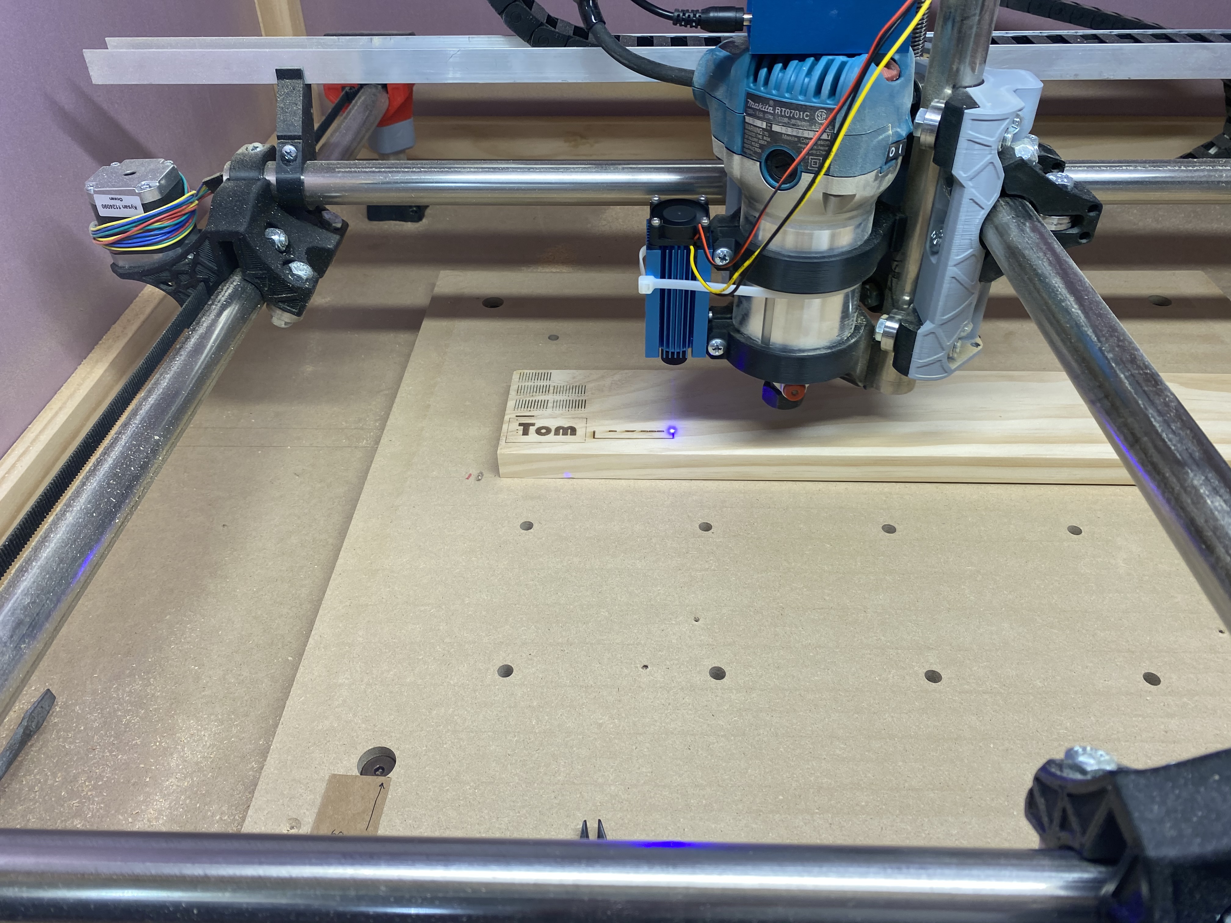

Some laser action. Note this is the SainSmart laser, which I have since upgraded. You can see the holes for clamps, and the large hole in the lower left of the work area that holds the spoilboard to the main table.

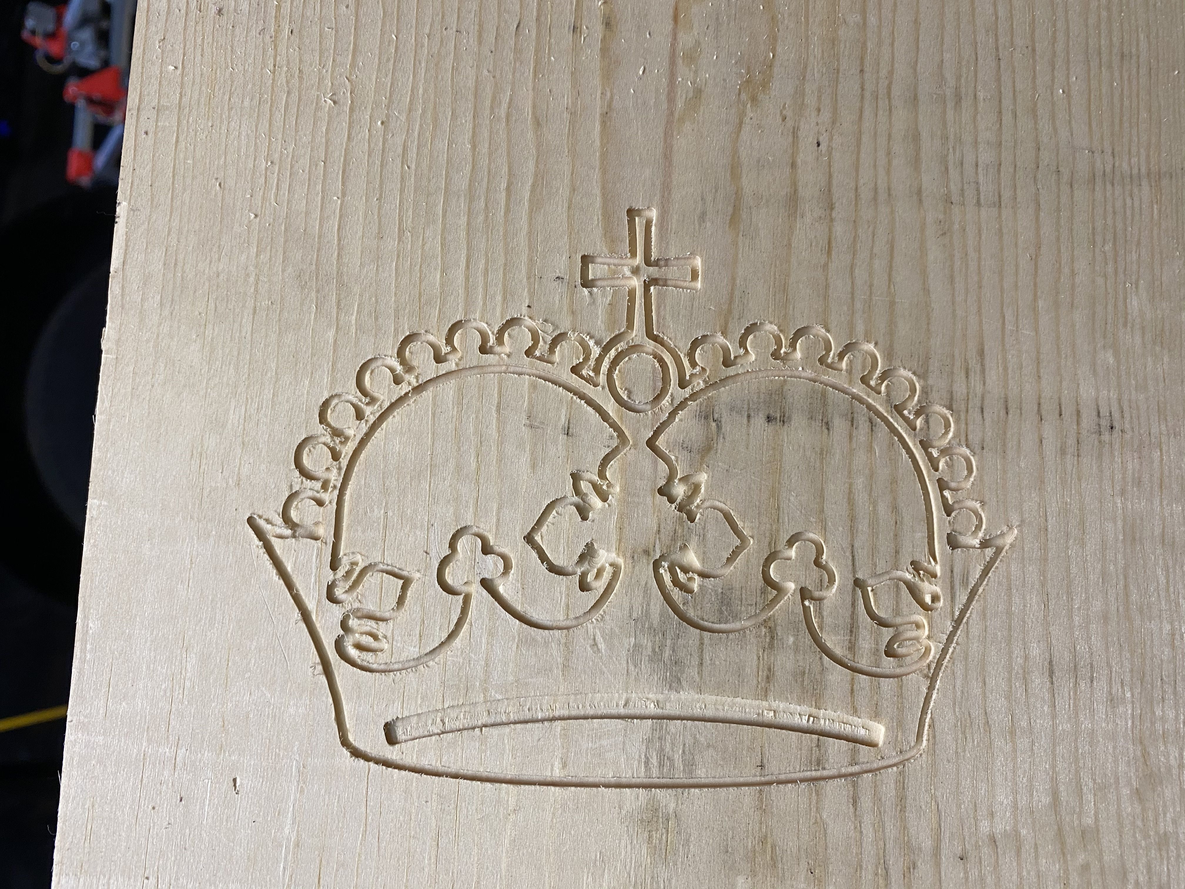

The Crown! (actually from my original Burly with a dremel)

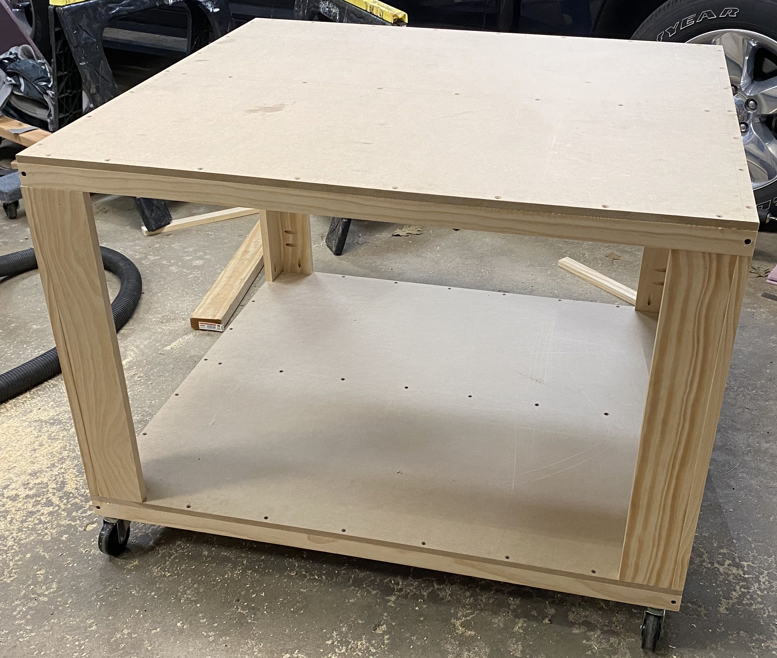

Base: Let’s start with the base. I started with a 2x4 stand with an MDF top for my first Burly. It wasn’t sturdy, it was a pain to move, and a touch too small. So I came up with this new base. I created 2 frames for the top and bottom with 1x2s, added a cross brace since it felt a little floppy in the middle, and topped them with ½” MDF. For the uprights, I used 2 1x4s joined at a 90degree angles using pocket screws on the inside to join them. The uprights screw to the top and bottom surfaces with pocket screws also. The surfaces are strong enough for what I do, but looking back, I probably would have used 1x3s for the frames. Also, the space between the top and bottom is just enough so I can fit the vacuum under it.

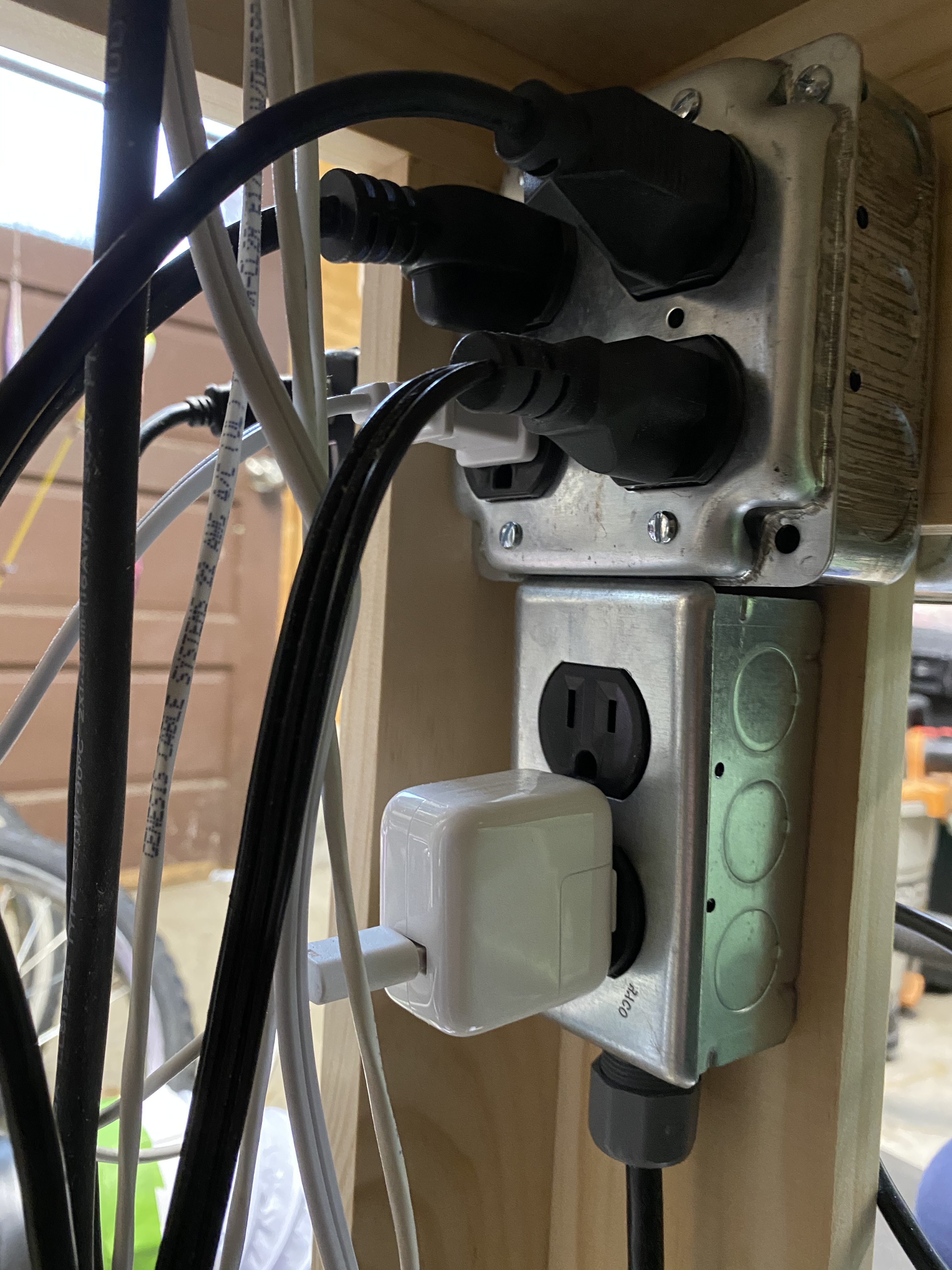

120V wiring: There are 4 switches on the front: spindle, servos, vacuum, light. There are outlets directly behind the switches to plug those items in. There are also 2 always on outlets, and everything is fed from a single cord. I had plans for an emergency switch, but I didn’t end up with one because everything was front and center. I removed the factory cord off the Makita (it has nice screw terminals inside) and added a 16/2 15’ rubber cord. I added Anderson PowerPole connectors about 6in from the router so I could easily remove it without having to take the wire out of the drag chain (10x20x1mm). The drag chain mounts are here https://www.thingiverse.com/thing:4558692. The mounts that go into the pipe must be for a different inner diameter. I whipped up come circular shims to make up the difference. It’s not perfect, but it’s good enough for now.

Laser. I started with the SainSmart laser kit from Amazon. It was cheap ($150) and I found out I like lasers – of course. My primary complaint with the SainSmart was that the output didn’t appear to be linear. When using 5V PWM from the GRBL board, the laser wouldn’t come on until about 60% duty cycle, where everything I read said it should come on in the 5-10% range. I knew I wanted some more power anyway, so that got returned. The SainSmart was good for wood engraving, but you’re not going to cut much. I also found the lens wasn’t that great once I upgraded.
From there I got an Endurance 10W laser. At the time, lasers just seemed too much of a learning curve and I wanted something turn-key. In retrospect after learning more about them, I should have spent some more time learning and done it DIY or with the el-cheapo. I’m not a fan of the Endurance driver/Laser Box, and I’m working on what I consider the ideal setup. For software, I got started with LaserGRBL and InkScape (free), but very quickly purchased LightBurn. Probably the best $40 I’ve spent in a while. I disconnect the Arduino from CNCjs, and stream gcode right from LightBurn on my laptop.

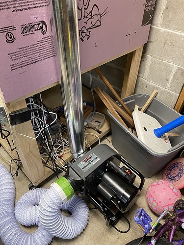

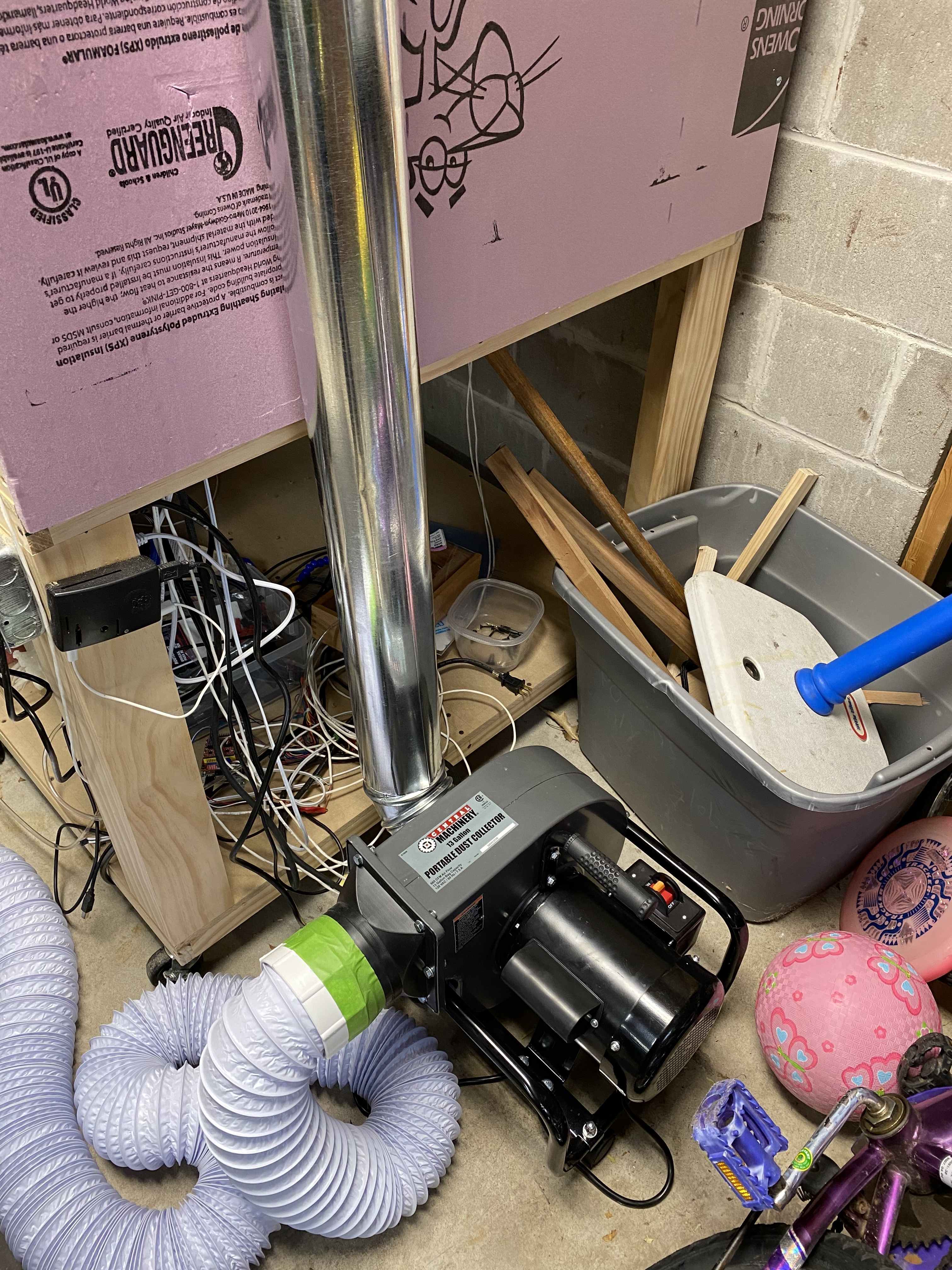

Dust Collection/Fume Extraction: I was on the fence on how to tackle dust collection. When I got the laser, my path became clearer. It didn’t take long to fill the garage with smoke when using a laser, so I knew I needed a way to get fumes out. I tried a 200cfm duct booster fan, but that didn’t move enough air once I got ducts connected to it – and the motor was in the air stream with the smoke and dust. I started looking at craigslist for dust collectors, but didn’t find anything small. So I got a Harbor Freight 1HP dust collector. It sits next to the enclosure with 4” duct that pulls air through the top of the enclosure. A flexible pipe connects to the outlet and goes outside for fume extraction. That can be removed, and the dust bag installed for CNC router work. I don’t think I’m going to worry about getting every chip when using the router, but the air assist from the laser (still a work in progress) will help clear chips from the bit while the dust collector will keep dust under control. Then the occasional vacuum when running a job. I’ll let you know how that goes.

  • I don’t think Anderson PowerPoles, while awesome connectors, are rated for AC, though I don’t know what, if any, problems that may cause.

The PP15 is rated to 15A, 600V, AC or DC. The same housing accepts different contacts that are rated to 45 amps. Unless I’m missing something.

Backside of the switches. Top 4 are switched individually. Bottom 2 are always on.

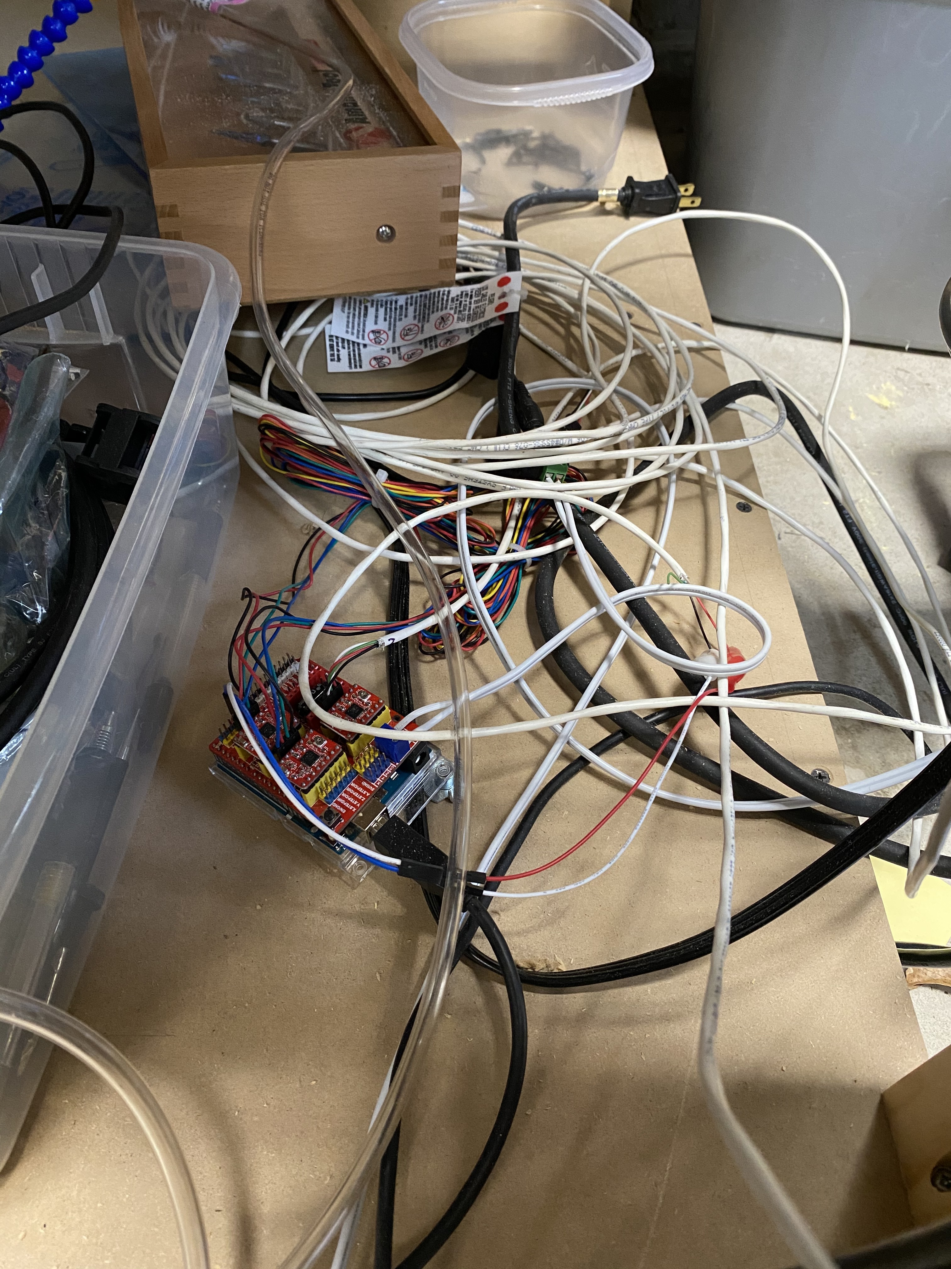

Here’s the rat’s nest of wires. Looks worse than it is. The Arduino/Shield is the brains. I used the 2 motor adapters that came with the kit for X and Y - they are bundled up in there somewhere. I ran individual 22/4 wire to each stepper in case I change controllers later and want to control them separately. There is also a Z probe connected (white lamp cord), and a PWM out for the laser. The Arduino itself is powered from the USB host. It also has an input from the power brick for the steppers. The stray 2 prong plug towards the back is from the spindle/router. When in laser mode, I connect the laser power supply to the spindle switch on the front for quick shutdown if needed.
Here is the exhaust system. You can see the Raspberry Pi on the side as well in a black case.

If you’re using a CNC Shield v3.00 knockoff, you can still get PWM for spindle/laser intensity control. With versions of grbl starting with .9 (some sub-version), the developers switched the Arduino pins for Spindle control with the Z limit switch since the original mapping used a PWM pin for the limit switch.
After enabling variable spindle speed in the firmware (I’m running 1.1 j, I think) the silkscreen on the board doesn’t match the functions but the electrons don’t care. Plug the Z limit (if you’re using one) on the pin marked SpinEn, and plug the spindle enable connection on either of the Z limit switch pins (they are electrically identical) and you’ll have PWM control which can be used to drive laser intensity or to control spindle RPM.
That’s what I ended up doing, but I didn’t mention it. I’ll go back and edit that for clarification. Thanks for pointing that out.
