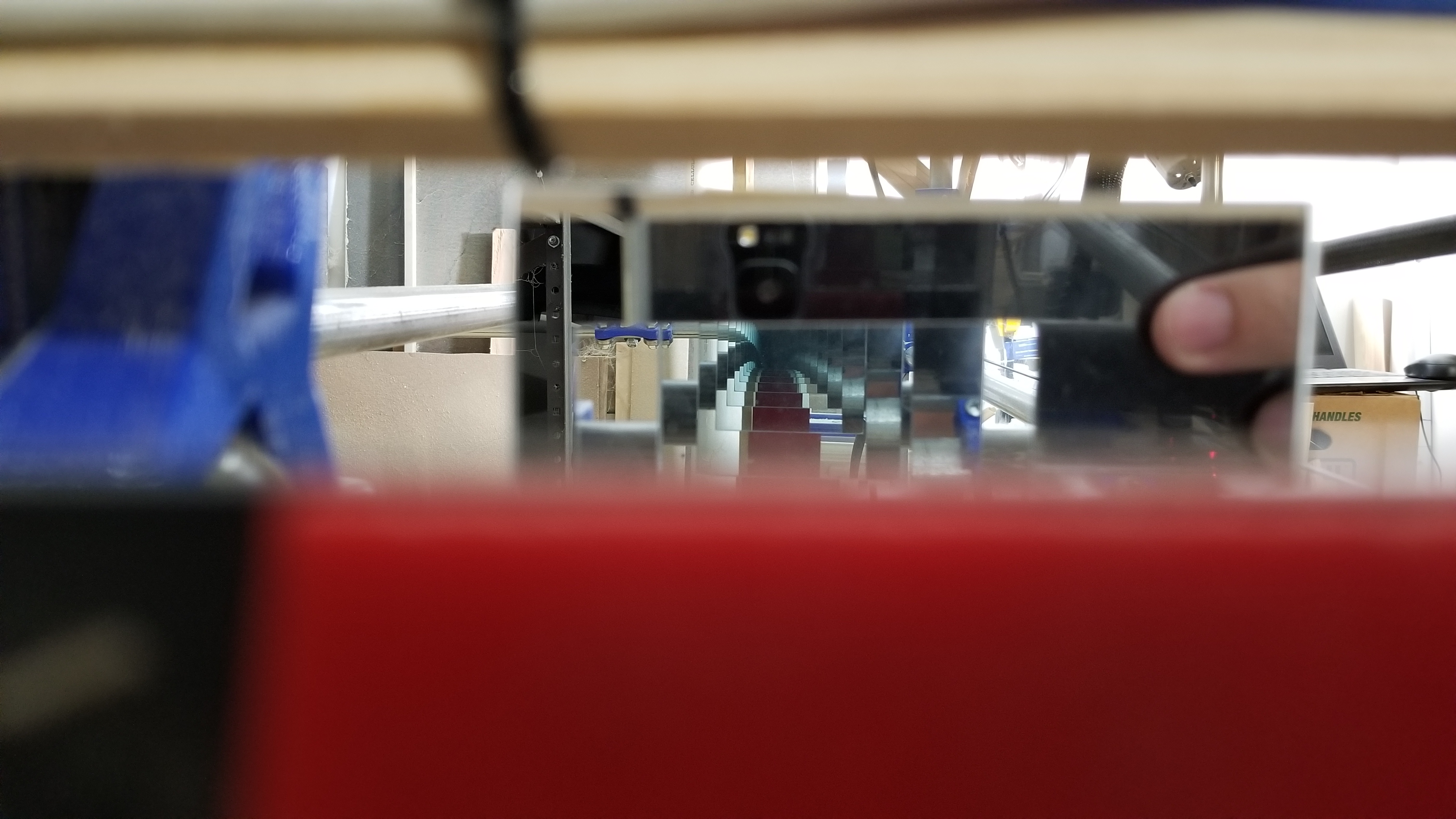

I had a different idea, using the mirror resting directly against the rails but using two of them facing each other:
Then when adjusted to be parallel you should see an “infinite hallway” that might curve up or down but does not curve left or right:
This has the added benefit of amplifying small angles.
This doesn’t directly solve the squareness problem; it only assures gantry rails are parallel to side rails, but I’ll take it.
You have earned this years prize for most entertaining way to square your build!
Any idea what sort of resolution that gives you?
I can definitely see the difference and I think optimize to within one cog of one of the motors, which is 0.64 mm over a span of about 34 inches or 864 mm, which is 0.042 degrees.
Since the belt can move by 2mm increments on the pulley, with 0.64 mm cogs of the motor, you can get smaller than 0.64 mm resolution if you’re willing to relocate the pulley on the belt. If you move forward by 3 cogs its 1.92 mm and moving to the previous belt tooth you get a net movement of -0.08 mm. So you can really get super fine resolution if you’re willing to go to that level. This could be helpful for squaring smaller machines where each cog is a bigger angle.
Maybe a very fine vertical wire can help eyeball whether the infinite hallway curves left or right. It’s a bit hard to judge from the sides of the hallway but it’s easy to see it move. Resolution is there but accuracy is questionable.

If you don’t want to get the belt off of the pulleys for the fine adjustment, you could try skew correction in Marlin to get the last few tenths of a mm correct. You’d need to line up the mirrors the same way every time then, but not exactly straight. Accuracy will also be questionable with this method though.
This could work but it gets more difficult to observe curvature of the “hallway” as the mirrors move farther apart. You could measure the gantry rail against each side rail but then you depend on the side rails being parallel to each other so thats another variable.
