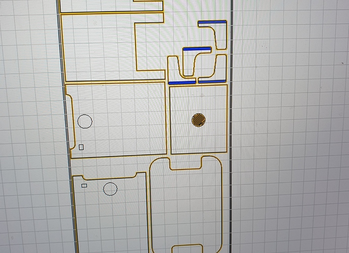

Hey,
So I wanted to get my spoilboard flat and even with my router. The biggest flat bit I have is 19mm wide. At 1mm depth, to cover an area of 2440 x 1220mm will take something like 40+ hours, at 20mm/s. Even if I was to run it at 50mm/s, it would take 17 hours.
What am I missing? Do people invest that many hours in doing their spoilboard? Do I need an extra large bit?
What’s everyone doing?
Thanks
I don’t think anyone is surfacing the whole low rider. I proposed a couple of times that someone should use a frame and flatten that, then attach the spoil board to the top.
But really, what are you doing that requires surfacing the whole thing?
[attachment file=88235]
I remember you had suggested that when I was building my table. I might take the sheet off and do that. I have about 1mm drop on the opposite side diagonally .
I have a 1 inch surfacing bit. Haven’t surfaced the lowrider yet. I need to though, I’m planning on a full sized 3d engraving, so I need it flat!
That is pretty small for a cnc this large. But those are through cuts, just add 2mm to you cut depth and cut those guys out. The spoil board is meant to be spoiled!
Have you looked at how the carving will take?
Hehe, yeah you’re absolutely right. I set my height with the intention to only just penetrate the bottom and marking the spoilboard as least as possible.
@Jeffeb3 I have just removed the spoilboard and am manually (with the knob) manoeuvring the router and surfacing the 2 x 4 underneath. Actually it’s not taking as long as I thought. Another half hour and I’ll be done and ready to screw the spoilboard back in

Thanks, I’m pretty new myself, but I did get it sorted. I did what Jeffe said and had suggested when I was building it (I was in too much of a hurry to do it lol) but didn’t at the end.
So I took the spoilboard off, manually (with the lcd knob) routed all the 2 x 4 underneath and although I haven’t tested it yet (that’s another story) it actually took off around 3 mm from some places and none at other spots. Now there’s a groove where the spoilboard just drops in. Won’t be able to test it with the router because I killed it.
