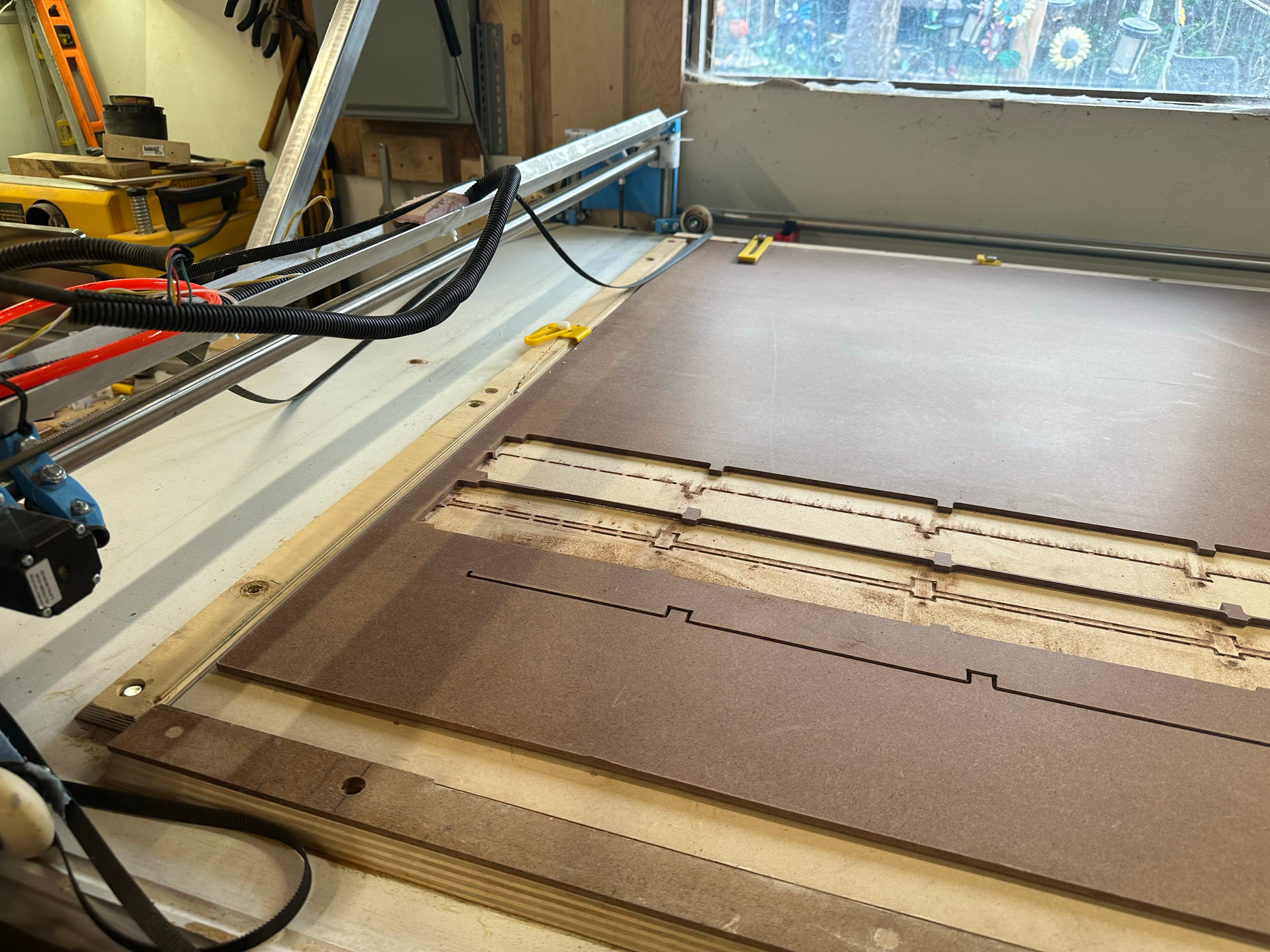

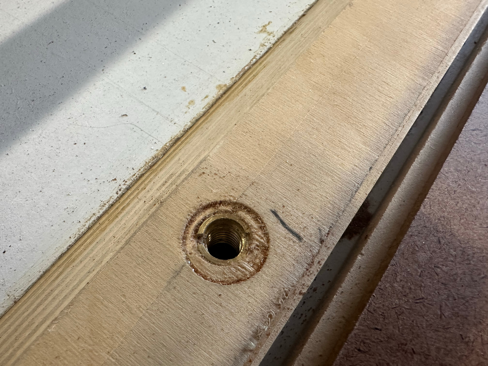

I have a raised guide around 3 edges exactly the right size the MDF just slides into it. Really easy to flip over when the time comes. The guides have threaded inserts going into the table so I can clamp around the edges. There are also threaded inserts that line up with holes in the MDF. If anything I have the opposite problem.. instead of curling up, if I clamp the edges too hard the stock lifts in the middle. I find light clamping works great for big stuff, and for small pieces, double sided CNC tape.

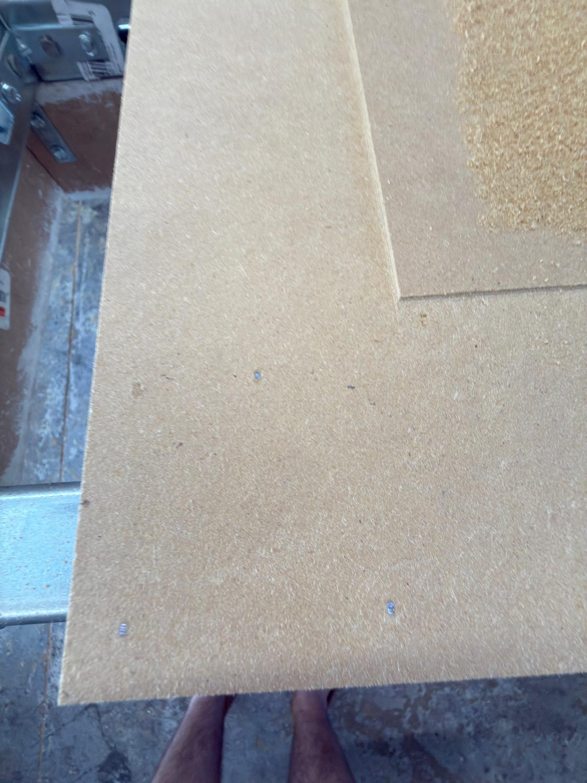

I used wooden dowels with wood glue on the edges of the board. Once you need to replace the spoil board, it is easy to remove with a oscillating tool and pin nails through out the spoil board. It works great for me

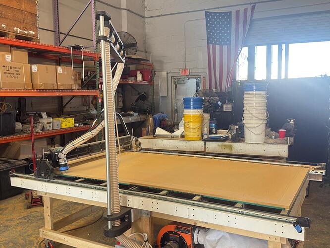

You can see the wooden dowel and the pin nails. I actually just replace the spoil board so I am flattening it now. The hose system I designed works awesome, it spins freely with the machine and causes absolutely zero issues.

Google “composite brad nails”.
They don’t work very well in a standard Brad nailer (ask me how I know). But they supposedly work well with a dedicated composite nailer.
The plastic nails hold the spoil board in place, and won’t damage the router bit if they are run into during a cut.
Interesting. I suppose I am more worried about long term damage to the foundational table top. That is 10x more inconvenient to remove and replace. What are your thoughts in regard to that concern?
There should be no damage to the underlying table surface. The composite brads will shear off with side pressure, leaving the base pretty much undisturbed. If there is any protruding remnants, they can be removed with a sharp chisel.

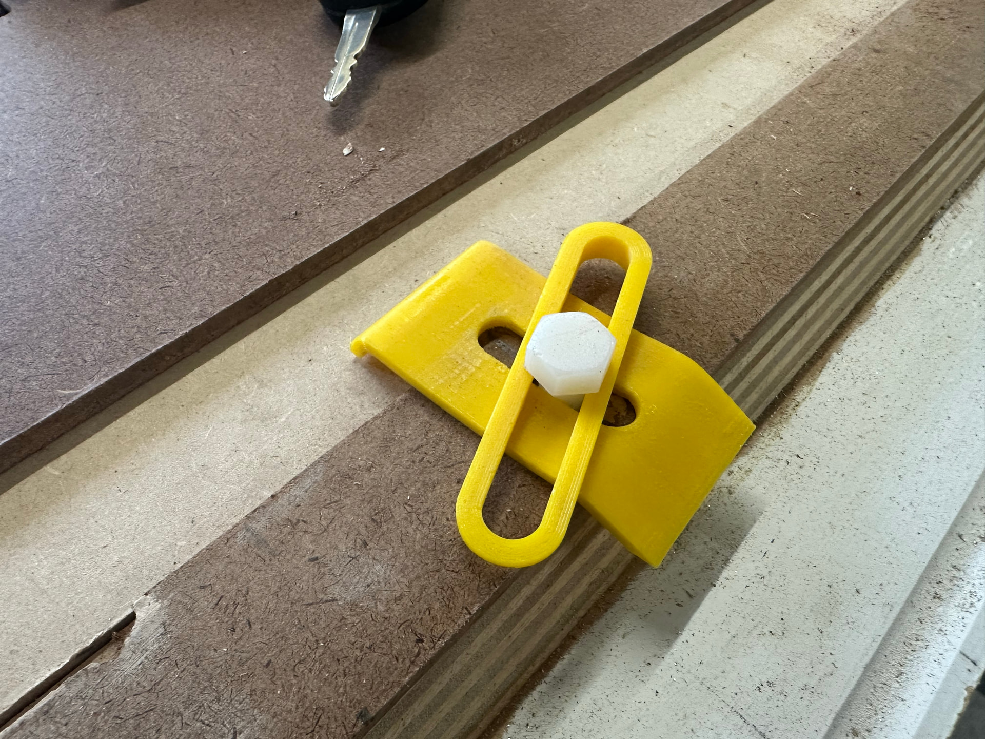

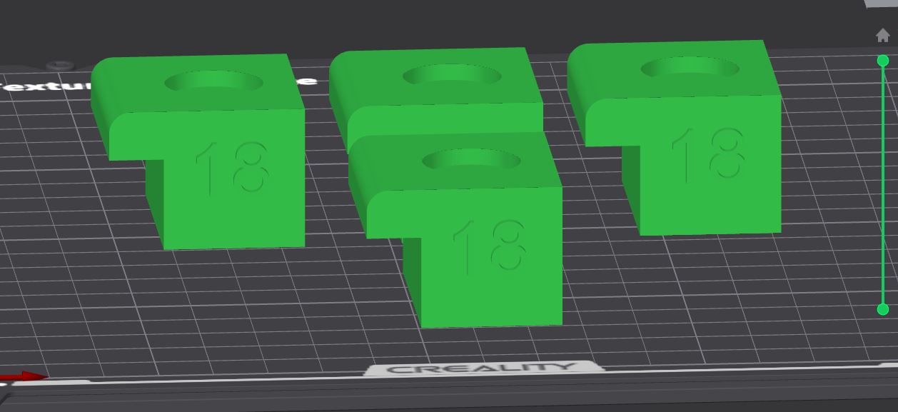

just have some 3d printed blocks ive made them various heights for sheets
recess is for a washer so screw doesn’t pull through

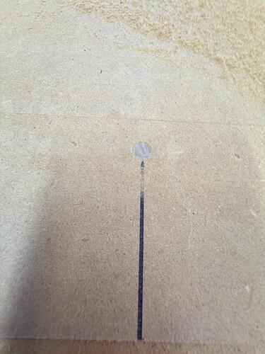

i just use an 8 gauge screw and screw to main table ,it leaves small screw hole in main board , they fill really easy with say contract filler
