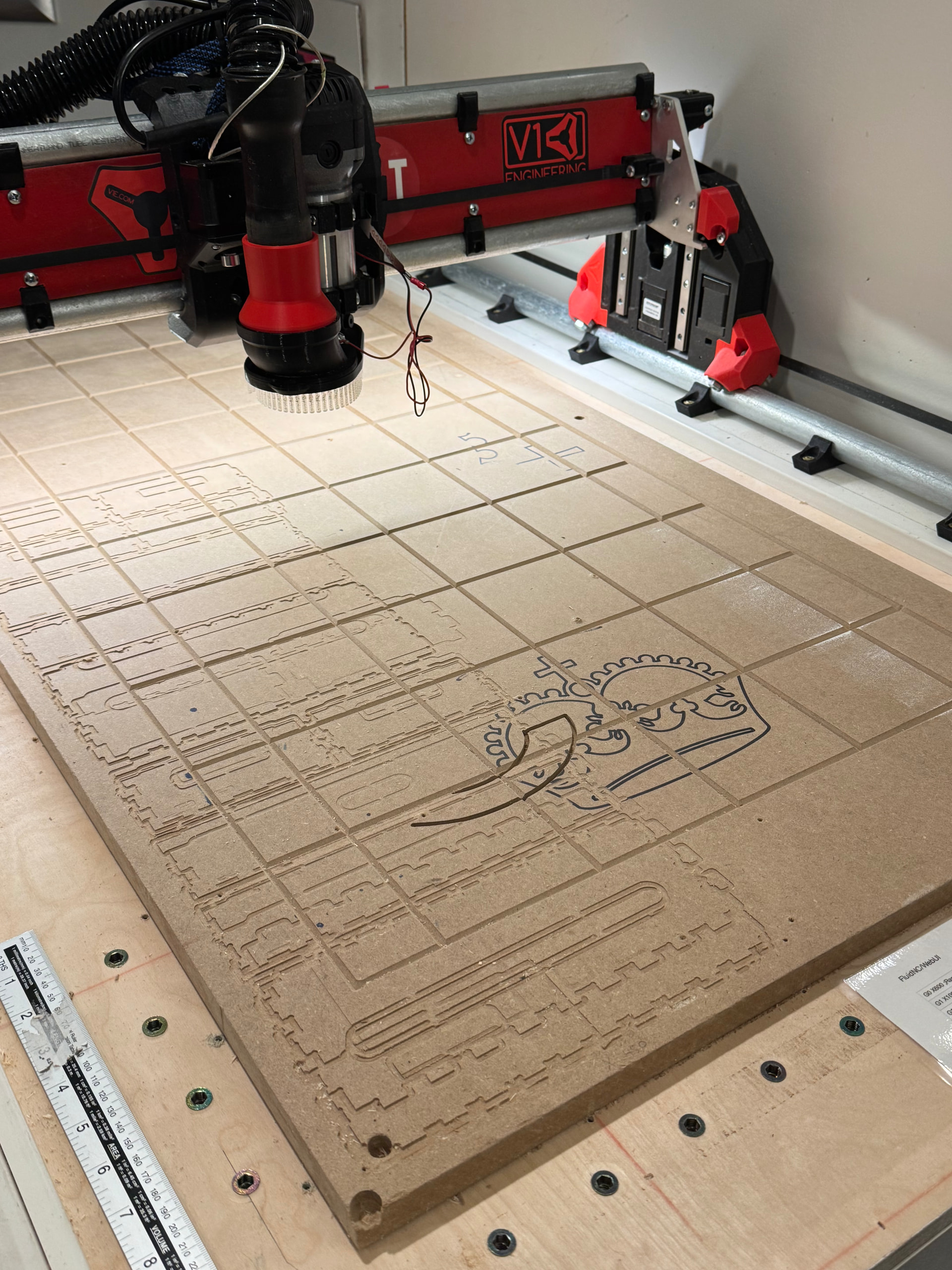

I am just too lazy to mill a skim coat off of my MDF spoil board. I wanted have a graphical check and decided to use an Amana 45º (90º) V bit I just love.

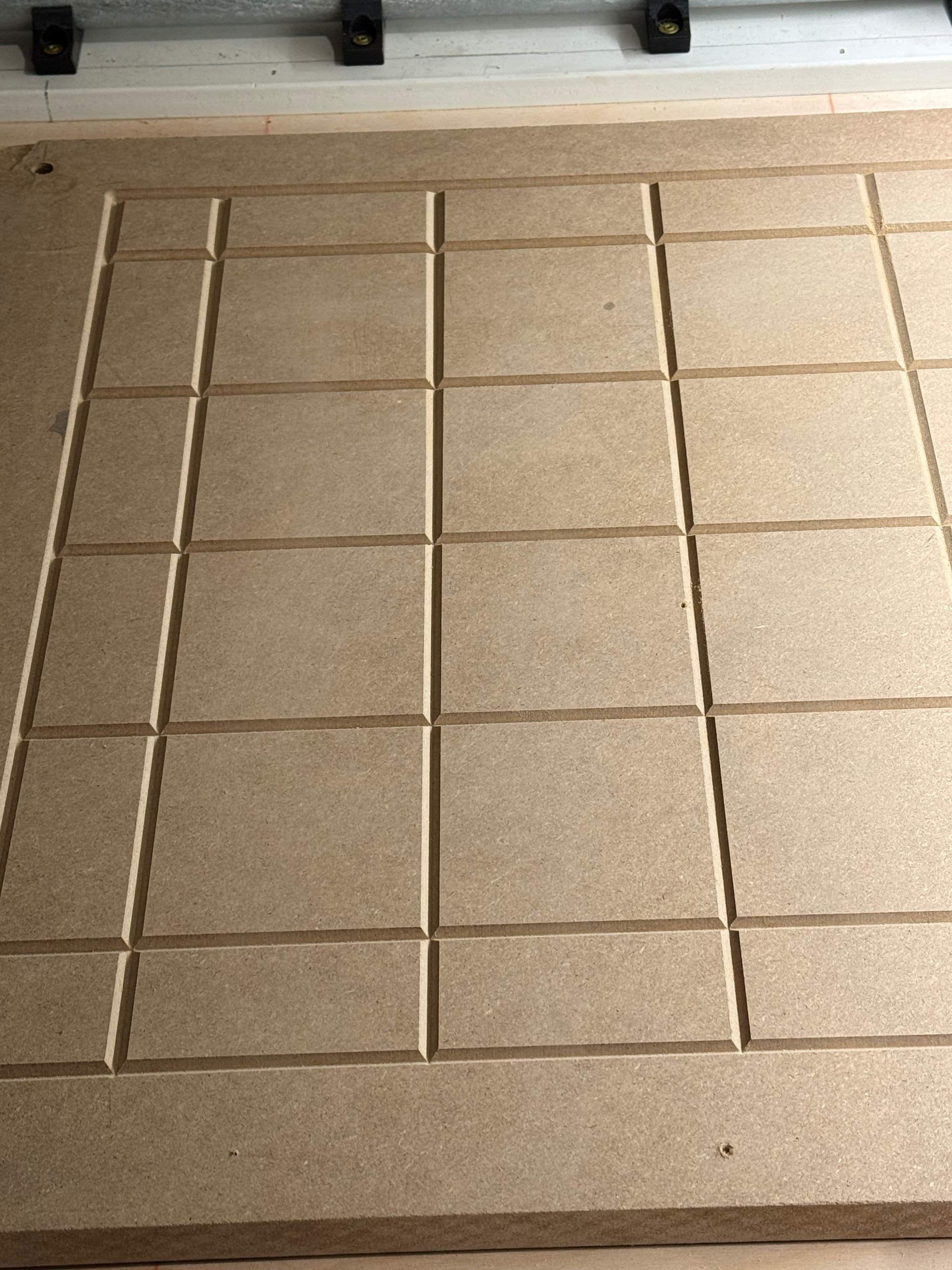

I used to cut 100mm grid at 2mm deep knowing that doing the math the width at the top is double the depth so 4mm wide, for 2 deep.
This gave a very quick “topographical” glance of the entire area.
It’s hard to photograph because of parallax but in person is easy to see and measure where it’s wider or narrower. I also like the groove for reference and if possible driving the hold down screws in the valley. As well as sawdust (or should I saw cutter dust )
Just a thought.

I just surface my big machine I took 0.4mm off the surface in two passes. 0.2 took off a few really high spots, 0.2 more got most of the rest. I am left with a semicircle at the very front that is probably 0.1-0.2 low. I can live with that until I surface it again.

I just liked the idea of seeing the groove width to just get a visual of “the lay of the land”
