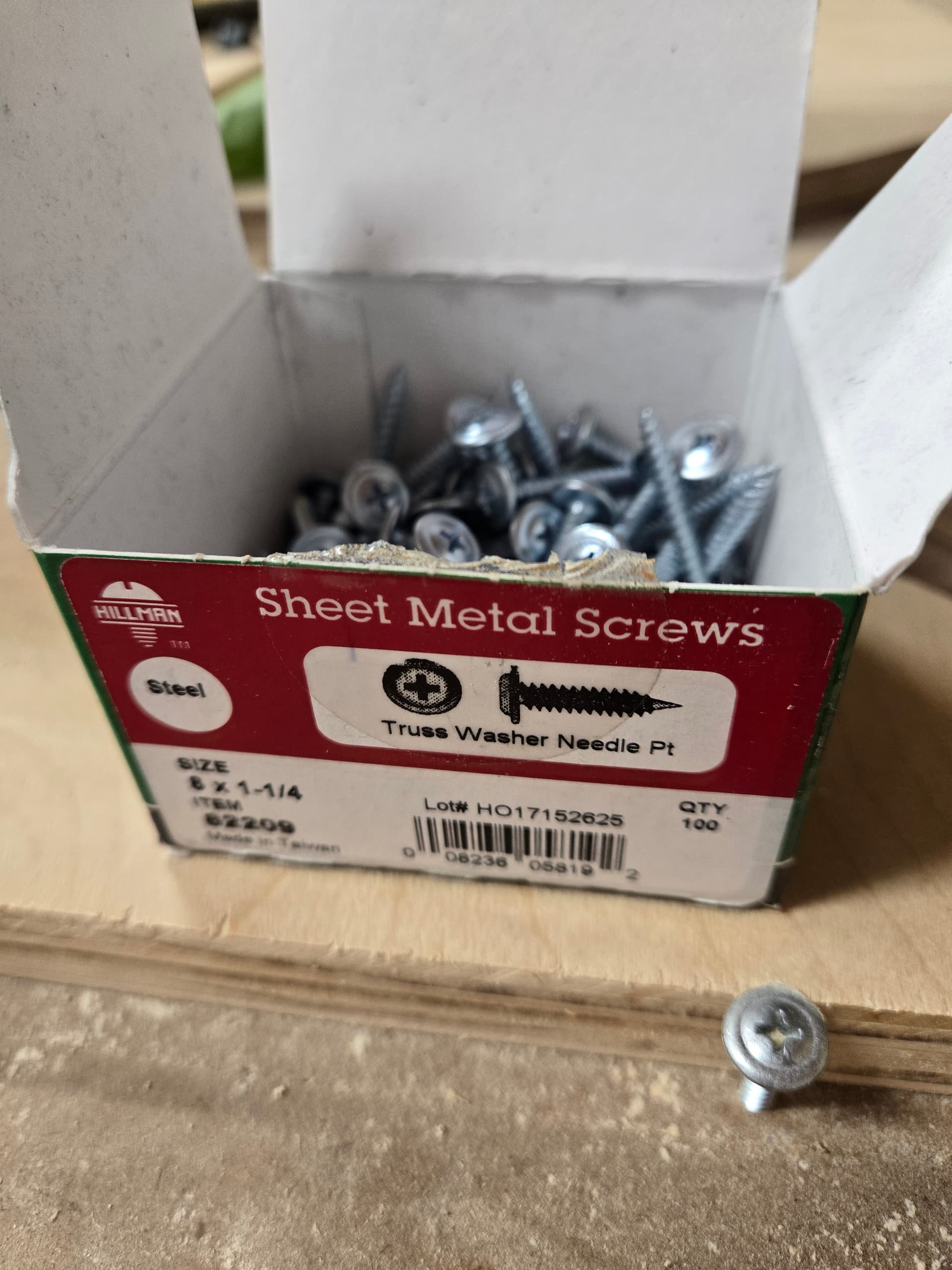

Same. Here’s my box of hold down options.
I’m a big fan of my pin nailer from harbor freight.
I’d love to have those. We don’t have them like that, they are always “self-cutting” which is kind of annoying for wood. Still works though, but makes huge holes. :frowning:
