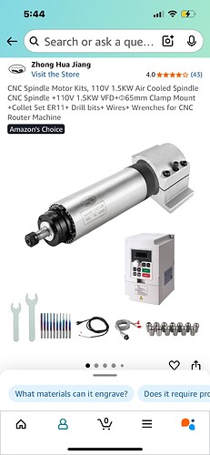

Hello, I am thinking of buying this spindle and VFD on Amazon for my LR4. I have the jackpot controller. Will this spindle & VFD work with this machine? I used a harbor freight router on my last machine and it’s just so loud. Thanks in advance.
The 65mm diameter its ok. You should read what vdf comes with that kit(model) and look it up into the fluidnc wiki spindle section and see if it is supported. I would recommend a kit with the HY type
That will save you some headaches :winking_face_with_tongue:.

An 800w spindle will work for you. Im pretty sure you wont beed the full 1.5kw
Dang well I guess we’ll see. Can you please link the fluidnc wiki spindle section that you speak of? Also, the spindle and vfd are past the return date so I hope it works lol.
1.5kw with 110V is not too much, so I’d take it. I run a 1400W with 230V…

The fact you found that complicated means you aren’t ready to use it (i mean a spindle with vfd) I think you would find out that running the recomended palm router will suit your needs more. I would opt for the carbide router (it comes with 1/8”+1/4" er11 collets out of the box. That should get you going pretty easy
I run my lr4 with it + a relay module to handle the On/off function
If you find yourself needing the speed control Link (select 110/220v and the HY option -that will save you some headaches-
Thats an 800w spindle with a plug &play vfd for fluidnc
Note: you will need the rs485 module for the jackpot controller. 8mm tpu hoses, water pump.
The config for the jackpot its pretty easy, once you have set up the vfd parameters the config example from the fluidnc wiki works. I would advice to start with the 60usd carbide er11 router

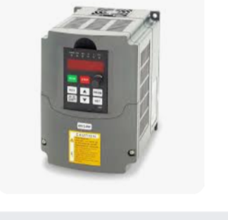

If you cant return your spindle kit and already ordered the module: get the HY type VFD. The inverter alone will run for less than 120
you want this one not not this (fc01 can work, but is a hassle)
