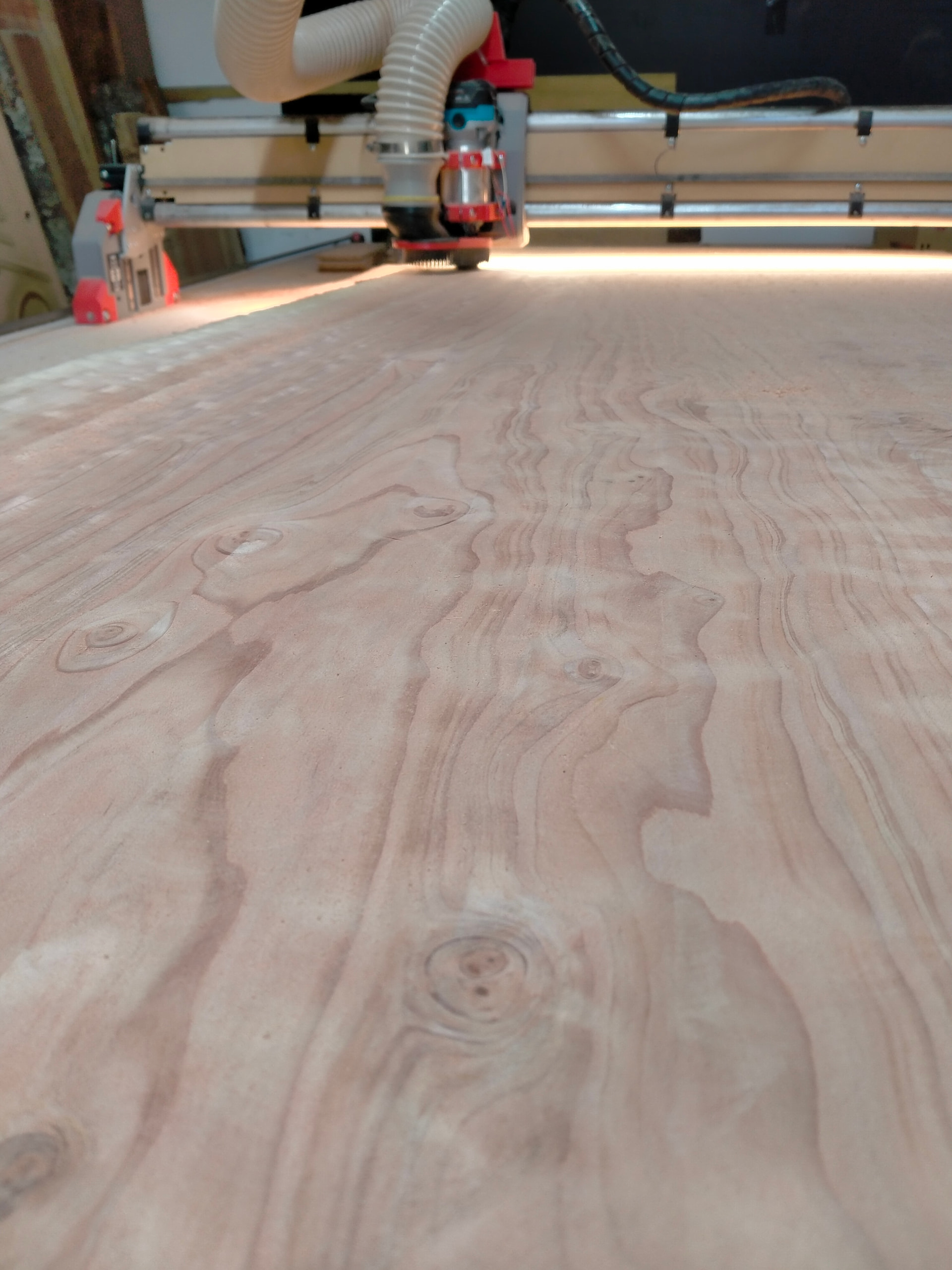

ive been doing a fair bit of surfacing of slabs lately, with the below tool from temu ,
surprised me of how good the blades are even on Kauri.
1st few trials was getting the same issue , and my router is not dead plumb
after playing round more, i come up with theses settings.
what i do now is run normally .5mm 1st pass to test wood dentistry etc
at 3600mm/m dial 1 on router so about 10000rpm prob should be bit faster rps but cheap router gets bit hot with that sized bit at
depended on timber, number of passes required after that to get to depth leaving .5mm of stock
than 2 final passes:
pass 1 @ .25mm at 1500mm/m 70% step over
pass 2 @ .25mm at 1800mm/m 90% stepover , sometimes slower on last pass just got gauge what the timbers doing , just jog it down max of 30 % any slower and tool starts to bite in
that seems to give it a good finish
that was redwood slab I surfaced just before xmas, pretty sure that was last pass, and that slab was a pain due to all the compression , it wanted to tear out so much. i normally surface redwood at 1mm per pass , could only manage .5mm passes

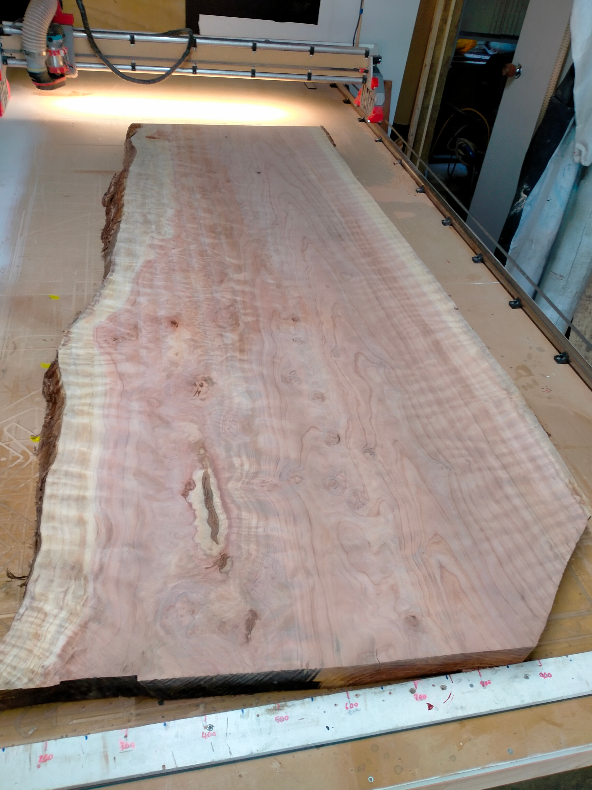

Thats after last pass
the lines that are visible, top left are barley there , took less that 20min to run over with 220g on orbital and they were all gone
