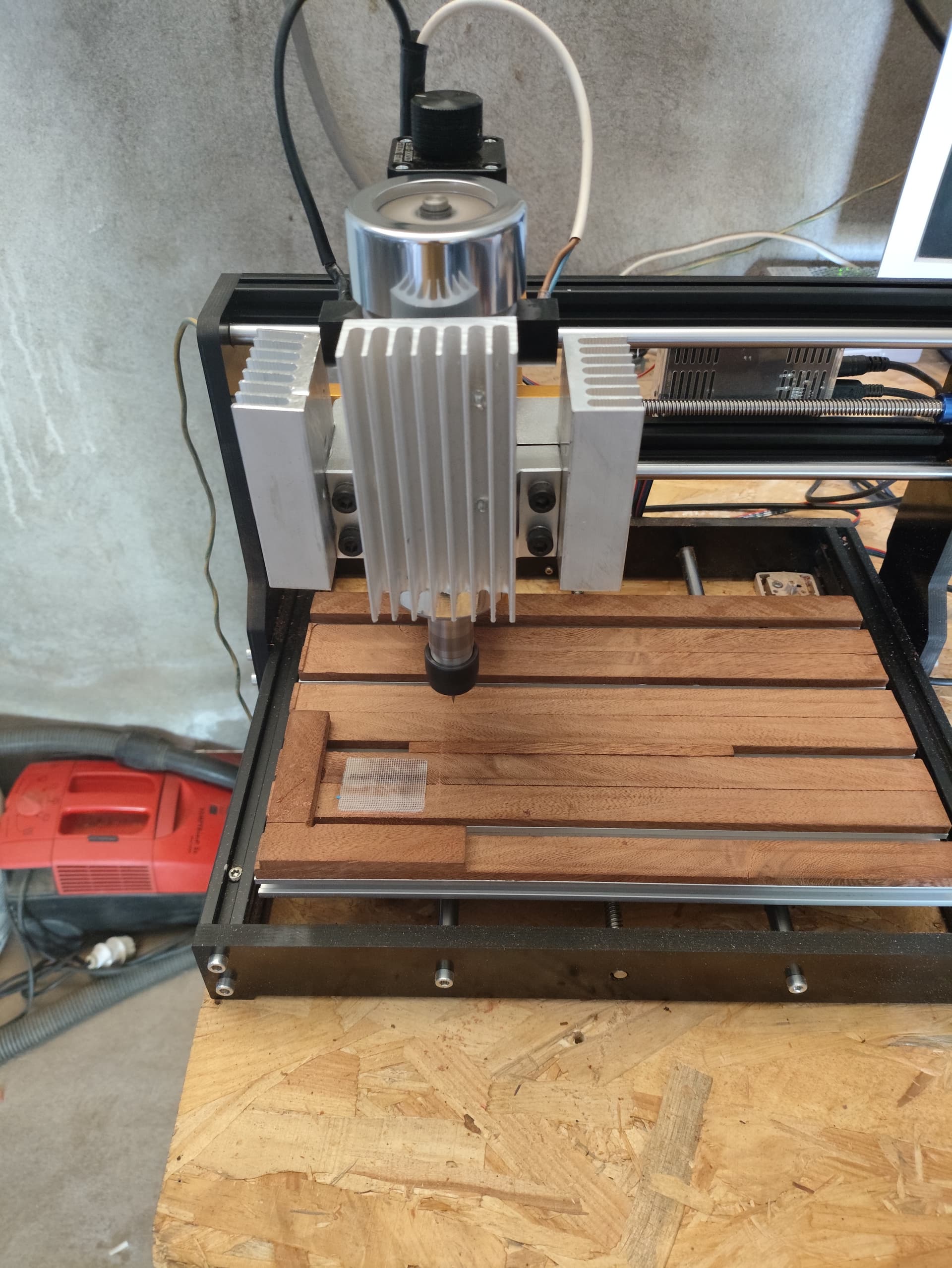

I have a simple Chinese 3018 pro with a 800 w, 110v dc, 20,000 rpm.
This motor likes to get warm, I think too warm because USB error occurs regularly.
My question is, how warm can such a motor be max., and why this USB error message.
I have only placed a few cooling coils, which regulates the temperature, but actually this should not be necessary, right. Why then quickly a USB error occurs and you have to start all over again.
Can someone explain what is going wrong here?

It just happens spontaneously, I thought after 3 hours of milling that my spindle was getting a bit warm, and that could be the cause.
Today the spindle is not warm at all with those thick ribs, but then suddenly that USB error again.
