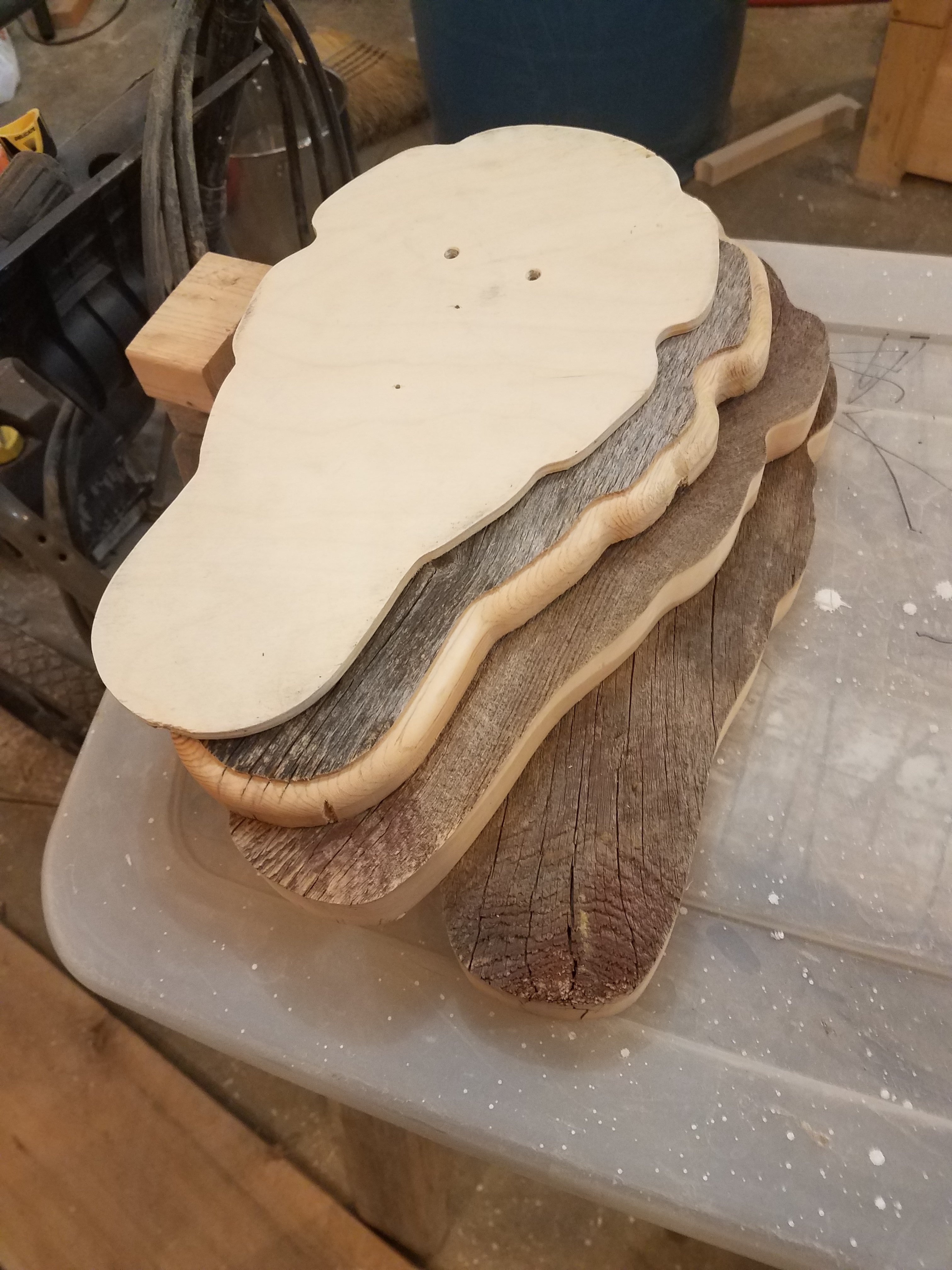

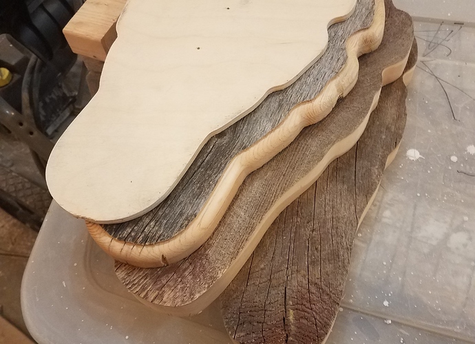

Thanks again for the feedback. I only have 2 flute 1/8 end mills. They cut horribly for cedar. Parts are great while others are brutal depending on grain.
Slow down the rpm, and they should work. Basically half the rpm of a single flute.
A single flute is slightly better because of a larger flute means easy chip evacuation.
I had slowed the RPM to the lowest setting and it was still making powder at 15 mm/s. I’ve got a set of single flute bits coming today, we’ll see how those go. Thanks!
I did some tests by hand to feel forces. With the 1/8 single or double flute end mills I have I had to push hard even with very thin depths. Obviously not great. With the 4 flute 1/4 there was virtually no resistance even through knots and deep cuts. I did some 6.5mm deep cuts at 15mm/s without issue. I kind of want to see how far I can push it on a few tests to see when steps skip. I would want to make sure I’m not on the edge. The 4 flute 1/4 made really nice cuts too.
