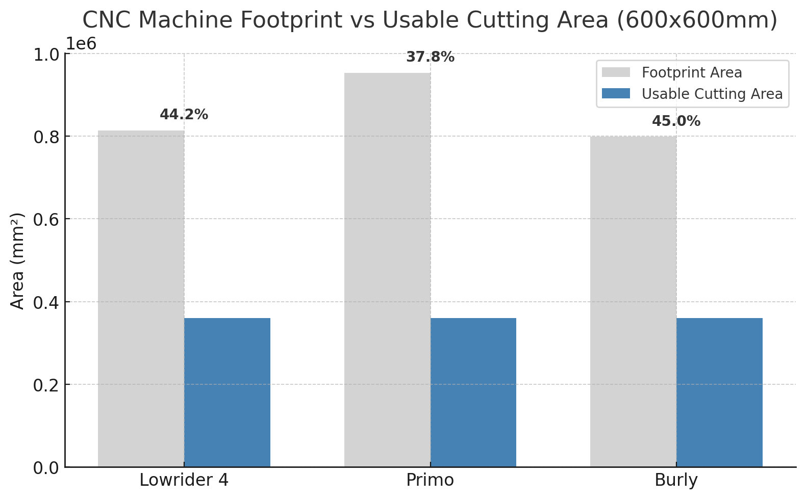

Space Efficiency Table, LR4 v Primo v Burly
I wanted to know which of the V1E machines are most space efficient so I compared 3 machines using the calculator set to 600x600mm useable cutting area.
Data table
Machine Footprint (X × Y) Footprint Area (mm²) Extra vs 600×600 (X / Y) Border per side (X / Y) Space Efficiency (usable ÷ footprint)
Lowrider 4 892 × 913 814,396 +292 / +313 mm 146 / 156.5 mm 44.2% (55.8% overhead)
Primo 972 × 981 953,532 +372 / +381 mm 186 / 190.5 mm 37.8% (62.2% overhead)
Burly 894 × 894 799,236 +294 / +294 mm 147 / 147 mm 45.0% (55.0% overhead)
Primo is least efficient, Burly and Lowrider are pretty much neck and neck.
