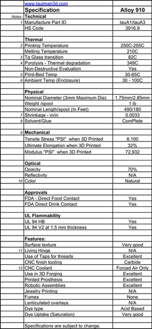

I’m to deep in to printing the parts for the 3/4" to start over and print the 1 inch. I’m printing my parts out of nylon 910 and cf petg, expensive reprint!

If it shrinks and is as flexible as what i’ve read, nylon might not be the best choice for this. I’ve never tried it so I can’t honestly comment. PLA works great and is so much cheaper.

nylon 910 is not your typical nylon, I don’t use pla for anything structural, its too brittle, I use material that will hold up long term.
PLA works great. Feel free to make it your own, but the parts were designed with PLA in mind.
