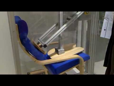

Halloween prop makers use wiper motors… I’d suggest a trip to IKEA to look at their chair cushion testers on display.

I also had IKEA on my list:
