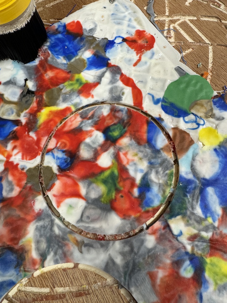

Dusted of MPCNC again for the first time in about 12 months - as have been busy 3d printing in the meantime.

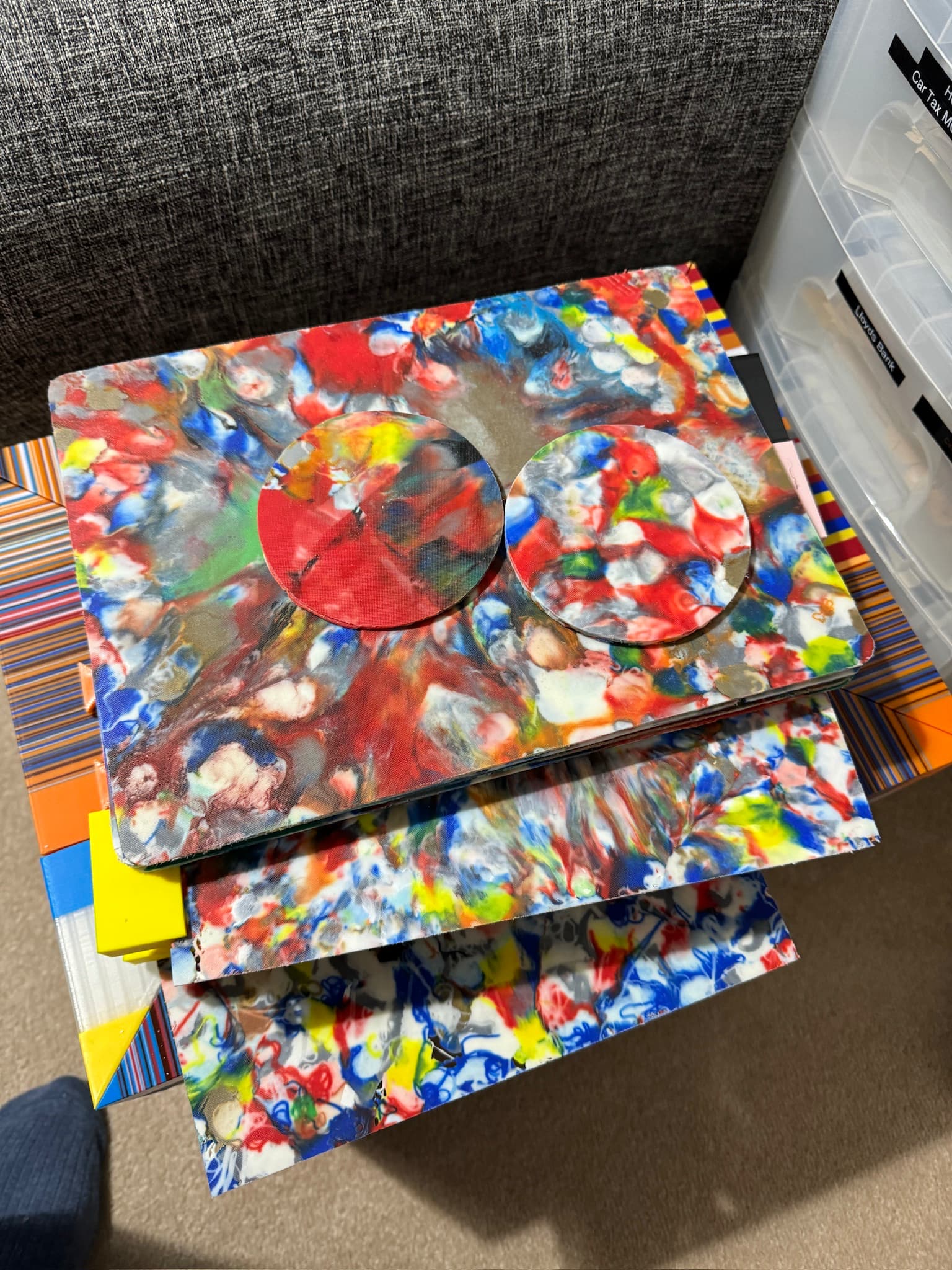

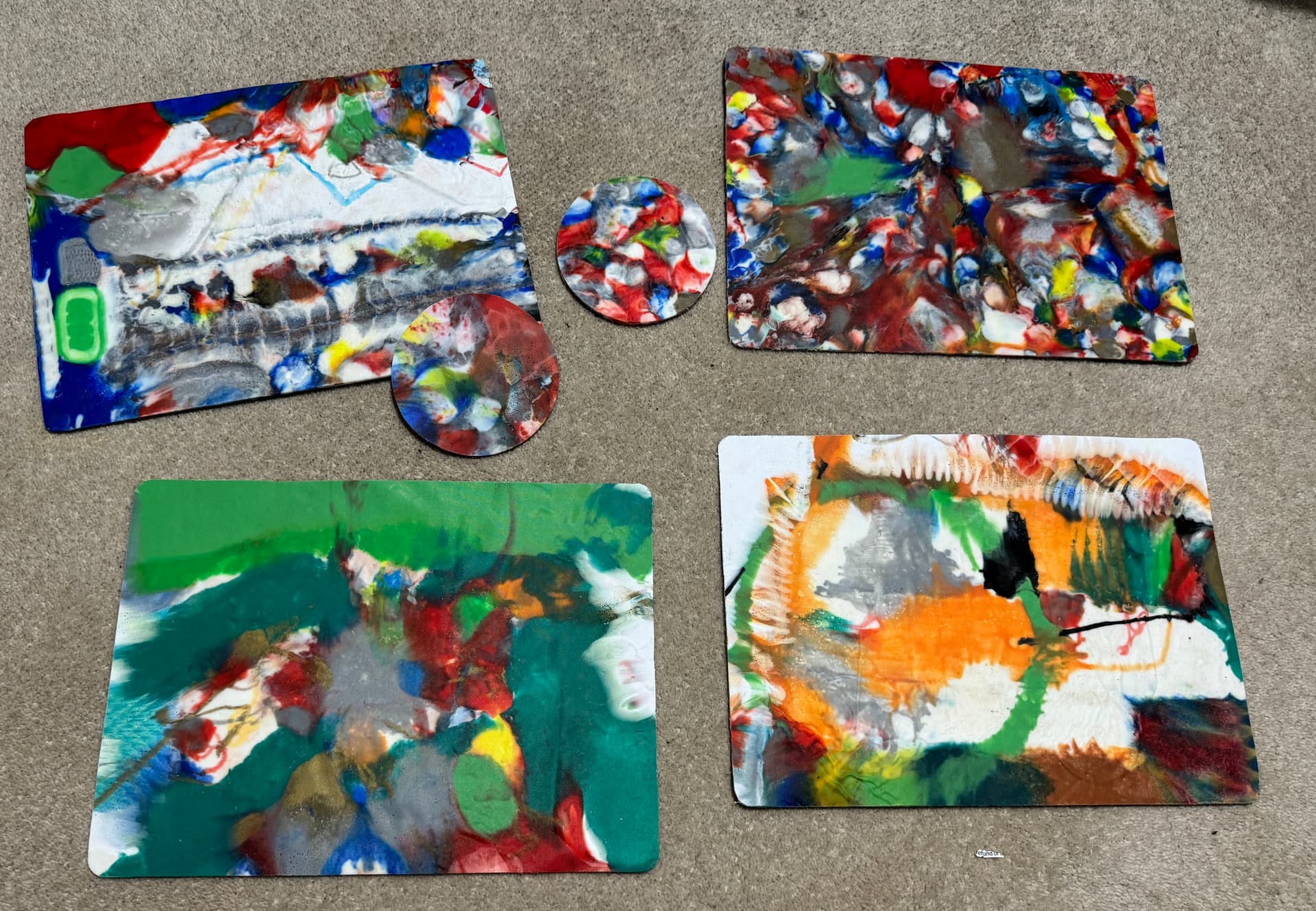

Used ‘Teaching Tech’ YouTube method of creating flat plastic sheets out of 3d printer waste to create a few very colourful flat plastic sheets - around 15 inches square and 3 - 5mm thick.
Made out of purge waste and melted (some of them fairly big) waste and failed prints - see this thread for background info on the melting process if you are interested. Making better use of Flush-into object in Bambu Studio - #51 by Ukdavewood - Bambu Lab AMS - Bambu Lab Community Forum
Quite pleased with the results - and as the parts are made out of melted plastic - the off cuts or any failed cuts can be remelted again back into full sheets for further cutting.
Also used cnc.js for the first time - using the ‘shop floor tablet interface’. - quite pleased with a little add-on I made - using javascript bookmarklets to populate the MDI fields with the GCODE I like to use - such as Home X Y and reset X Y Z - Quite simple javascript which needs to be URL encoded this with commented parts re - applied

That’s actually a really cool idea and if you play your cards right you could make some really cools signs or even inlays out of the plastic

I can smell that the plastic is melting, plus a fair number of the chips gather in the cuts partly due to melting, but the cuts clear out quite nicely once the cut goes fully through. It’s actually quite nice cutting the plastic vs wood - due to lack of mess.
I’ve been using an MPCNC Burley with around 1m x 1m build volume, cuts are using a 5mm single spline, straight cut bit, with feed rate 1500mm/s, cut depth 1mm increments, tabs almost the whole depth, the Katsu router is on setting 2.5/6 – so I am guessing around 20000rpm
