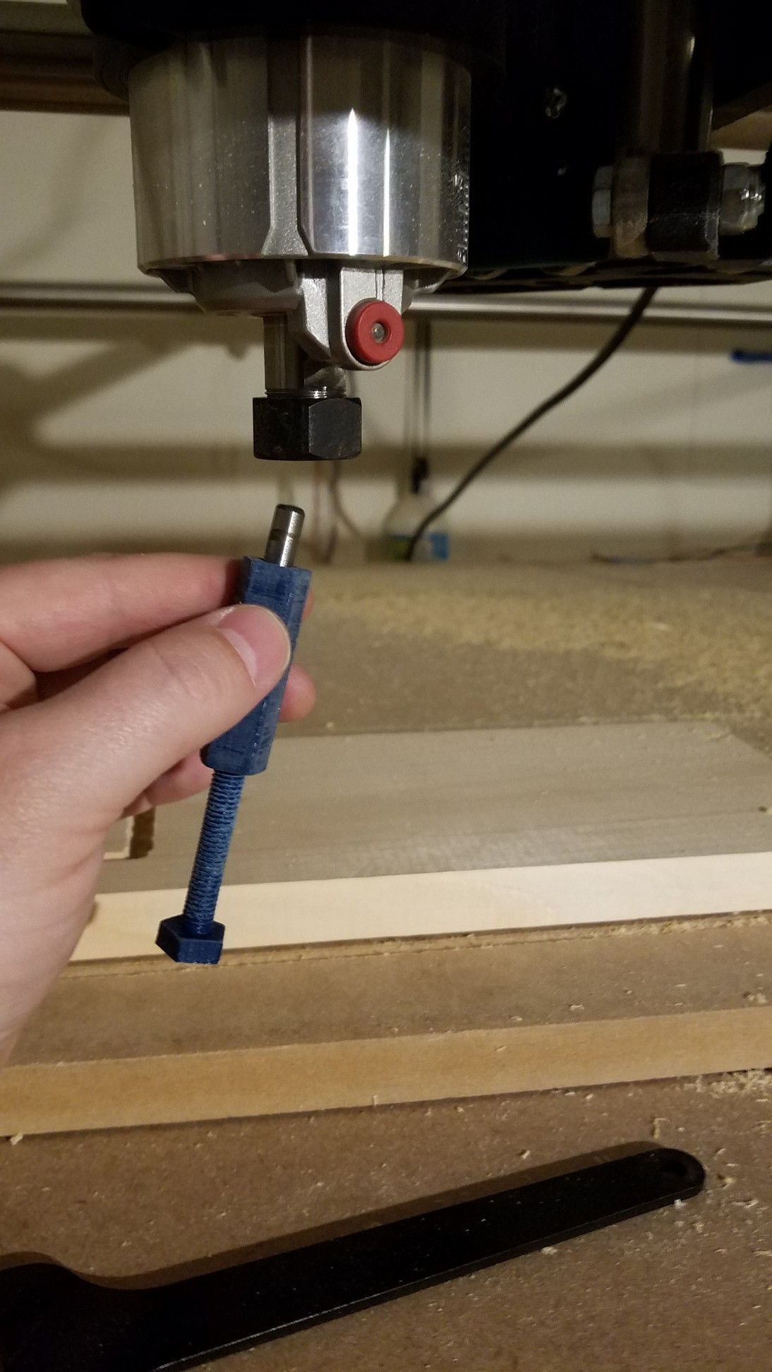

Thanks to all for sharing sharing your experience on this topic. It’s got me 99% of the way there, but I am hitting an odd issue and was wondering if anyone ran into this. I took the #4 approach from SomeOldGuyCoding’s youtube, to move to a safe place. Thank you SomeOldGuyCoding - great videos!
I also ended up making my own Jig for the bit depth. pictures below, just a nut/bolt :slight_smile:
I then set my Tool Change script to the following with an additional G0 after PAUSE
;No. 2: estl cam tosses this in
G0 Z60 ; move Z 60 mm up
G0 Y-100 ; Move Y to negative 100 (off the work piece for me)
M84 S999 ; enable steppers “forever”
M00 ; Pause for the slow human
G0 Z0 X0 Y0 ; Bring my coordinates to 0 after it starts again
I set my Z to 0 because the very next instruction is for the finishing operation brings it up to 1.5 and I wanted to watch it drop to Z0 :slight_smile:
G01 X12.7200 Y12.7200 Z1.5000 F1800 S30000 ; first finishing pass instruction
This resulted in a failure, the finishing bit was off by maybe 12-15mm and plunged into solid wood.
It feels like I’m upsetting some offsets, but I wanted to ask if Marlin will execute the above gcode as I would expect? It’s still absolute positioned, so I don’t see why it wouldn’t… Is there any reason the above would be failing? Is it possible the lack of FEED SPEEDS i’m losing steps or something? The piece cut perfectly on Roughing, and the Gantry did not move at all during tool change.
Any thoughts/things to try welcome, thanks in advance!
-Marc

Is the second tool sticking out the same amount as the first, or how do you adjust for that?
Hi SomeOldGuyCoding,
Thanks for replying!
#1 - Definitely going to try a pause after the 0 positioning. I was kicking myself that I didn’t
#2 - Ah I wish I could say. It was a bit hectic when it plunged fully into uncut wood. But based on the erroneous cut, it looks like just the Y axis
The sticking out bit is controlled by the little screw tool. In the image above is a 1/4" end mill for rough cutting… The shank side anyway! I hold it up against the colet while I screw it in.
