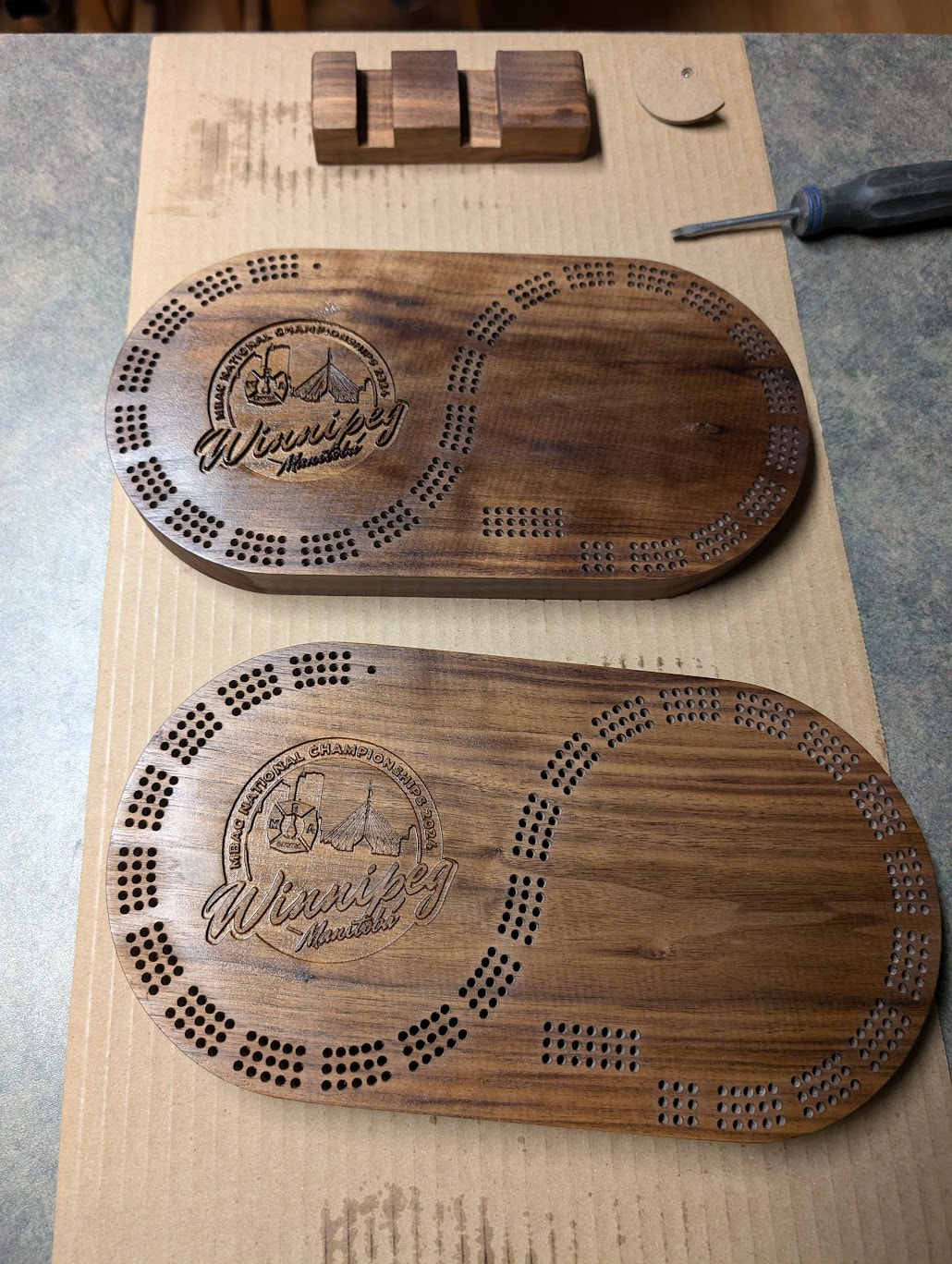

Very nice. What bit do you use to drill all of the holes? Seems like that would take a while with a standard end mill.
Just a 1/8 single flute… it does take a while…

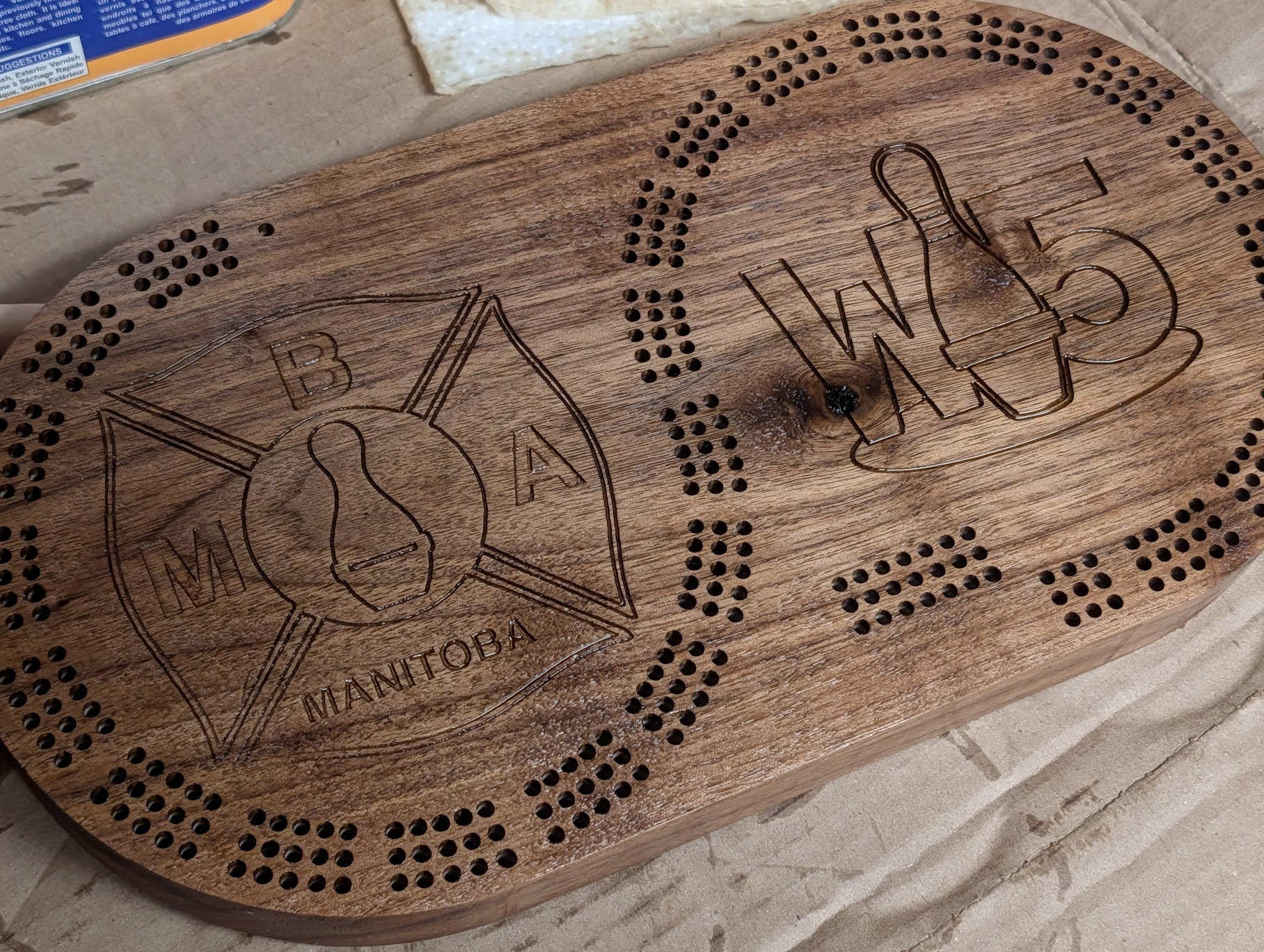

But I’d never do a cribbage board drilling by hand… there’s no way I’d be able to get over 360 holes aligned precisely. As it is with cnc, there’s always the odd hole that looks a tiny bit off because of a vibration, or stress in the wood, or something. Like this
And on occasion, mostly when there was a cracked part on the mpcnc :frowning: (but it’s happened other times too), I’d have holes blow out the holes next to them, and have to patch the wood and recut that section… those are the worst, because it’s impossible to perfectly hide the patch
