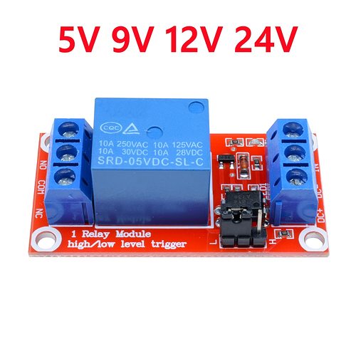

My relay has 3 terminalson one side (DC+, DC- and In) and 3 on the other side (NO, COM, NC)
I connected S to In, G to DC- and V to DC+

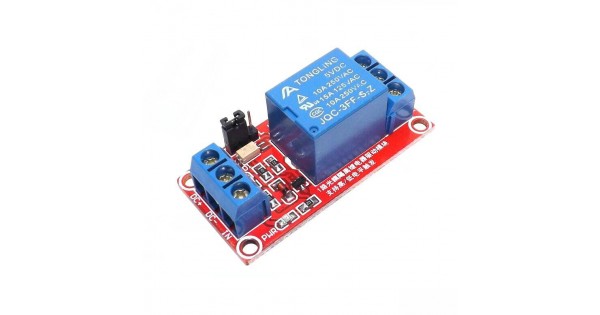

This is the relay I got:
What spindle are you using? This is only rated for a 3A inductive load.
Makita RT0700C
That router requires 6.5A I would not use that relay to switch that router on and off you are asking for somthing to burn up.
You should chose a relay rated for a 7A or greater inductive load.
I’m on 230VAC, so 3 x 230 = 690W, my router needs 800W :frowning:
This is the exact one I got… it’s rated for a 10A right?
That makes it worse at 230vac it 0robably will only handle 1.75A and I don’t have specs on the current draw of the 230v makita but I imagine it is at least 3A.
710W it says.
That one does not implicitly say, but I would guess not. That is probably a resistive load rating.
Keep in mind it’s not just about the Watt raiting. An inductive load (like a motor) has a large in rush current. So it will pull much more current then normal for the first second. In those cases you want to get a relay that is either rated for inductive equipment or buy a relay with a much larger current rating.
I guess it’s the same as the first link I posted… so probably also 1.75A. Yes I looked up inductive vs resistive loads, now I get it.
