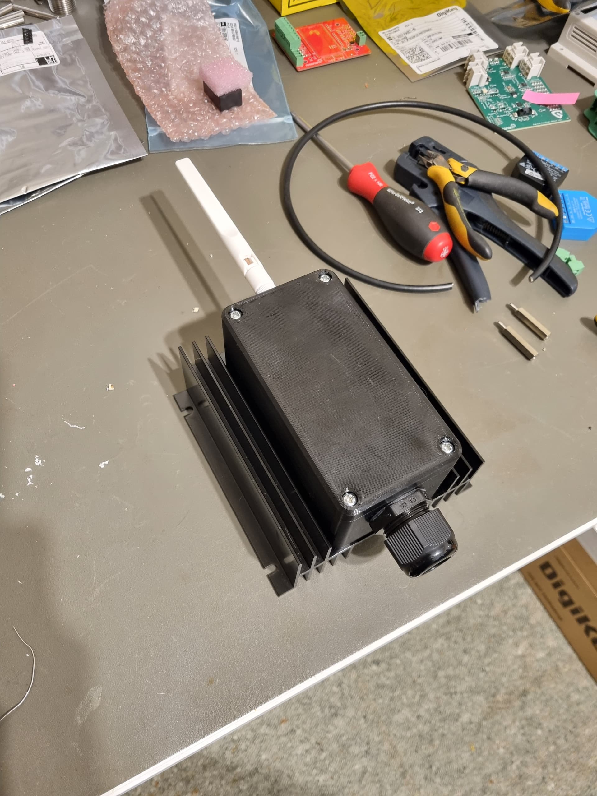

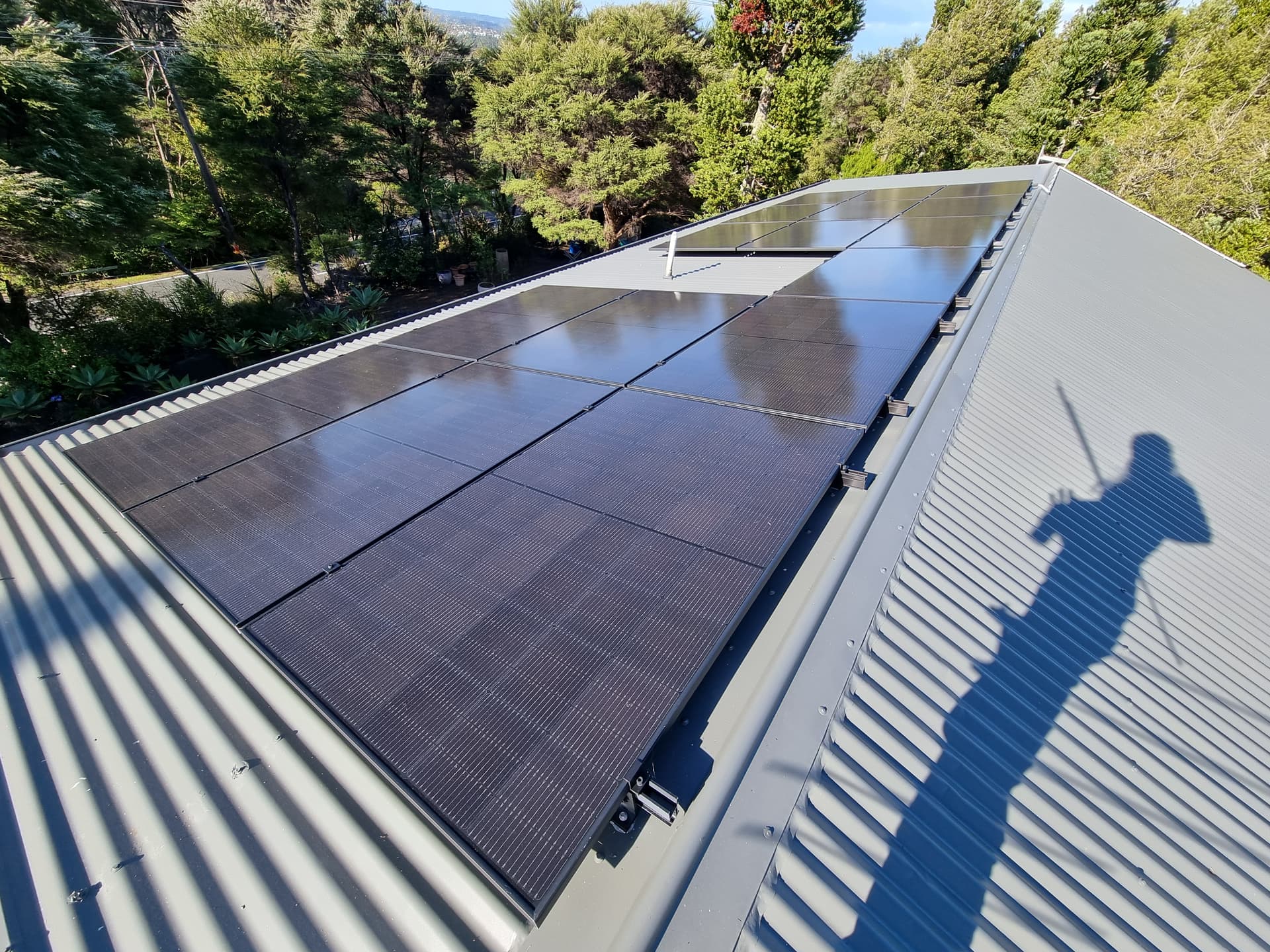

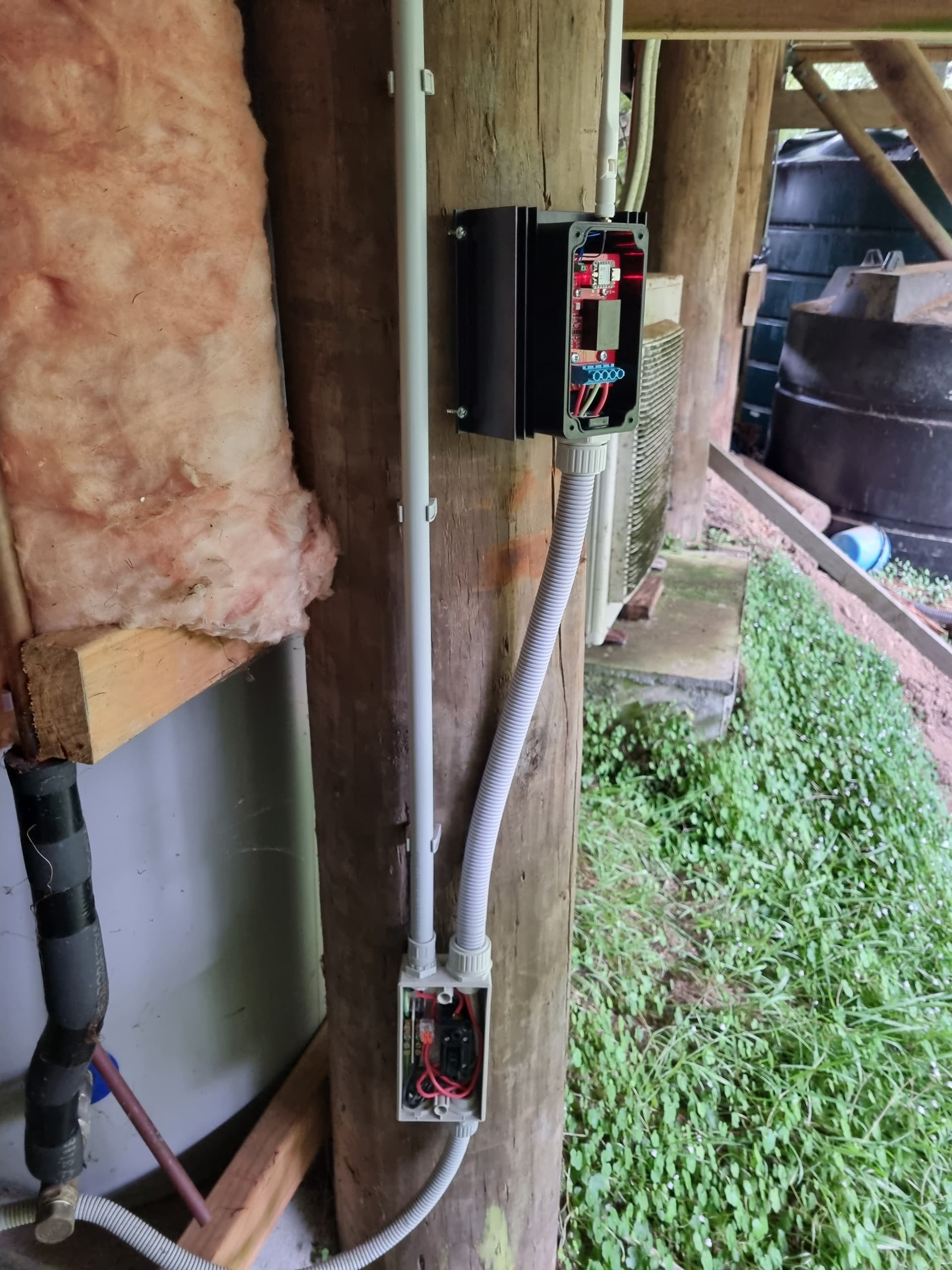

Mid last year I finally got around to having solar installed at our place. It needed a switchboard upgrade first which I had been procrastinating for a couple of years. Our system is 16x 440W panels in 2 strings on a Fronius 6kW hybrid inverter.
We have electric hot water via a 250L cylinder mounted under the house so the plan was always to figure out some method to preferentially use solar to power the hot water cylinder.

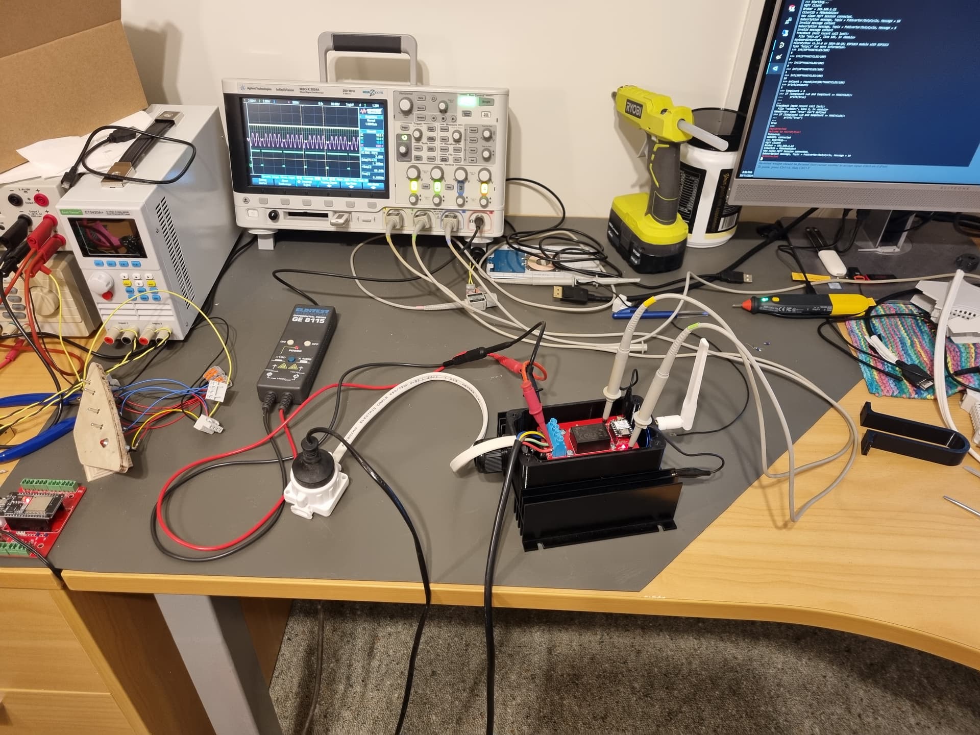

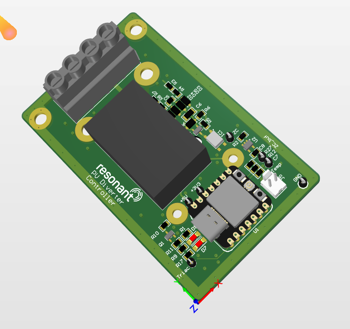

To that end I put together a basic PCB that has an ESP32, a zero-crossing detection circuit, control for an SSR and some other basic features. The ESP32 is running micropython and connects to an MQTT server to receive commands telling it what duty cycle to run. Based on the commands received, the SSR will turn on or off for a set number of half-cycles which avoids switching losses and minimizes electrical noise issues that can come from hard switched loads.
The PCB is designed to mount directly on top of the SSR via brass standoffs which provides both physical mounting and electrical connections. The SSR is mounted to its matching heat-sink for simplicity, although the entire thing is massive overkill and damn near any heatsink would work. There are also standoffs that serve to stabilize the screw terminals and also directly earth the heat-sink.
The decision logic is that my Home Assistant instance takes measurements of both the consumer mains and the power into the hot water cylinder via my whole-house energy monitoring system . It uses those to calculate what the potential export would be. It then sends a duty cycle to the PV diverter board based on that potential export. It’s pretty crude and could do with a proper closed-loop control system being implemented but the goal is ā€˜simplest idea that works well’, which I think this does.
That’s it installed under the house with some flexi conduit into the connection point for the hot water cylinder. It’s in a surprisingly solid little PETG enclosure that I printed. It’s a nice tidy looking little unit once everything is buttoned up.
Total cost was around $150 NZD all up, mostly because I went with a massive overkill SSR and the matching heatsink to make life easy.

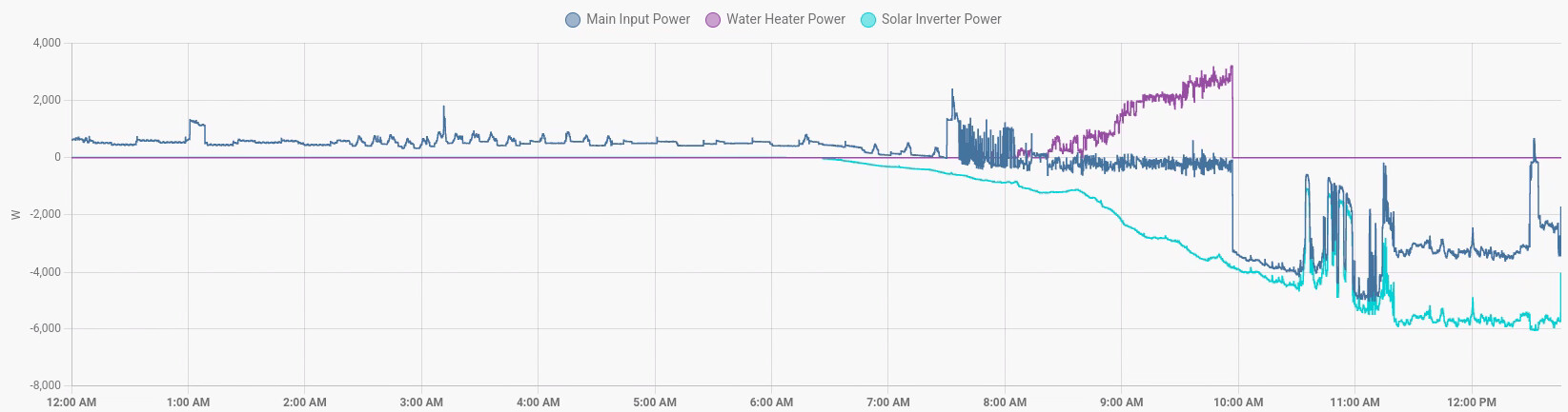

That’s this morning’s power graph showing our main input overnight, the solar starting to come on at 6:30am and then ramping in. At around 8am there’s enough solar that we start to have export so the water heater turns on and starts soaking up that excess, keeping our mains input around zero. Once the cylinder has finished its full heat cycle at around 10am the thermostat turns off the load and we start exporting . It often kicks back on again in the afternoon for an hour or so.
I’ve got an automation set up with Home Assistant to notify me if the cylinder has gone for a full 24 hour period without going above a couple hundred W and a critical notification to let me know if we’ve gone 24h without significant export, which would indicate that the cylinder hasn’t 100% heated. On the to-do list is to add temperature monitoring to the cylinder, ultimately with the goal being to get a bit more flexibility over winter and potentially trigger a heating cycle overnight on off-peak power if a low temperature threshold is reached.

No, everything is still connected exactly as normal. The feed for the house comes into the main switchboard, goes through the main switch and then gets connected to all the circuits via individual RCBOs (combination circuit breaker and residual current device, basically what the rest of the world calls the things Americans call GFCI units or whatever). The main feed and each individual subcircuit have current transformers on them which connect to an energy monitor unit that provides pretty much realtime (every ~8s) measurement of the power in each circuit with good accuracy.
So, from that system I can see instantaneously how much power is being consumed by each subcircuit, how much power is being produced by the inverter and how much power is being exported/imported from the grid.
The device I’ve made is down at the hot water cylinder just because it was convenient, it could be anywhere between that and the main switchboard easily enough. In fact in hindsight I probably should have located it with the rest of my infrastructure equipment but this way it’s obvious if I ever need to have a different electrician look at my stuff. I’m trying to be at least a little bit aware of a succession plan in the case I get hit by a bus and my fiance ends up having to find someone to remove all the BS I’ve done.
So all the device really does is act a bit like a form of dimmer switch, just that instead of turning the load on/off for parts of half cycles, it does entire half cycles less often. Testing it on a lamp was horrifying, it’s basically a 5Hz strobe, which is truly awful. At the moment I have a control resolution of about 10% power, with each 10% being another cycle active out of 10 cycles. 10% power is one cycle on, 9 cycles off. 50% power is 5 cycles on, 5 cycles off, etc.
So to follow the logic of the system, say the house starts out with no solar and background loads of around 1kW. My energy monitor sees 1kW coming in and a total of 1kW going out to all the different loads. Home assistant sees that 1kW import and says ā€˜ok, no export so no need to turn anything on’.
Then the sun comes up and the solar system starts producing 1kW of power. The energy monitor will see 0kW of power on the main feed, -1kW of load from the inverter and then 1kW total going out to all the different loads. Home assistant will see 0kW import/export and go ā€˜ok, no export, no need to turn anything on’.
Then the sun gets higher and the solar system starts producing 2kW of power. The energy monitor will see -1kW of power going on the main feed (1kW of export), -2kW from the inverter and 1kW total going to all the different loads. Home assistant will see -1 kW and go ā€˜ok, there’s 1kW of export, I should turn something on’. I have the power of the element hard coded so HA just says 1kW export divided by 3kW element power = 33%. Round that down to the nearest 10% and set the target how water cylinder control to 30% duty cycle. That then gets sent out via MQTT and seen by the PV diverter that will go ā€˜ok, on for 3 cycles, off for 7 cycles’.
When the next set of measurements comes in, assuming the sun is still in the same spot, the solar system is still producing 2kW of power. The energy monitor will see 0kW of power going on the main feed, -2kW from the inverter and 2kW going to all the different loads, one of which is the hot water cylinder with its 1kW of load. HA sees that 0kW on the main feed and if it were only reacting to that, it would say ā€˜oh no, no export, quick, turn off the hot water cylinder’ and it’d sit there and oscillate on and off. So instead I make a synthetic measurement which is the power on the main feed minus the load from the hot water cylinder. So in this case, even though there’s no power going out on the mains, the 0kW on the main feed minus the 1kW of load in the hot water cylinder gives us 1kW of ā€˜potential’ export, which is what I use as the control variable. Based on that, HA goes ok, 1kW of potential export means 30% duty cycle still and keeps the control variable the same.
Then say another load pops up and draws an additional 500W, we’ve then got 0.5kW coming in the main feed, -2kW on the inverter, 1kW on the hot water cylinder and 1.5kW on all the other loads. HA would see that ā€˜potential’ export as 0.5kW - 1kW = 0.5kW and turn the duty cycle down to 15%, which gets rounded to 10%.
Once the water is fully heated then the thermostat shuts off and no matter what the PV diverter does, the load will be zero and the excess will be exported.
I don’t aim for ā€˜perfect’ balance because so far I’ve always got excess and I don’t actually care if I’m at 0W or -500W while the hot water cylinder is heating. There are other systems out there that do this as full closed loop control and will perfectly zero it out in real-time, but they’re more like $1.5-2k to get installed and if I can get 90% there with $150 spent then I think that’s a better bet. Considering that we use around 1500kWh a year heating water, that’s $375 if we only heat it on-peak, $225 if we only heat it off-peak and $127 if we heat only using solar (the opportunity cost of not exporting that same energy). So if I do nothing, it’s about halfway between the on-peak and off-peak costs. If I spend $50 and add a simple timer I can get to that $225 so that’s my starting point. If I can spend $150 and save $100 a year, that’s glorious. If I have to spend $2k to save $100 a year, that can piss right off. That would all be a lot different if I were using 10x as much hot water (big family, teenagers etc.) or had other heating loads like a spa pool, but we’re relative low-use on that axis.
Hopefully that answers the question? Basically there’s no ā€˜interception’, it’s more like having a water tank that can be filled by the inverter or the main grid and drained by the loads. If you have too much power from the inverter, the tank fills until it’s overflowing back onto the grid. If you have too little power from the inverter it drains until it needs to be topped up from the grid. By watching the water level in the tank I can keep it in the middle by varying the outflow to something that doesn’t really care about the flow rate (like watering a garden, say), only that it gets ā€˜enough’ during the day.
