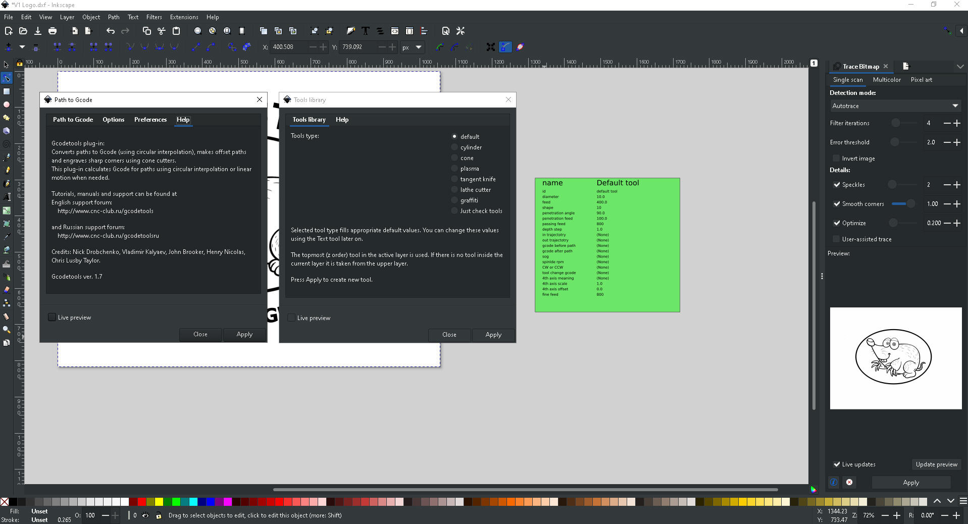

Haven’t played with it much, so I can’t speak to it’s usability, but Inkscape has an extension called Gcodetools.
  • Al
Gcode tools is super basic.
You can make your SVG or DXF in inkscape and then do your CAM in ESTLCAM.
Inkscape is fine for 2d work, and it can even produce files for some cam packages that can control 3d work by using colors to encode depth. Generally I use f360 for most 3D stuff, and Inkscape to make svg files for lightburn for 2d laser cuts. On a rare occasion I use an svg in f360 for 2d milling in place of the laser.
It is not common that i need a 3D model for the CNC inkscape and estlcam are a great combination.
