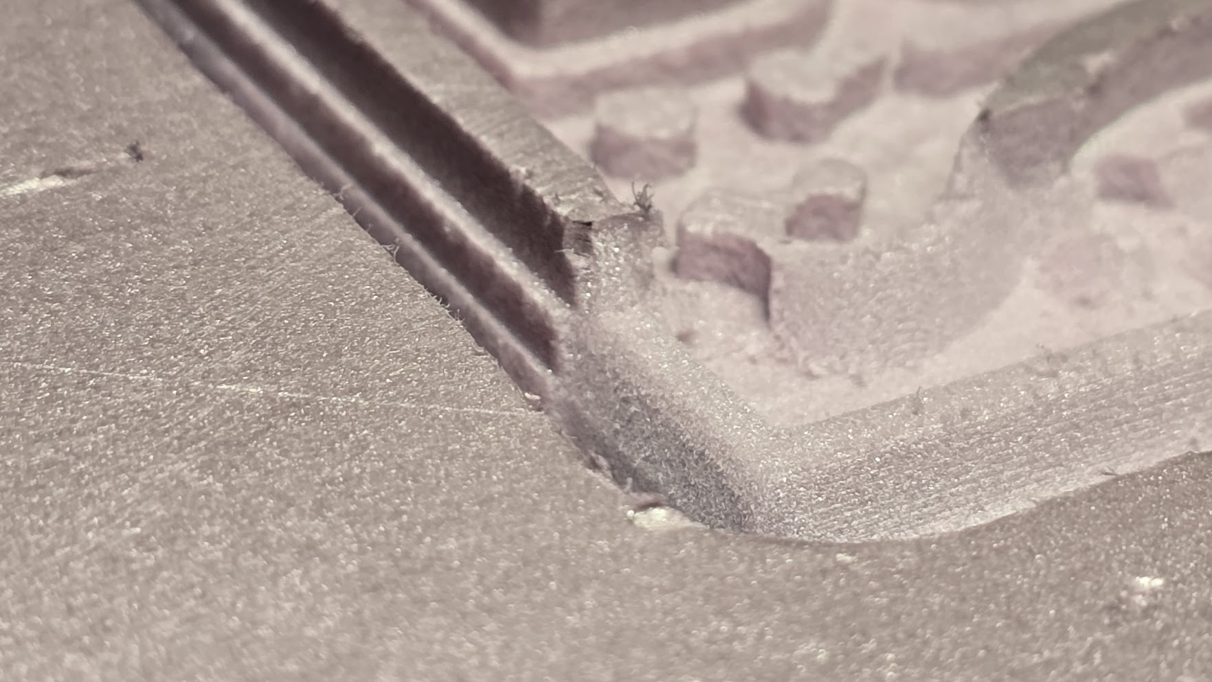

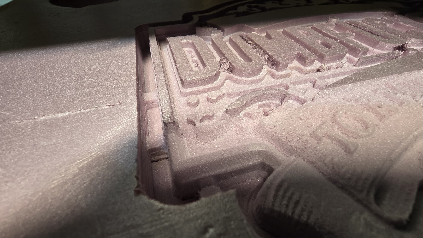

Why is my roughing pass leaving so much material for my finishing pass?
Is it leaving more than. The .5mm allowance with a #2.5 to 3mm stopover?

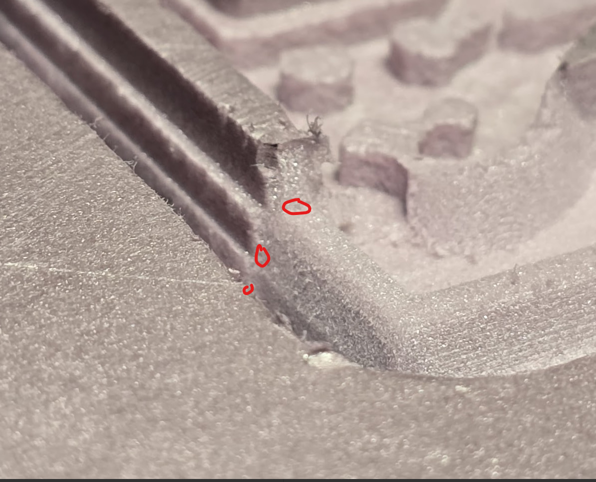

yeah its in the pics. the amount left on the Z is nuts.
You are using two different tools. I suspect the first tool has a large stepdown, that is leaving 0.5mm at some part of that path. I bet if you play with a smaller stepdown it will give a little finer resolution on where to leave material.
I bet these three spots are at 0.5mm.
Smaller first tool stepdown and just move faster to compensate for lost time.

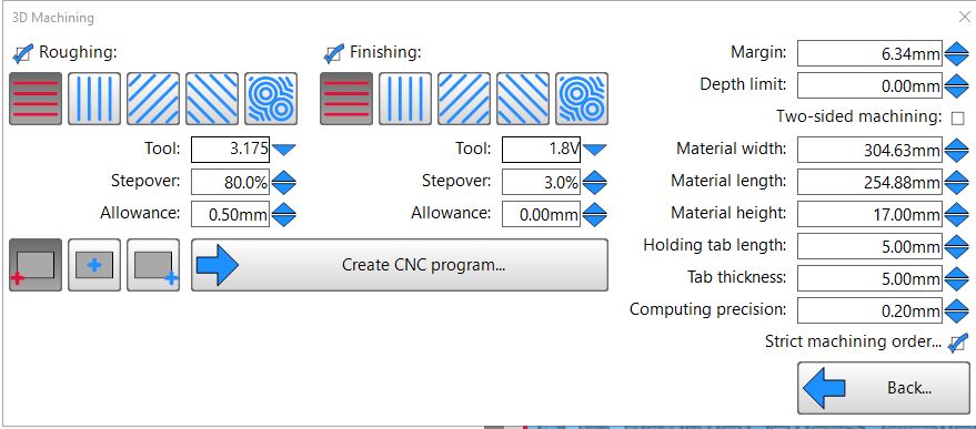

I was at pretty basic settings. what would you recommend? also I cant 100% guarantee these were the settings on my cut because I upgraded estlcam and uninstalled the old one without backing up my settings. Genius move right?
I don’t carve very much to have solid suggestions and it changes drastically with each type.
In the end the finishing pass with a tiny step over probably does not care much about all the extra material.
You can do half the step-down at twice the feedrate, and keep the finishing settings. That might have much less roughing left over. You can also try waterline instead of parallel for roughing.
