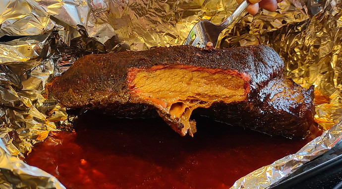

BTW, here is the brisket from a few days ago. Remainder stashed in the freezer for now. Yup, I used the Texas Crutch. :slight_smile:

Sorry to say it. But I just licked my screen. MAN that’s a pretty brisket. Smoke ring is on point too! Save all that juice and make au jus!!! I love to pour that stuff on a loaded baked potato, or a roast beef sammich.
I still have a little saved in the freezer, waiting for the right meal to bring it up a notch. I also did Salmon that week and I’m down to only one or two pieces left. Time to fire the smoker back up! :slight_smile:
