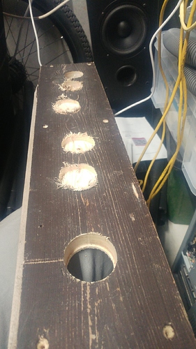

Slowest UK MPCNC build, South Manchester, in the Shed on Lavington Avenue
Those are speed holes!
this wasnt a time for cnc, i have daily meetings where my phone is overheating and killing its battery and my machine would have taken alot longer to do this i think. Maybe Maybe not. I think it would have taken me and my machine longer than me and my pillar drill.
Absolutely. I was making an obscure reference to the simpsons:
Speed holes, I like it.

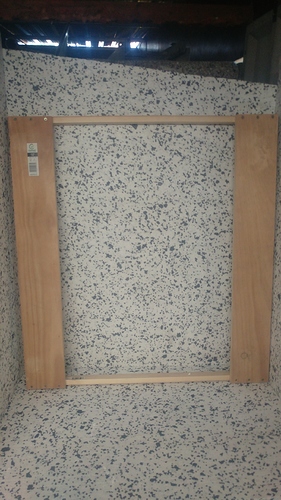

this was the outer frame that previously sat on the Ikea table i designed it for. unfortunately it is pine and not ply so it has warped in the heat inside my garage which has a metal roof. This was i think the major but not only source of my out of level bed. I have decided that I am going to just screw direct into the Ikea table. It’s not in great condition but it is flat and i will not be planning to use it again as a dinning table, we have since bought a much nicer one on the wife’s orders.

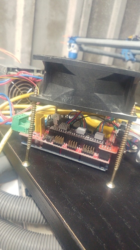

The current state of the Lavington avenue CNC. Note the server PSU repurposed for driving the ramps board.

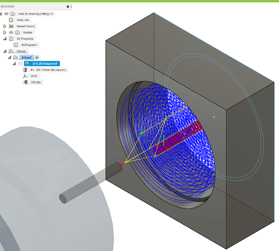

Learnt lots today, i decided to play around again in fusion 360 as its where i design all my plastic printed things and it would be good to be able to go straight from there rather than estlcam simply because making hybrid parts which are composed of both additive and deletive? processes would be far simpler.
Anyway at first i looked into feeds and speed for wood and getting the mill tool setup. then i looked at the post process part which gave me an nc file, then i spent a chunk of time looking into nc to gcode converters and used one on github palinhob which was written in python. This was far too simple and not really upto the task as all it does is parse the lines and puts in g0 g1 and f* on each line and doesnt take out stuff thats not marlin specific. I looked again on google and had better google foo this time as i found martindb’s contribution which is a cps file (a fusion post processor file) so you can just export straight to gcode.
I also upgraded my cooling solution with is a 12v 1amp server fan running full tilt. (need to drop the V with a few zenners or add a real speed controller.
Anyway i learnt abit more todo with creating better looking tool paths and i like the simulate tool in fusion better. Ive run a few of the passes without the router running and with now material in the way just to check that the post processor isnt making the mpcnc behave badly but it seems ok so far.

this was the fusion simulation which is nicer by far than the estlcam view. Estlcam is good for simple but i would have to be far more organised keeping track of the files.
argh, so the hole is too small. by a full 5% the small diameter should fit the 39 mm of the plastic tube but its milled to only 37mm (cant be much more precise than that as i need new batteries for the vernier calipers)

This is my nth attempt now at creating a hole with a small lip inside to catch the profile of the plastic legs i have left over from my garage shelving.
I found the fusion 2d circular cut which for my geometry is the same as a contour. I split the job us into 3 lots of gcode.
1 a straight down central 20mm doc drill
2 a 15mm doc 41mm contour
3 flip the work and recentre the bit on the hole created in 1 as best i could and do a 5mm doc 39mm hole
conclusion. this thing is getting borderline useful. btw i say that we the me at the helm, i think with a seasoned pro this machine will be very useful.
just cutting the contour beats the hell out of trying to cut the whole thing out in 2d adaptive pocket creating a shit ton of shaving each time.
you can see from the part which came out my reposition of the bit over the hole wasnt perfect.
from a test fit of the plastic leg the 39mm is loose but good enough the 41mm is a smidgen to tight. easy to fix.
