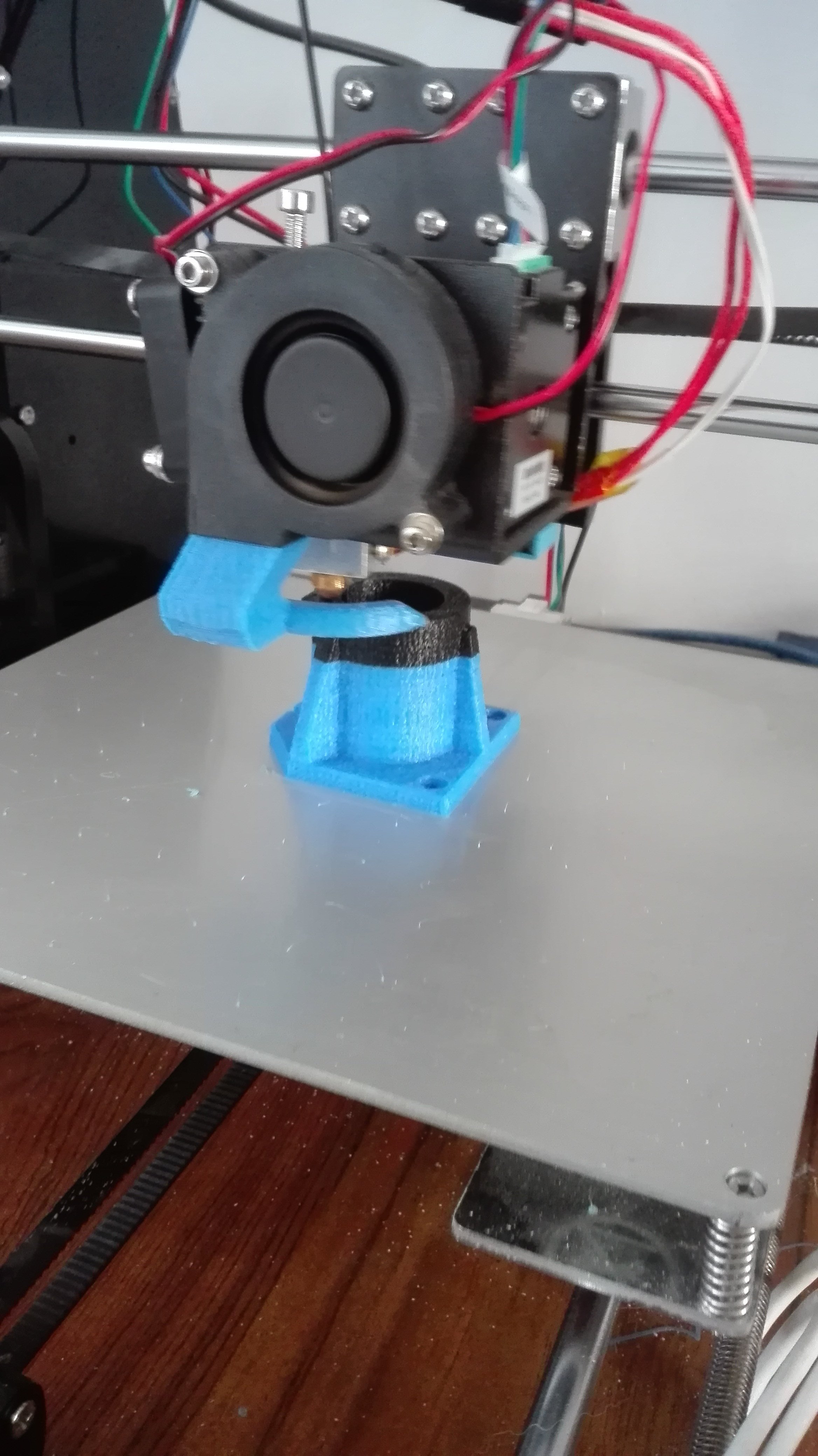

So reprinted the top rear twice and front one once so now I have two top mounts as I originally designed it to have. Through over tightening the rear bracket piece snapped. The new parts are in black pla since I ran out of the original blue. I actually ran out part way through printing the last of the four legs but managed to manually swap the filament mid print pausing my anet a8 and it worked fine. I upped the speed on the mounts to 150 which was 3 times the 50 it was at for the mckeller mount parts here and my printer appeared to cope. There were more imperfections but liveable for what it needs to do. I had a disaster though when I came to place it back into the centre gantry, the bottom bracket part snapped on the right hand side so that the right bottom rail guard only has three bearings attach now. I tried to glue it back but I think the epoxy I have doesn’t work on PLA. Will just reprint the part but really slow and max fill.

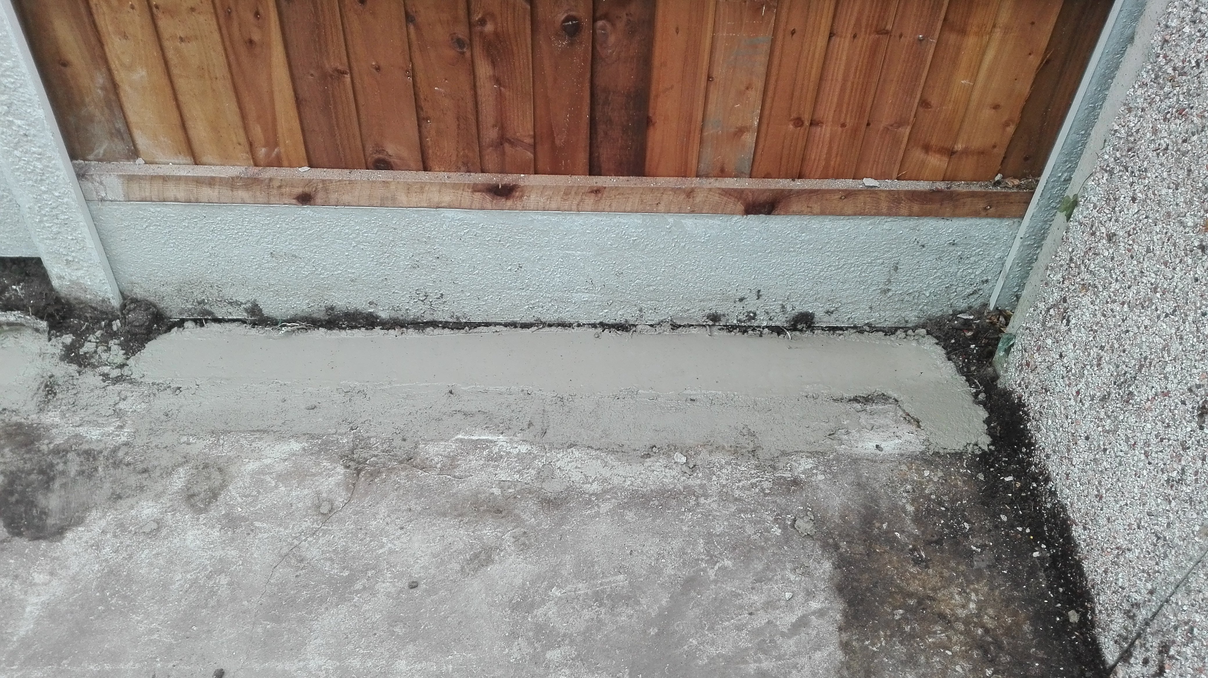

In other news I am making sure my 3Dprinter and MPCNC has a proper home in the form of a garden office. Took a couple of days off and dug a hole and poured some concrete for the foundations. Here is my dog helping dig and the result so far.

Hi,
From what I see on the pictures, you clearly have a major extrusion issue.
My guess it that your nozzle is partially clogged.
You should take it apart and clean it, hopefully it will solve your problem.
Other tip: superglue works perfect to fix broken PLA parts.
you may well be right on the extruder. I am just coping with it at the moment since its dialled in right for the autoleveling, I have a e3d hotend clone which I intend to swap in soon and external mosfets to allow the hotbed 24v to heat quicker. And I intend to do a Bowden extruder as well but since its mostly working I’m just making sure I finish all the parts for the mpcnc first. Will try again with super glue too. the stuff I used is good for acrylic but I think it makes the PLA weak. I might have ruined it already with my first botched rescue attempt. Will give it ago but its not a massive hardship to reprint it.
My printer really needs a bit of tlc but time and apathy when it mostly works is really self defeating.
tried super glue (cheap knockoff) didnt work, going to print slow tonight, i have 40mm/s and higher infill dialed in so hopefully i will have a stronger piece this time. dont really want to tear down my anet a8 printer just yet to clean it up. I have a replacement nozzle i can use maybe i should do that at the least.
well I reprinted the lower part of the middle assembly in black, printer calibration was way off so consequently it lifted at the back while printing and may be a bit out but the print completed and it fit together okay so its all back together again in my temporary office in the house. After that i did recalibrate my printer properly. I designed a box for my dcdc bst900 which i use to charge my electric emax scooter. That print was pretty good, no lifting and a good first layer. Will start improving the printer with the e3d hotend and external mosfets for the bed and hotend and use a 24v supply. just need to print all the required bracketry for it and maybe buy a different inductive sensor since the mounting of the cylindrical ones is easier to calibrate and fit.
I moved the concrete walls for my new external office on to its foundations, I am a couple of weekends work from having a permanent 24/7 runnable location/final resting place for the mpcnc, till then im a little less than committed in finishing it as i cant run it in anger till i have the office outside done anyway. There is a little person in the house im am not allowed to wake with my projects.

Did some CAD work in fusion to work out how to use the old sectional concrete with the existing garage. There is a visible raise where the new foundation is poured so you can tell what is old and new just by looking at the step up in the wall nearer the back.
