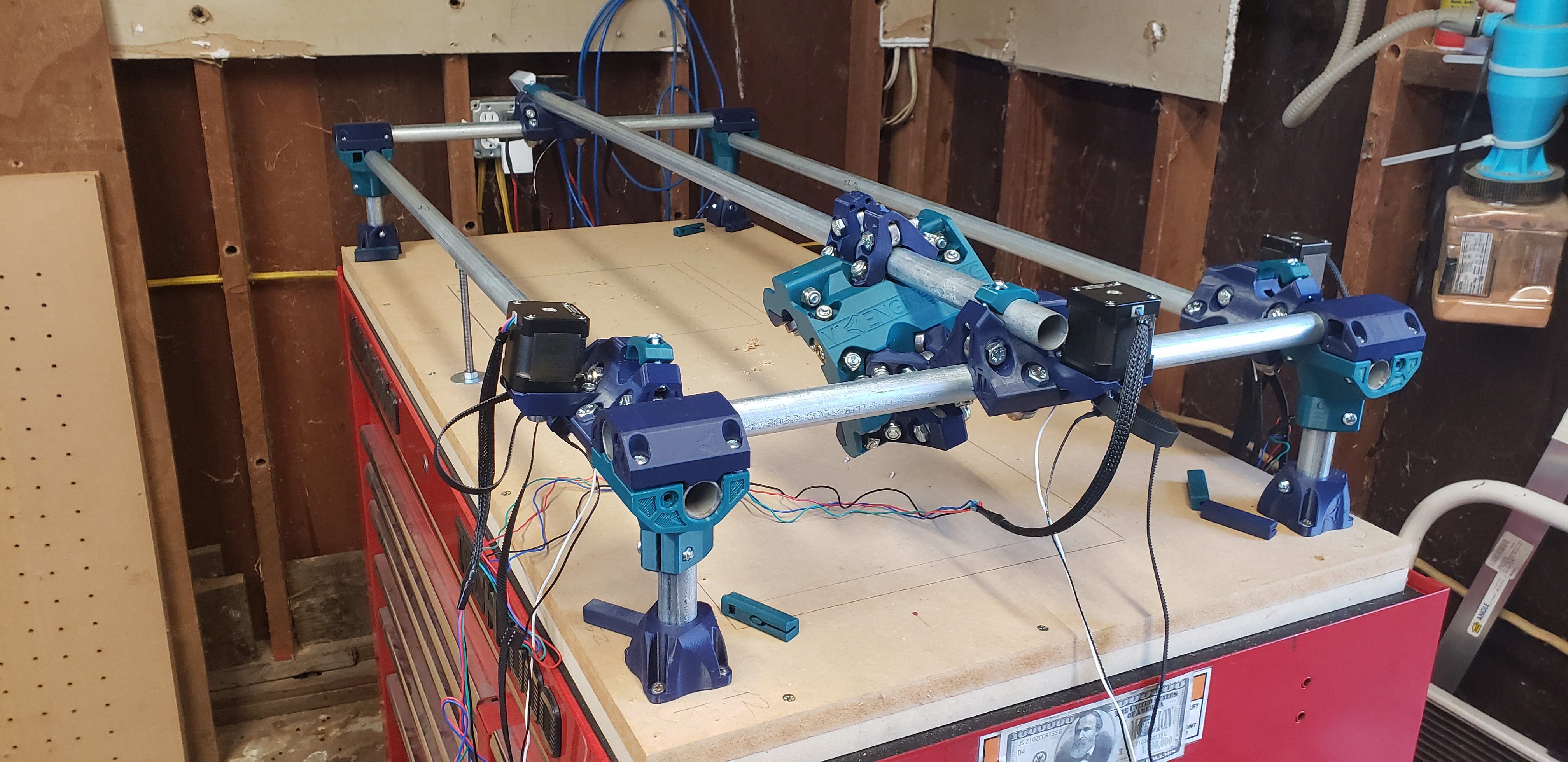

Just started printing the updated Primo files and ordered a upgrade kit from Ryan. I figured I would start a thread for the upgrade. I have been very busy so I suspect this will be a slow upgrade but I intend to finish it and make some cool stuff. Again thanks Ryan!
Edit: Had a few failures for different reasons but still printing. I had a fail on one truck the ran out of filament half through the replacement for the failed one. :man_facepalming:Added some print pictures!
20201020_002918|690x335
Take your time, enjoy it!
Made some more progress. I got to where I was installing the core when I realized I placed the rails wrong for it to have a left front 0,0. Is there any reason having the 0,0 on the front right is a problem? I know I can set it up in cam but other than that, problems?
If you are wiring it in series it does not matter, if you are using dual endstops it needs to be fixed so the switches are where they need to be.
Dang I’m using end stops. I guess I’ll be tearing down partially. Thanks Ryan.

Did a little more today. Mounted the electronic control box and started drilling out the connector holes.
Opinion on where I should put the estop?
Wherever you can get to it the fastest :wink:
What size conduit did you use? 1 inch?
I used the standard EMT 3/4 conduit. Kinda wish I had upgraded to the stainless steel pipe but I had got excited about Primo and started printing without thinking about upgrading. That being said I haven’t had issues with the conduit. Didn’t even have mid span support before.
