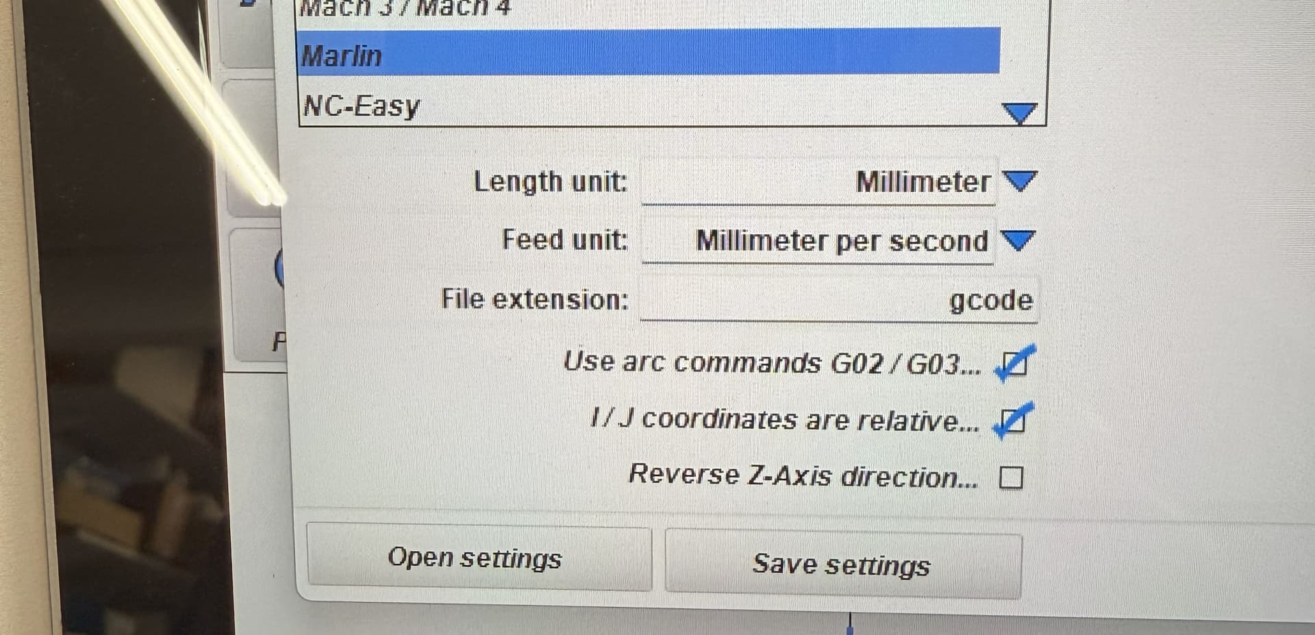

I’m trying to get an instrument panel out and my set up isn’t working the way it used to.
I have it plunging into the panel and making small holes. The rapids are fine, but the plunge and XY is lower than it used to be.
Here is a copy of the first hole:

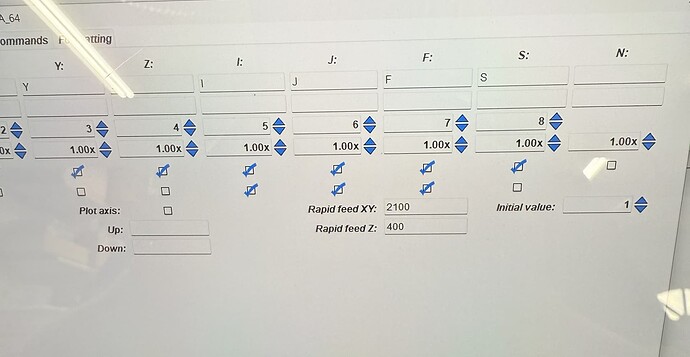

And settings:

Uh… yeah, that’s pretty much glacial. That plunge of 2.5mm (previous move in Z was to 0.5mm) will take 30 seconds. Somewhere youve told your CAM to plunge at 5mm/minute.
There it is. In the F(z) column. Estlcam thinks you are using mm/s, but the Gcode is jn mm/minute. Under Setup | CNC Programs, change the “Feed Unit” to mm/minute.
Thanks @SupraGuy !
I thought I had set them all according to the Docs, but I missed that one.
Mike
