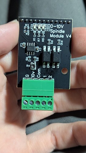

Today (while I am down with the flu) my 0-10v spindle module showed up. this means I need to figure out the config for it. I have seen a couple posts referring to it, but nothing really on final product.
I’m running a 52mm air cooled, 800watt spindle.
as I grow, I want to move to VFD, but this should be fine.

You can get the config edit for that module from the 0-10v module in the spindle section of the fluidnc wiki
Just be aware that the Jackpot uses different GPIOs on the expansion connector compared to Bart’s 6-pack board, so the GPIO numbers will need to change from the example that FluidNC wiki has.
Thank both of you! I hadn’t searched fluidNC wiki yet! I had just been scouring the forums and perusing Google results.
thanks for the info on the gpio was different, there are 2 different 0-10v boards I found on tindie, both were linked to the 6-pack, so I was figuring I may have that issue, thank you for confirming that!
with this info plus the fluidnc wiki, I should be able to cobble a functional config.

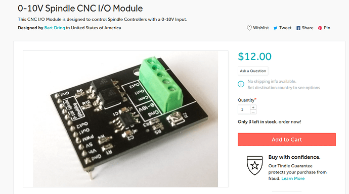

A note: you should get the modules directly from Bart’s page in the tindie store, he have a better margin on them and it helps support the fluidnc team (i guess he have royalties baked into the other supplier )
Oh, one other thing. ORDER NOW!
Due to the craziness with global trade at the moment, Bart has announced he’s shutting down the Tindie store.
Do you know if his products will remain available via Elecrow?
He said it likely would remain available that way. I just threw a new topic on the forum about that, we can continue this discussion there.
I will definitely remember to do that, better margins= happier designers = more happy designs!

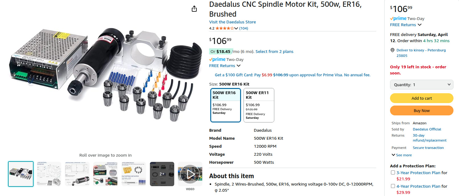

here is the exact el-cheapo spindle i bought
my goal in this was to throw together a capeable cnc for as cheap and quick and scale-able, I’m no pro and dabble in everything, I tend to skip steps, as I have zero patience for fluff while in work mode and have other major projects I want to mess with at the same time (maybe I can expand on those later in the random area) but here we are.

You should look about the reviews, the runout on those are horrible.
You can get a nice 800w spindle wirh a vfd for about 60-100 usd more. (Aircooled and rs485 capable)
AliExpress link
118+64(shipping to the us) you will need the shielded power cable (its not included)

The 0-10V module you have is the non-isolated version so it needs 3 GPIOs to configure; Jackpot has 4 available on the expansion connector.
The only limitation with that is there are not enough free UARTS/GPIOs availalable to use a FluidDial pendant with that in the system. Note though, that isn’t a big limitation because using a pendant and a spindle in the same system is an advanced project and there are other options for pendants shaping up. (if you even wanted a pendant at all- completely not necessary with FluidNC web interface)
