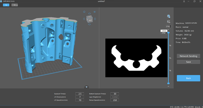

SLA resin vs. PLA
I’ll probably be using an SLA printer to make the parts. I noticed the only mention of material is PLA.
Would a resin serve as an acceptable material for the CNC machine?

So in theory, with the right resin, it should work. Do you have an SLA printer big enough to print the MPCNC parts? The core is pretty big.
I have both types of printers. I printed a universal mount on my Anycubic Mono X using Sirayatech resin… I looked great, hole lined up perfectly, tool mount slid into it perfectly… When I mounted it and went to tight up the screws that clamp the tool holder to the universal mount, I heard cracking. Now I’m not a heavy handed person by any stretch. I’ve been a field service tech for over 30 years, and have an excellent ‘feel’ for how tight to tighten screws down in plastic! :wink: Bottom line it, I believe that most resins are just too brittle for use on the MPCNC. I’ve not tried the more exotic (Read: Expensive) resins, but things are changing all the time with new resins being introduced all the time. I’d be surprised if someone doesn’t come out with a fantastic resin with all the properties we’d like to see in the next 5 years or so, but right now, I don’t think there’s a solid choice.

It’ll fit on a Saturn.
Not sure how you’d cure it though. The geometry makes spots you can’t drain unless you put a bunch of holes on the sides. Even if you slice it solid, I don’t think it will cure more than a few millimeters into the sides. This’ll cause cracking after a while.
I wouldn’t use resin as it is quite brittle, it will be likely to crack and break.

I’ve been mixing Siraya Tech Tenacious 50/50 with great results. Makes it not so brittle and much less likely to crack or break even when you drop the part.
