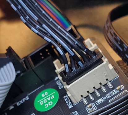

New Build here. I am building LowRider CNC with the SKR Pro. The photograph in the SKR Pro instructions shows the black 5 pin connector installed with the small dashed wire closer to the center of the board. The Connector is keyed. The cable I have has the connector OPPOSITE of the picture, such that the short grey dashed wire is closer to the outside edge of the board. Is there a change to the board, or is the cable wired backwards?

What does the other side of that cable look like?
It’s wired backwards too. So the single wire is the “Key” My cable, the single wire is the 50% duty cycle dashed line, vs the shortest dashed line. So I just need to be sure the single wire is in the correct place, and the rest of them will be lined up.
Yes, my wire arrived backwards from the picture as well, but the connections were correct. The symbols don’t matter, just that the correct pin on one end goes to the correct pin on the other end.
