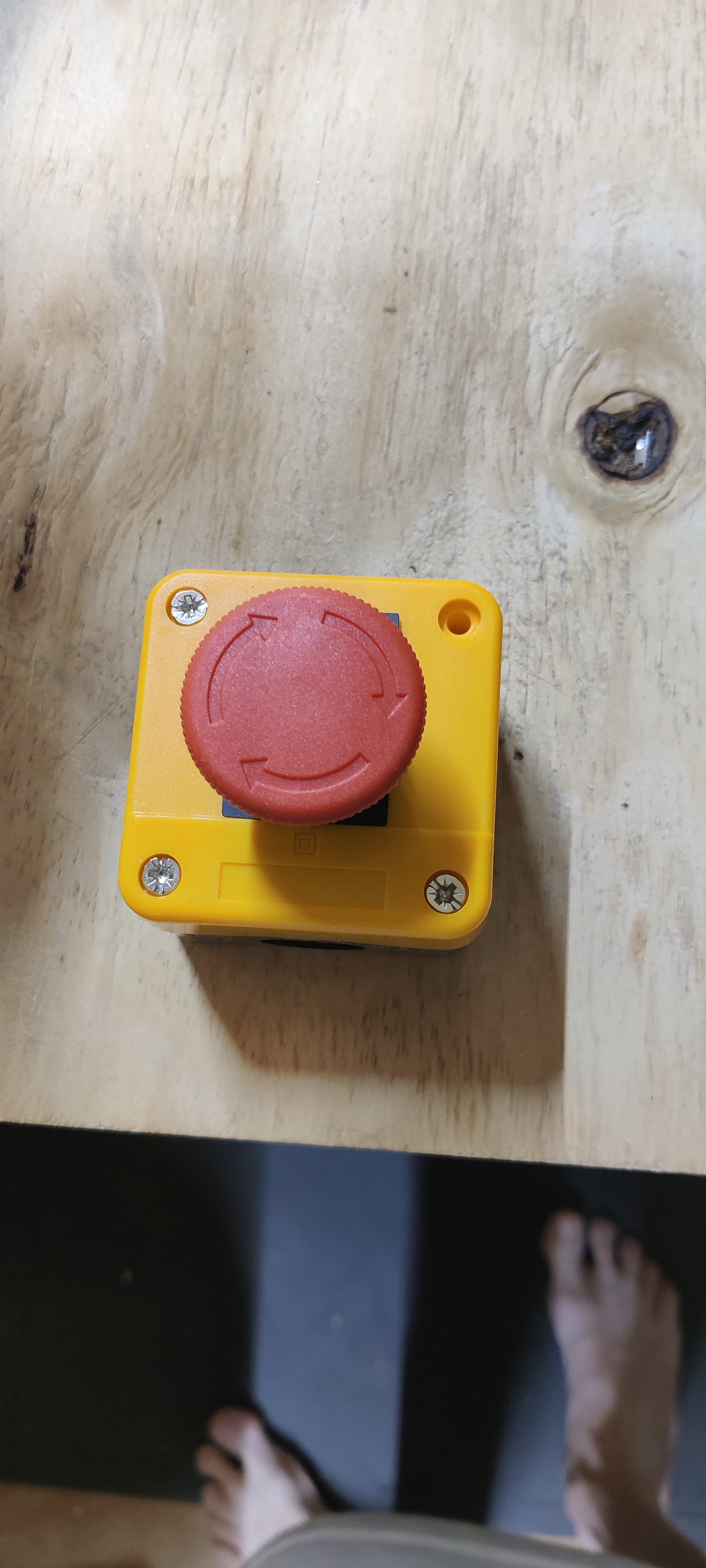

Skr pro v1.2 board plugin location for emergency stop button
for my lr3 i need to know if the skr pro v1.2 board location to plug in an emergency stop im not talking about wiring to ac im talking about same ting in btt 3 e3 tft firmware feature of touch screen emergency stop a mechanical stop is more quicker than fumbling with touchscreen

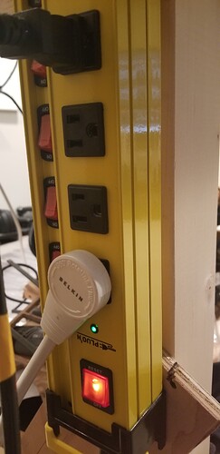

Something as simple as a power bar with an ON/OFF switch is effective
its about the same function as the software emerency stop on tft screen its quicker than cutting power off it takes 5 secs for the mainboard to power off which is not quick enough to stop the x y movement
so ac method power off is out of question
Am using multi switch power outlet, am able to plug and separately switch Vac, Compressor and other stuff… Has a master oh crap switch, it’s slightly slower to trigger than a push emergency stop though.

Wiring the switch to the 24v input to the drivers is a kill switch not an EPO. This is what I use in addition to a full system power switch and recommend this for quick instant movement stop. It doesnt kill power to the raspberry pi or the router like the main power switch will.

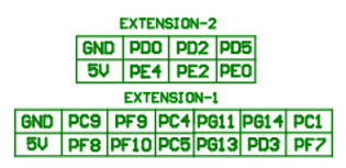

Ah I see … Documentation wasn’t quite clear on that hmmmm so pin 41 refers to what pin on skr pro v1.2 board?
You will have to pick a free pin and replace the 41 with that pin. You can find a pinout diagram for the SKR Pro here.
Most of the pins on Extension-1 and Extension-2 are free.
Pin PC9 is the designated pin for a laser. I believe all the rest are free. For example you can use PF9.
#define FREEZE_PIN PF9

I assume you will connect your switch between your chosen pin (PF9 in my example above), and ground. You can use any ground pin on your board for the ground connection including the one next to PC9. There is no polarity, so it doesn’t matter which end of the switch is connected to what pin.
The “#define FREEZE_STATE LOW” indicates the freeze will fire when the pin goes low. I haven’t looked at the code specifically, but typically the designated pin will be pulled high by the firmware. Then the firmware monitors the pin looking for it to go low. You make it go low by connecting that pin to a ground pin.
