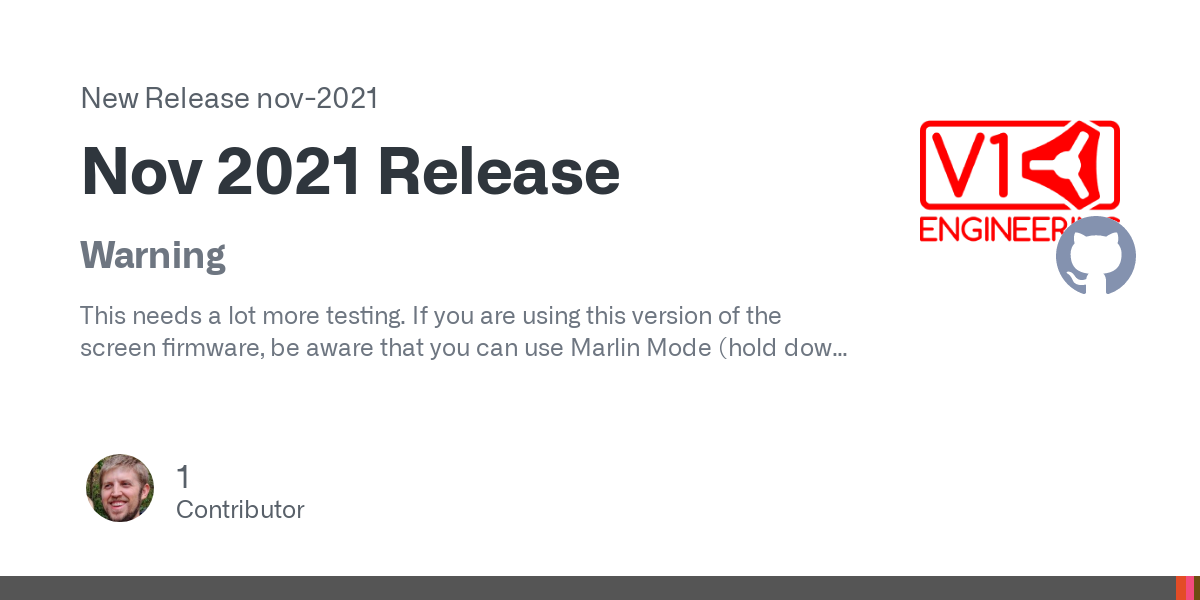

I quickly updated the TFT using the latest firmware, and did few tests.
Look like the problem is…
GONE!
I will need to test some more as it was rush-rush, but 4 boots equals 4 times normal operating speed during travel. So atm it looks like a rare bug in the TFT firmware that has been solved.
did you use the latest forked for mpcnc or from the Bigtreetch original? link would be nice :blush:
Hello, sure I downloaded this one:

TFT mode did. After TFT update to @jeffeb3 newest version on GitHub it looks like it is gone.
Maybe it has something to do with the SKR Pro version (I have 1.2), or combo with the display,
Maybe it has something to do with travel direction: @Kip travels same direction as me after boot,
Now, since you originally had this issue, I might advice you to update to the newest version too?
To see if it makes any difference for you.

My guess is that in Marlin mode, during a print, the knob changes the feedrate. When the touch screen is jogging, it is sending G1 commands to move the machine. Marlin thinks this is a job/print.
The bug is that the screen is sending Marlin the encoder pulses and sending gcode at the same time.
Marlin sees the gcode coming and the knob turning, so it assumes the user is trying to print and adjust the feedrate.
