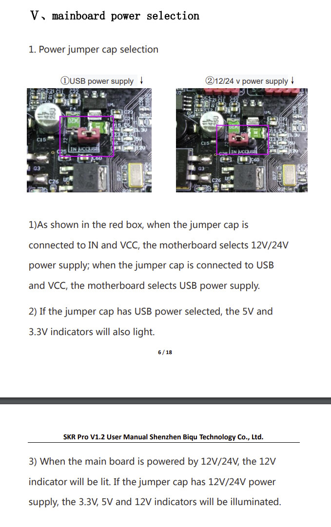

When I plug in my SKR Pro v1.2 to USB, only the red light right beside the USB Port comes on. Nothing else. Windows doesn’t even make the lil’ chime when you plug in new hardware. Am I missing something? Or is this going to turn into an Amazon Return ticket? I’m only trying to put the V1 firmware on, nothing is hooked up. MicroSD has the firmware.bin on it, formatted in fat32 (30gb MicroSD Card)

Nevermind, I figured it out. My jumper from the factory was set to VCC, and that wasn’t doing anything while I was trying to power it with USB lol…

I was just about to post this screen shot below from a section of the SKR Pro manual. I’ll leave it for anyone who searches and finds your topic:
Glad you got it fixed. If you identified the right firmware, and if the firmware was renamed after your flash, you are golden.
It was actually your suggestion on another thread that made me check it! I did it and it lit up like a christmas tree!

And you will want to swap the jumpers back when you hook it up to 12V.
