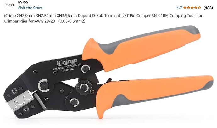

You’ll also need a crimper. There are many choices, from cheap and nearly worthless to professional grade. The reason is that there are actually two crimps needed on each wire… one on the wire and one on the insulation. Typically the crimper will try to do both at once. With a good crimper, this will work pretty well.
However, there is another crimper that allows you to do each crimp individually. This one is actually more versatile since it allows you to do both jst and dupont connectors (and even some types of spade connectors).
Now, some photos to complete this story. It should be noted that there are many options. These are the ones i have found to be successful.
One of the kits of JST connectors.
Ratcheting double crimper for JST connectors.
Single crimper for many sizes.
