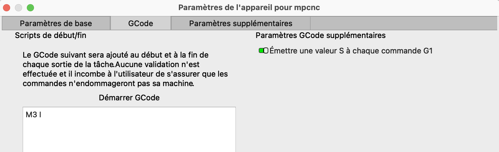

I found the parameter, but is not working, I haven’t the S on my G1 command.
What are you using to generate the g-code?
There are three different ways you can drive your laser:
  • Use M3/M5 to turn the laser on and off. The V1 firmware as configured will work just fine with these commands, but you will get a lower quality result from your laser work.
  • Use inline commands. The V1 firmware as configured will work with inline commands. Whatever tool you are using to generate your g-code must be capable of generating inline commands, and, as Dan stated, you need the “M3 I” at the top of the file. Inline commands produce, by far, the best leaser cutting and engraving results.
  • Use M106/M107 commands. Using these commands will require you to reconfigure the firmware. M106/M107 commands are designed to turn fan pins on and off. To make it work for PC9, you will need to define PC9 as the fan pin in the firmware. M106/M107 will produce the lowest quality results of the three methods.
I highly recommend Lightburn as your tool for generating your laser g-code. In order to use inline commands, you need to have this setting configured for inline commands:
Edit: Your screen shot appears to be Lightburn. I didn’t recognize it at first due to the different language. The setting above is under Basic Settings, and sometimes the dialog/window needs to be resized for it to appear (bug in Lightburn). In addition, you must have set up the device as Marlin. The setting does not appear for GRBL devices.

And I don’t have the laser Control Commands option, I don’t know why.
Thanks
Sorry for the slow response. I’ve seen two reasons why the laser control commands do not appear:
  • There is a bug in some versions of Lightburn on some displays where the dialog needs to be
    resized bigger before the commands appear.
  • These controls only appear if you’ve set up the device as Marlin. They don’t appear for GRBL.
No problem, Yes is I work as Marlin machine, I can see inline mode
