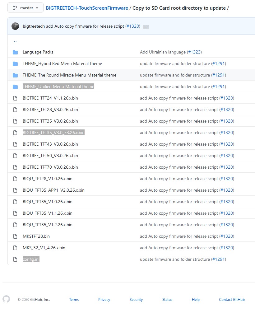

Im trying to figure this out without asking too many dump questions… I found this guide to updating the Screen, is this what I have to do?
I guess if that is correct, then I will only need to do is change the speed, which of course I have no idea how to do.
They make is seem hard.
Copy this whole folder as is, and the two files shown to the SD card on the screen and reboot.
You can change the baud rate one the screen itself after the flash or you can edit that ini file before you flash.

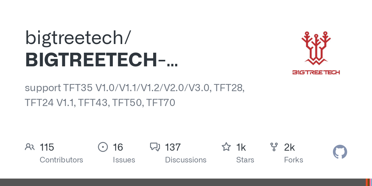

Guys, I’ve been dealing with the same thing on my GTR with a tft35. I noted that in Marlin mode, everything works perfectly, and only in touch mode does it freeze. I also observed other problems, like random “too long extrusion prevented” and also some garbled pop up messages. The garbled messages pointed my sniffer to the serial cable. The stock tft35 comes with a cable that has jst on one side, duponts on the other, yet all BTT boards use jst for the tft, lol. So needless to say those connectors are barely hanging on and easily could be the issue (movement causes vibes that then create issues… no issues when not moving and communicating at same time). I did see an issue on the BTT github where other folks had the same problem, and a better shielded cable/ferrite fixed it.
I have crimpers and jst terms coming in a couple days, and plan to make a good cable with some cat6 stp and ferrite I have laying around. If that doesn’t work I’ll report back here. Of course my point of mentioning this, is if you have issues with random weird behavior/freezing when printing using touch mode, you may want to try a new cable and ferrite.
