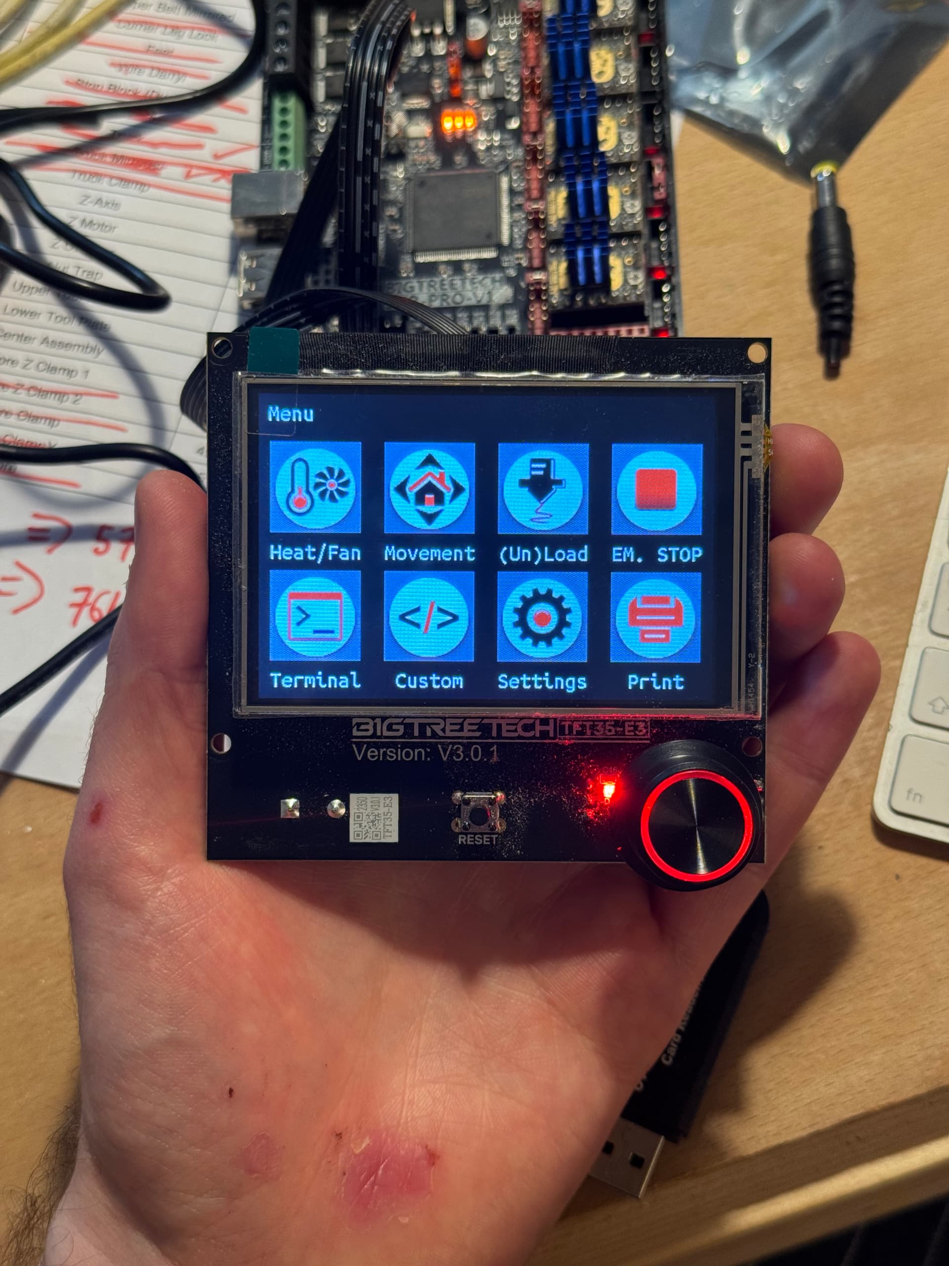

I flashed the latest CNC-TFT firmware to my TFT and it looks very 3D printer focused and can’t find options like Reset All Axis. Marlin mode is working as usual. It was from the V1 githuib and has the V1E boot logo etc.
What my Touch Mode looks like.

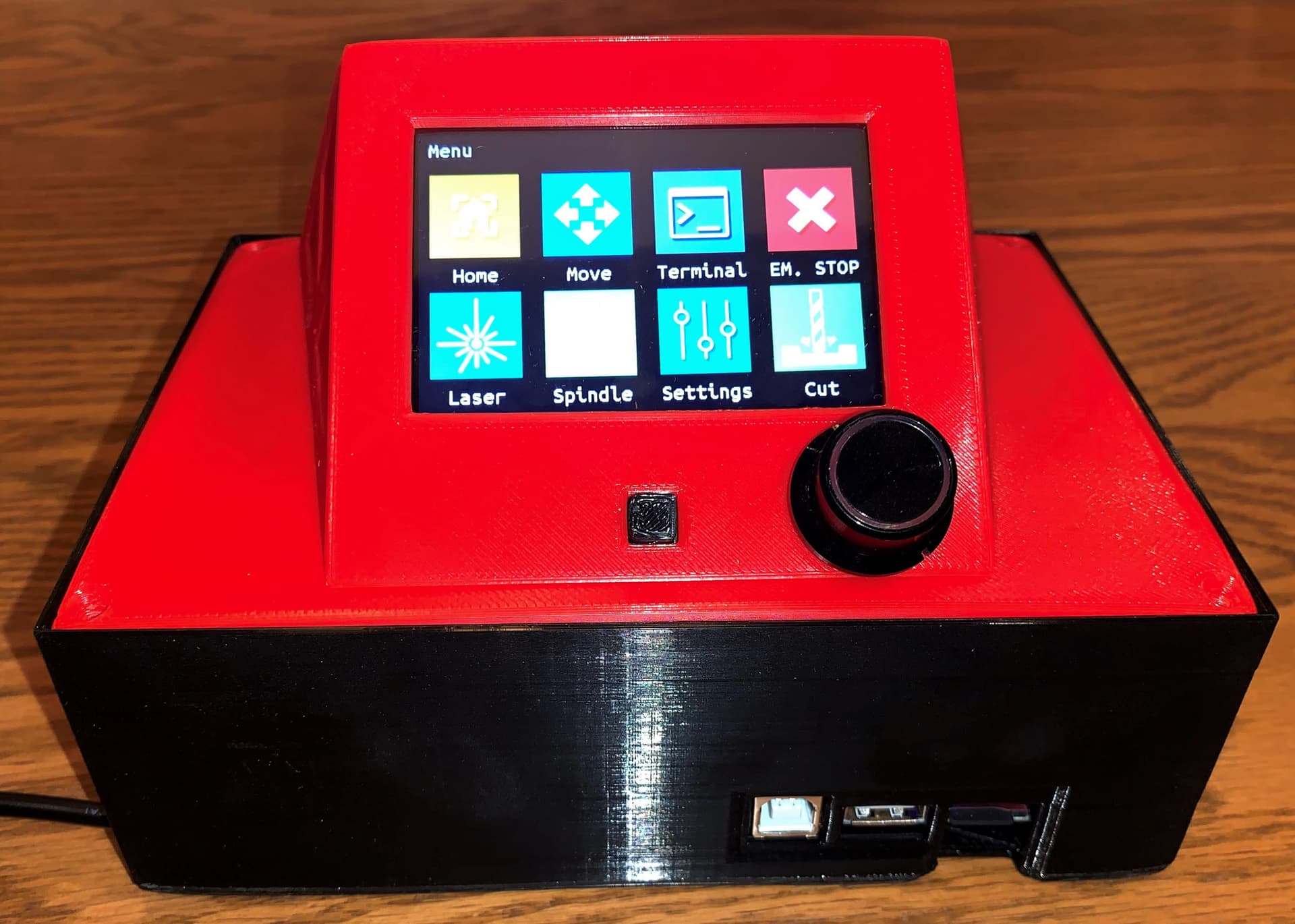

I was expecting something more like this below

I think that is a custom TFT screen that was configured for a much earlier version of the BTT screen firmware. Custom screens were abandoned a few years ago due to the difficulty of maintaining the screen over frequent firmware upgrades.
The screen you have is a standard 3D printer screen, but it still works fine for CNC (although not as convenient as the custom version)
Do you mean Home All Axis? That is in the MOVEMENT - HOME screen (HOME will do all three axis, or HOME X, HOME Y, and HOME Z will do each axis individually.
I meant the Custom command to set all axis to 0,0,0.
