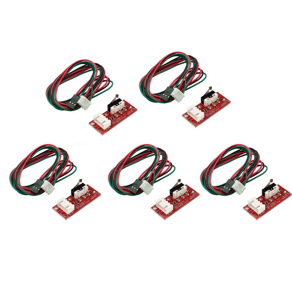

hi, i have a problem that i can’t understand … i connected these switches you have limit switches (if i didn’t misunderstand your firmware should already be configured to accept them.) but when the contact closes repeiterhost freezes and i have to disconnect everything and restart the program to make it work … what am I wrong?
https://images-na.ssl-images-amazon.com/images/I/61p05z4clrL.SL1000.jpg
Those switches are usually wired wrong. But if you are having connection problems, they are probably very wrong. I suspect you are shorting 5V to ground.
The bare switches, without the little pcb have fewer issues.
Those are 3 wire switches, like @jeffeb3 said, you probably have them wired wrong and are shorting 5v. The switches I’ve used are normally open (NO) and when triggered they just ground a floating pin, no power is ran through them.
I haven’t had good luck trying to use those circuit boards in NC situations - the 3 wire circuit activates an led when the switch is tripped which messes with trying to reverse the logic of the switch on the board.
I have had good luck cutting the switches off and connecting them direct without the PCBs by wiring the C and NC terminals to ground and signal respectively.

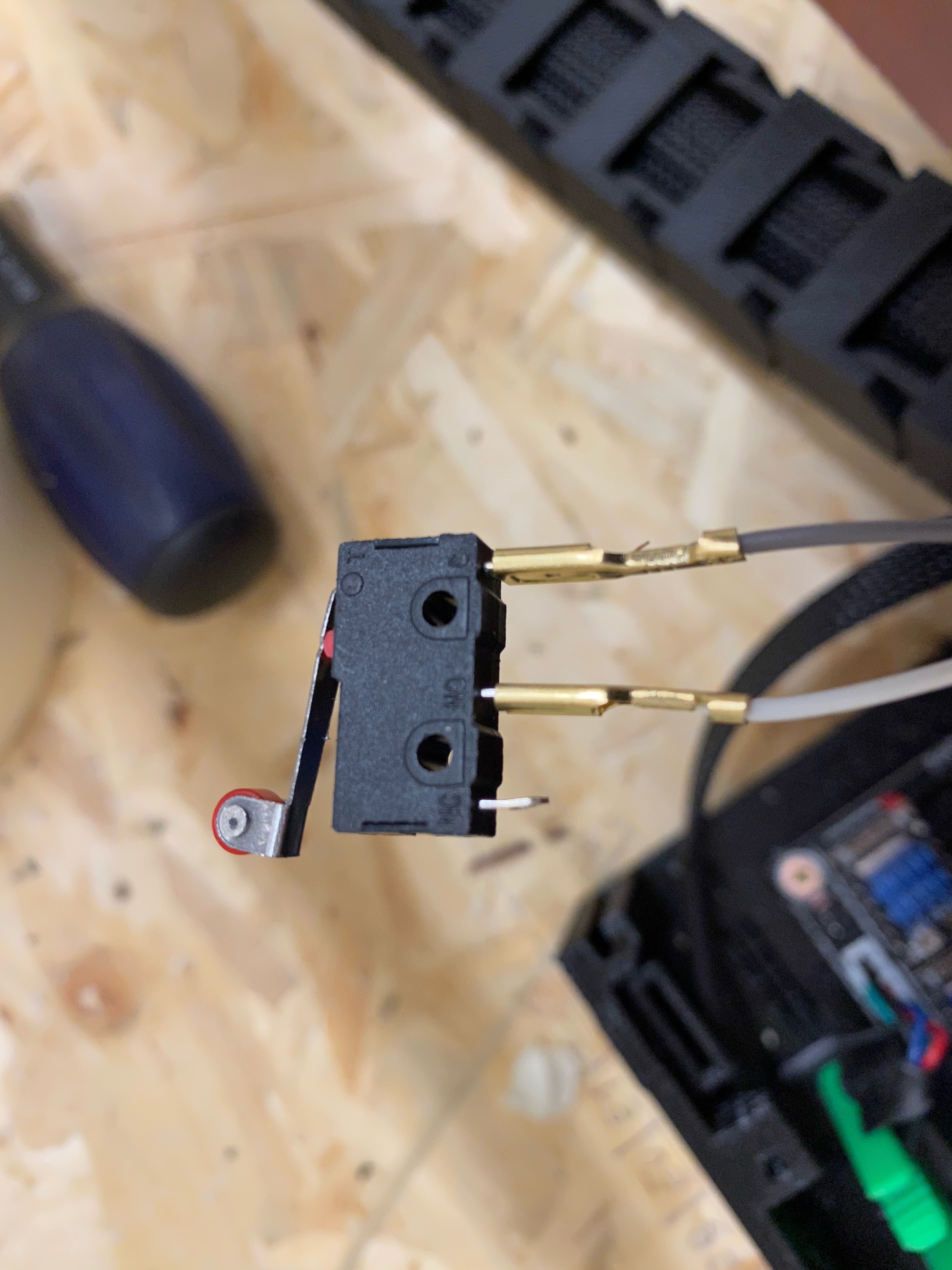

i bought the bare connectors … but i don’t get any response from the board. what am I doing wrong?
How are you checking for response?
in repeiterhost I send the manual control and then I press the switch …
They don’t work that way. They don’t stop the machine, unless you are homing.
  1. Use M119 to see the state of the switch.
  2. It looks like you have it connected to NO, so I would expect it to be reversed.
Sending M119 will show the current state of endstop switches.
