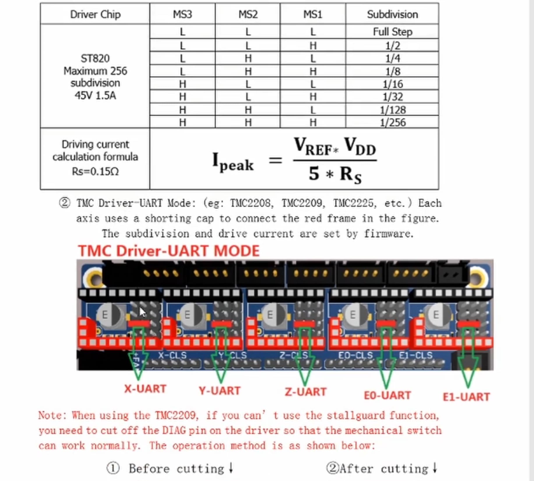

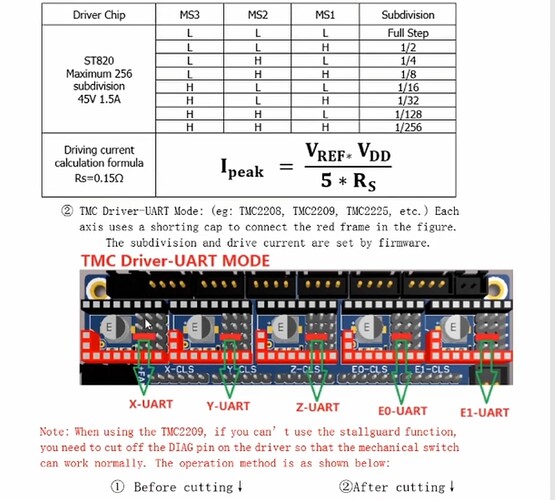

The 1.2 pro has the bent pon, is that done on the 1.4 as well? Also check that the jimpers under the 2209s sre set correctly.
Thank you for your help. Right now I connected it directly to a pc and started using with repetier-host (it works), and purchased a the SKR 1.2 pro through amazon. it will take a month but since I’m such a noob following the most travelled path is the best way. Thank you for your kind reply!. (oh and the problem with the z axis was solved with lubrication, who would have thought XD )
Thank you! I did powered the board with a 24V 3a power supply. and placed the jumper that tells the board to be powered by the Power supply not through USB (though I can still use the USB to send stuff). I think it’s the firmware. tried to compile a new one but it was over my head. I purchased a new board a SKR 1.2 pro. Thank you for taking the time to reply :smiley: !
yes that pon has to be bent as well, and I placed the jumpers that go bellow each 2209 so that they use UART, it’s the third pair down from the top. (saw it on a video detailing the process on youtube)
