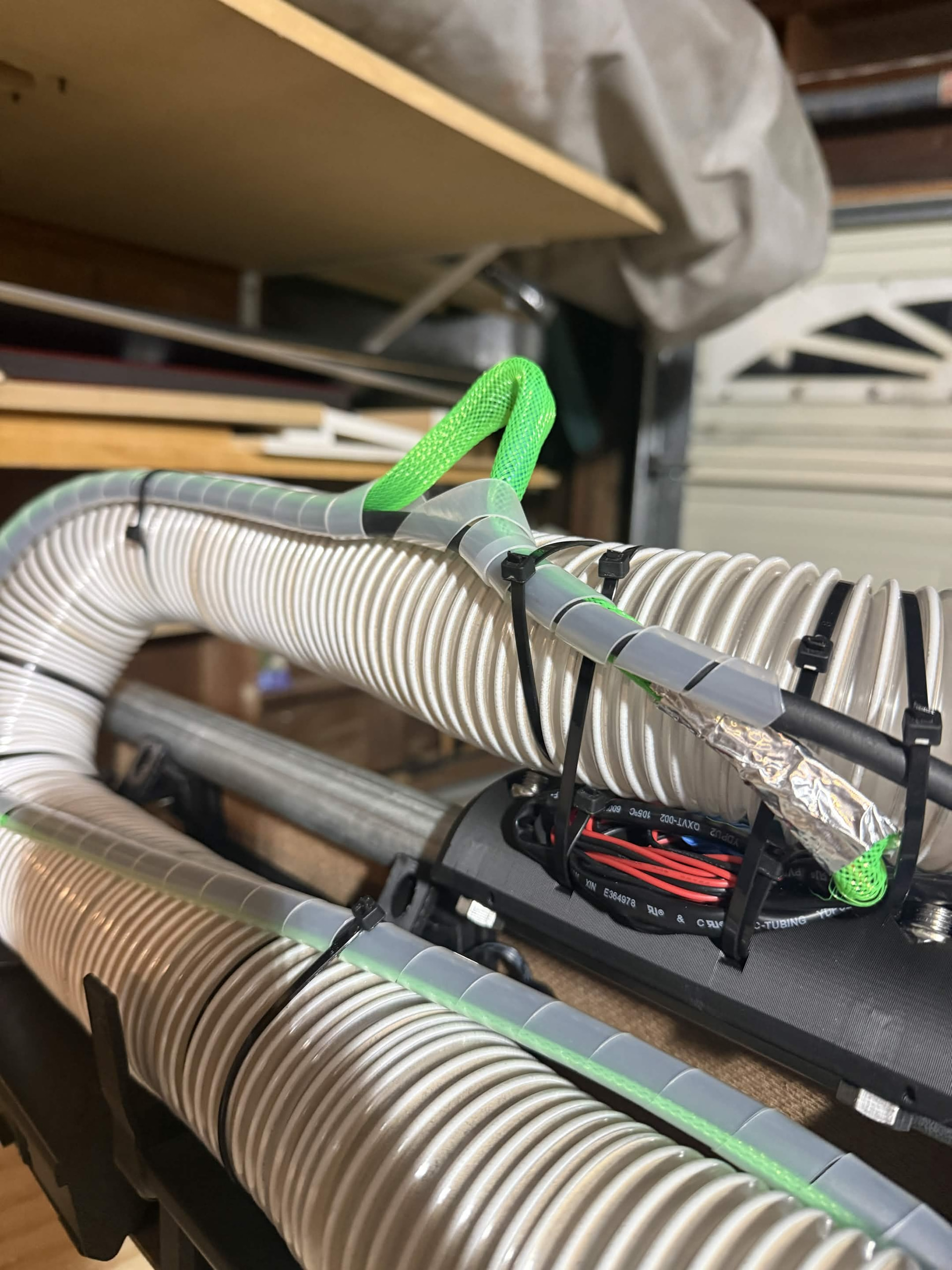

I’ve seen this happen with an intermittent X axis stepper wire. If you have an extension cable for your stepper, double check that you’ve got a good S-bend in it and taped like in the build instructions.
Without even checking the cable my gut is thinking this is it. I had some issues with the extensions not laying properly in the cable bundling that I did. It would make sense that it would occur in a similar position every time as well if that was the point where the cable became loose. I did tape the cables together when I attached the extension but this certainly looks like it could be the issue doesn’t it? That part sticking out is the taped junction
Homing sets the machine position, but what happens next depends on what coordinate systems you are using. I’m not the right expert to give a dissertation on that. If your error is intermittent then it isn’t a coordinate system error, though.
OK, that makes it a bit stronger candidate for where the issue is in my mind as well.

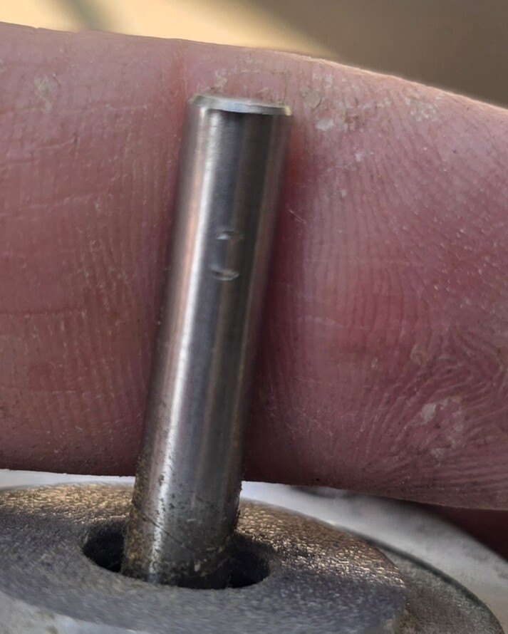

If the belt always lines up with that mark, then skipping teeth isnt the issue. It might be worth the time to back the grub screws out and pull the toothed pulley off looking for whitness marks of where it is slipping or moving. Assuming you find nothing, I would also check for snag points in the cabling. I had an issue last night where I gave my machine the “park for the night" macro I made and it just happened to move in the exact way to show me I had a snag. It never made it all the way to the commmanded location and I know exactly where I need to fix my cable routing.

whie the belt is still off, take the toothed pulley off the motor shaft and see if there are any marks that it hasnt been sitting perfectly still and aligned with the shaft. In the picture below you can see where the grub screw was, but it never moved. thats the kind of whitness mark I am talking about.
